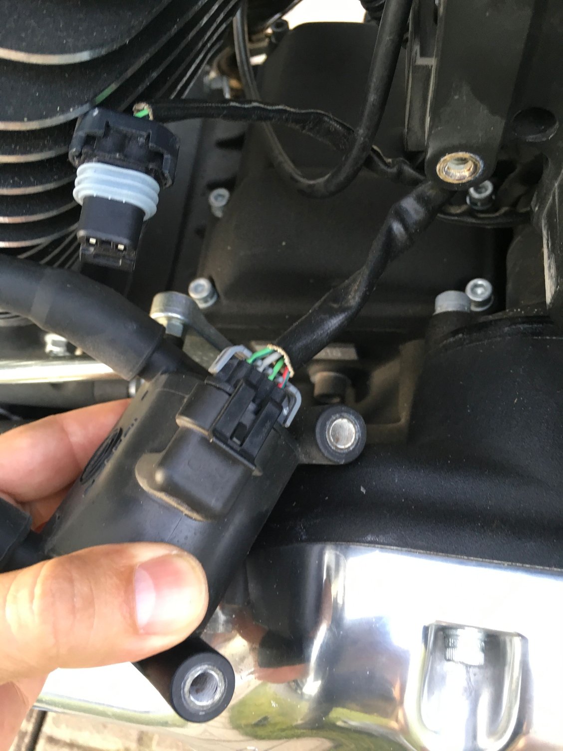

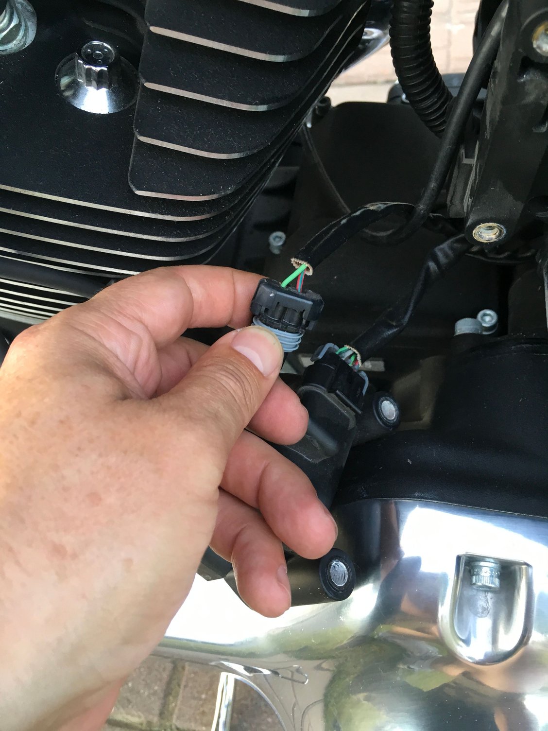

There is a spare plug in the nacelle behind the headlight that might be what you are looking for. I used it for my auxiliary passing lights.

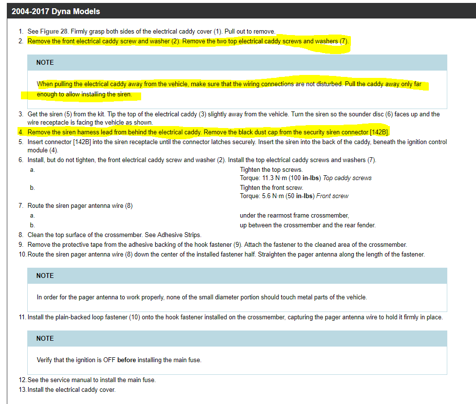

yes, there are more wires back there. i think it was plugged into a dummy cap. easier if you pull the basket/carrier out a little
see here under 2004-2017 dyna:
https://serviceinfo.harley-davidson....1?locale=en_US

Just looked behind the headlamp, just a single wire type connector, not it. Looking for a 3 wire connector. I stripped all connectors out from under the seat and left side. Is it possible that I need to install this connector?

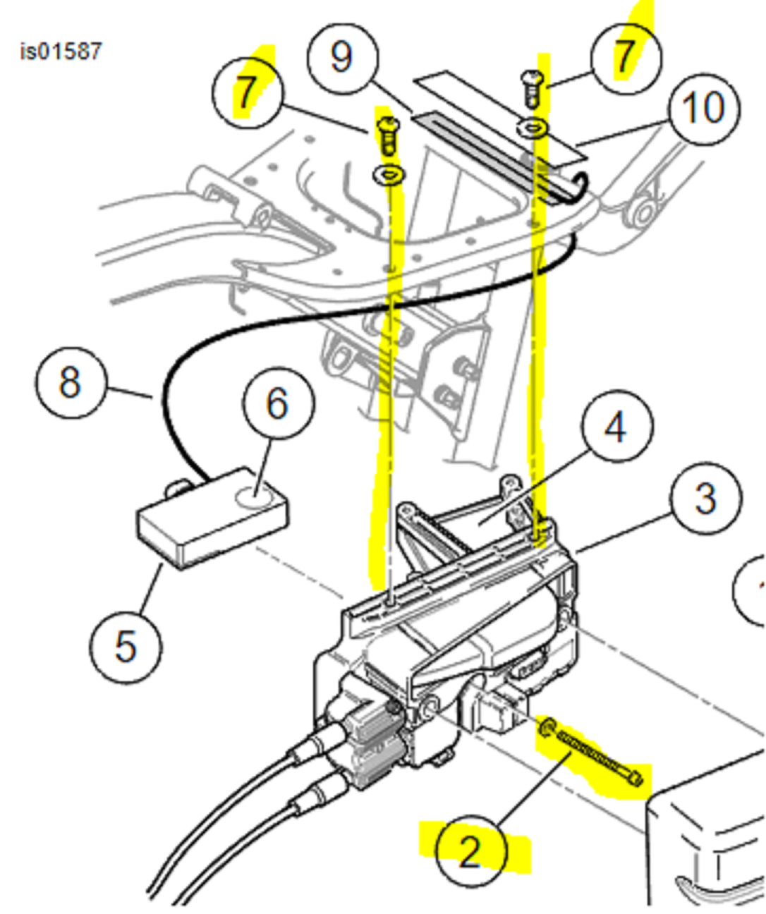

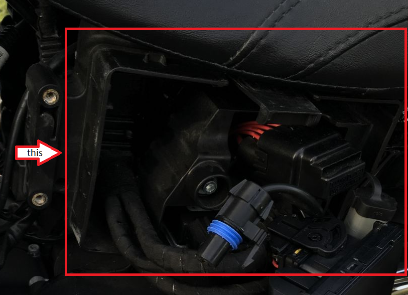

relax and take your time. follow the directions. the wire may be plugged into a dummy connection on the rear of the caddy. remove the caddy if you need to. there is, i think, a 10mm fastener holding it on. i'll get pictures in a minute.
for reference, the highlighter connection labeled "P&A/Diagnostic" shares the same branch as the siren connection. the P&A cable is in plain sight in your electronics caddy. it's the grey connector with the rubber stopper in it.
relax.. it's there

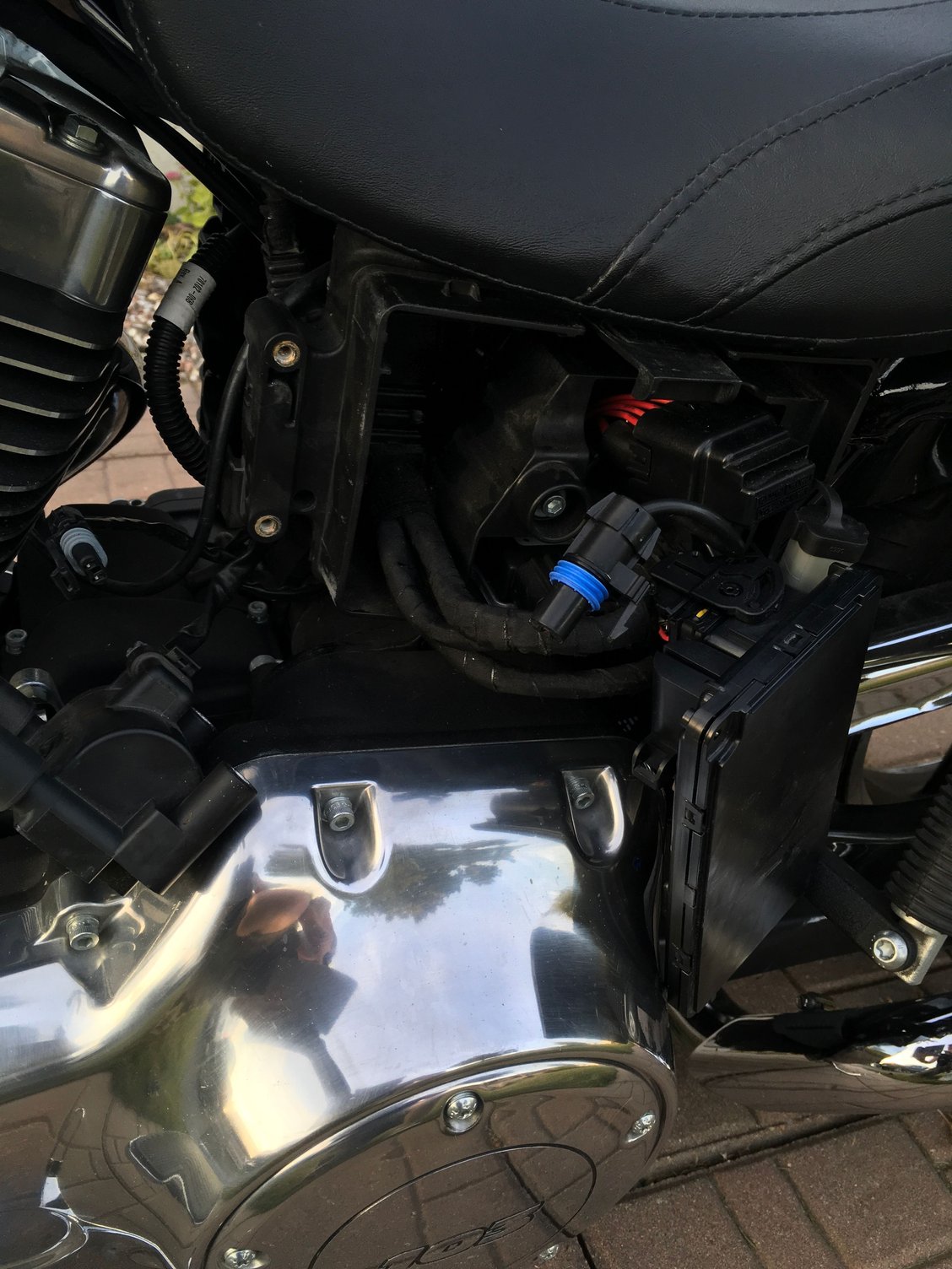

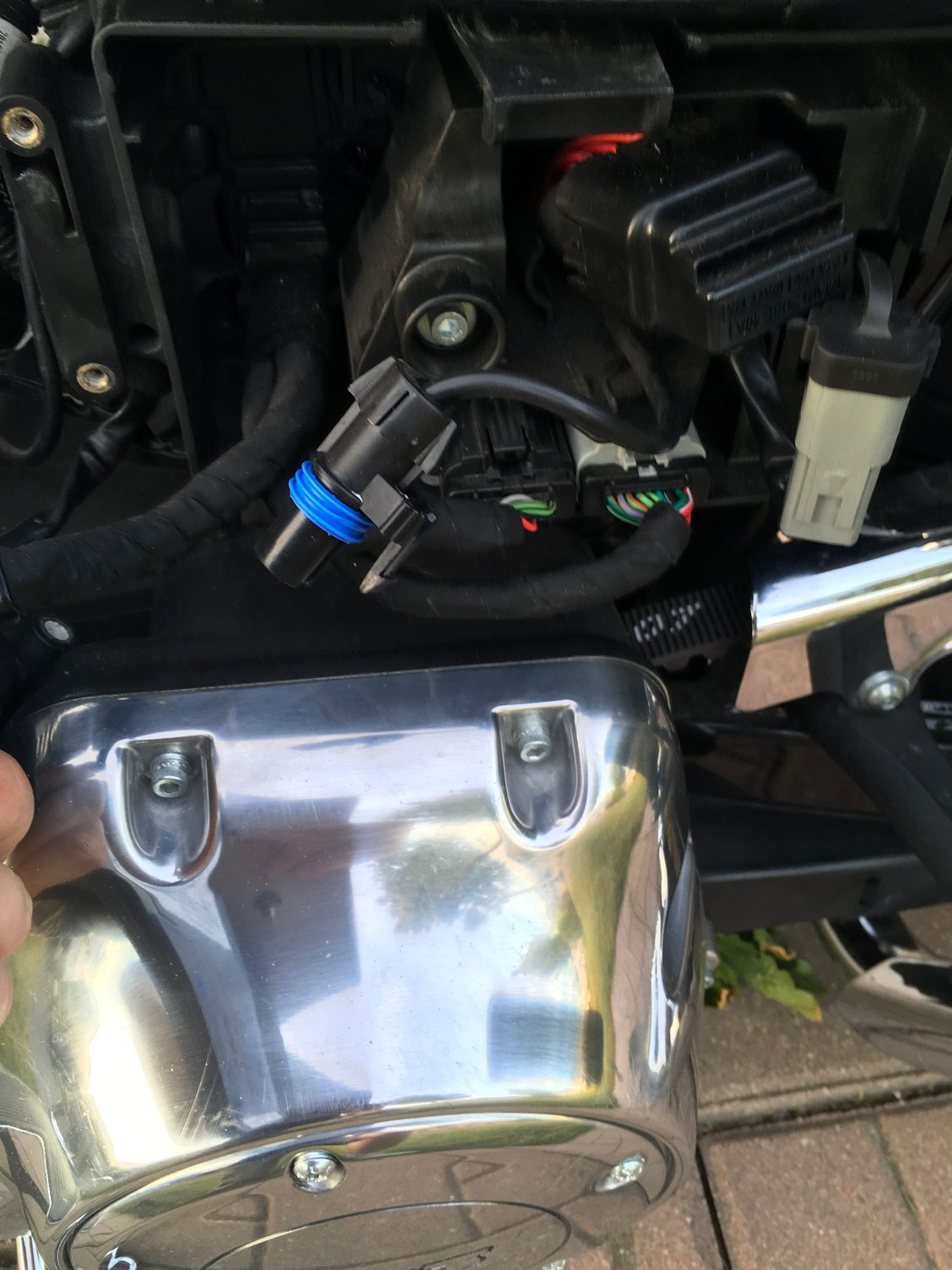

whats behind and running throught the left side electronics caddy:
caddy removal- remove highlighted screws:
underseat screws (7):
caddy screw/ P/A:

remove the caddy. the wire is behind the caddy. the siren also snaps into place behind the caddy. behind the caddy, back there
gotta take off the seat and remove the screws.

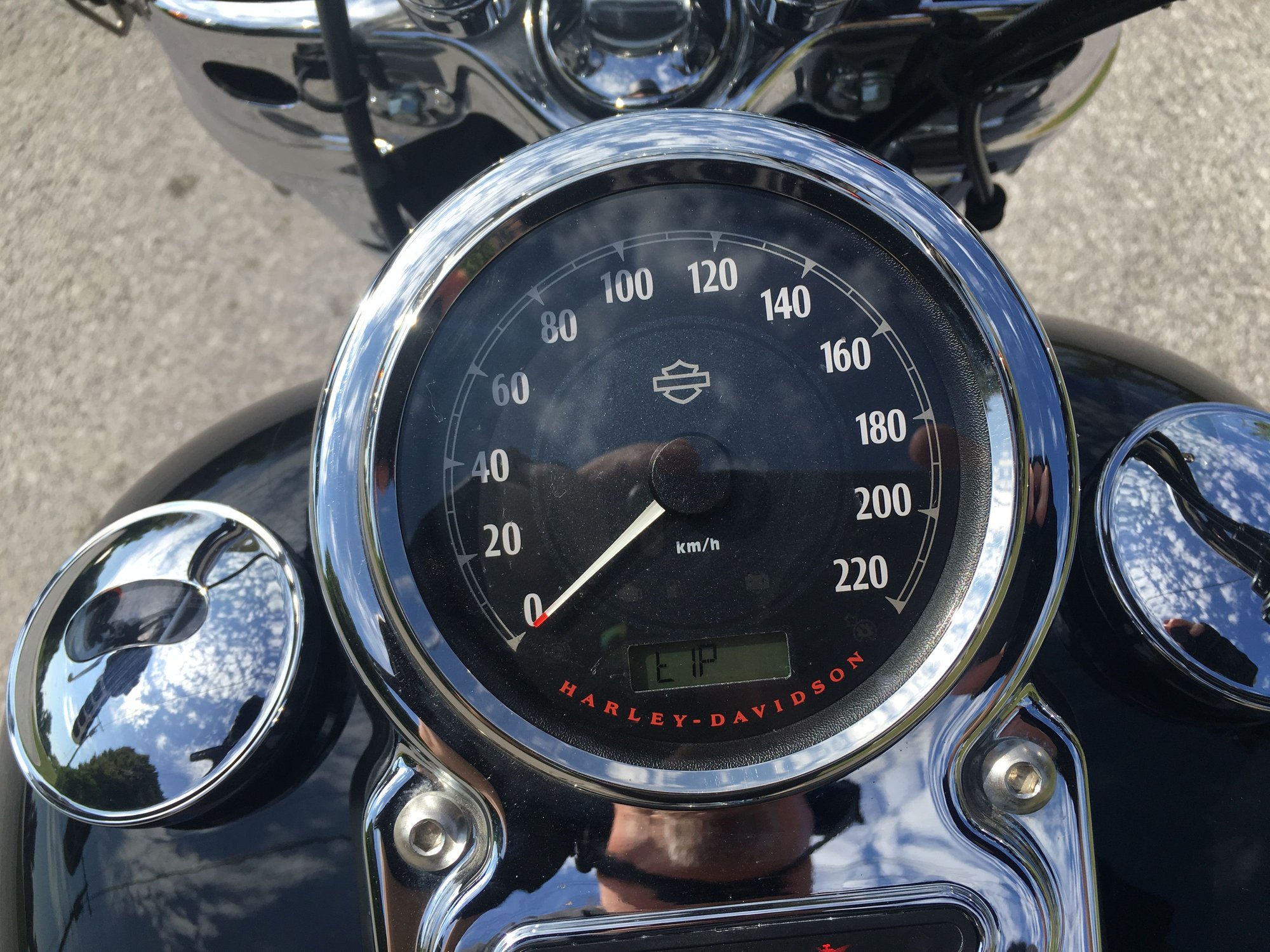

Do you know what this fault is? It happens in first when I'm cracking it.
Old Sep 26, 2017 | 07:45 PM
cvaria's Avatar
cvaria
Posts: 12,367
Likes: 2,215
From: Tallahassee, Florida
Originally Posted by JimPrice
I will remove the seat again and this unit this coming weekend.
Thank you very much for all your help, i will let you know how I make out next week,
tip= dropped/tipped over
the bike thinks/thought it fell over. probably because you had the BCM hanging down while attached thing hanging in the picture.
that shouldn't happen often. if it does... no bueno
