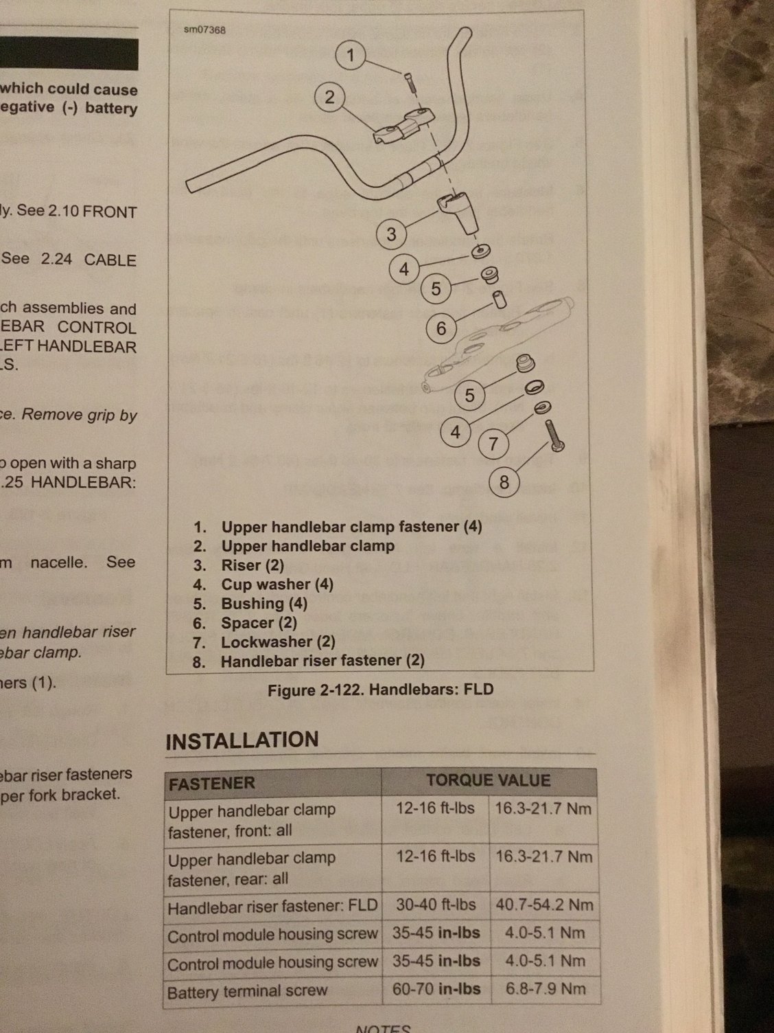

Replaced my 1.5 inch riser to a 3 inch riser, the bolts? Should they be tight? Yes a stupid question but I let a shop do the work and wouldn't you think they would tighten them up?
I have never had to loosen a bolt with so little effort. I now know why my bars would flap effortlessly when hands were off the bars..

Whoa...
40 ft-lbs on those riser bolts
Glad you're still here to tell the tale; disconnect yourself from those bars and all sorts of bad can happen...

Didn't re read my post.. I ment the bolts that are under the top tree.. Sorry..
But those are 40lbs too?

Man..., you're better than this - where's the damn service manual
iirc - 40 sounds about right.., maybe a touch high *thinkin ~ 35* ) - I can check the manual tomorrow if you like

Default Page 142 in my 2008 manual.
If you mean the 1/2” bolts going up through the bottom of your top triple tree (through the riser bushings) they are not what tejasjeff are showing. If they are #8 then 30-40 ftlbs
What tejasjeff posted are the clamp values.
Due to my not so good tech skills the image didn’t come through correctly..page 142 item 8. Above the all models section says “Tighten riser fasteners to 30-40 ft-lbs (40.7-54.2 Nm).”
So I’m good and so will the OPs after he redoes the HD techs work. ;-)
