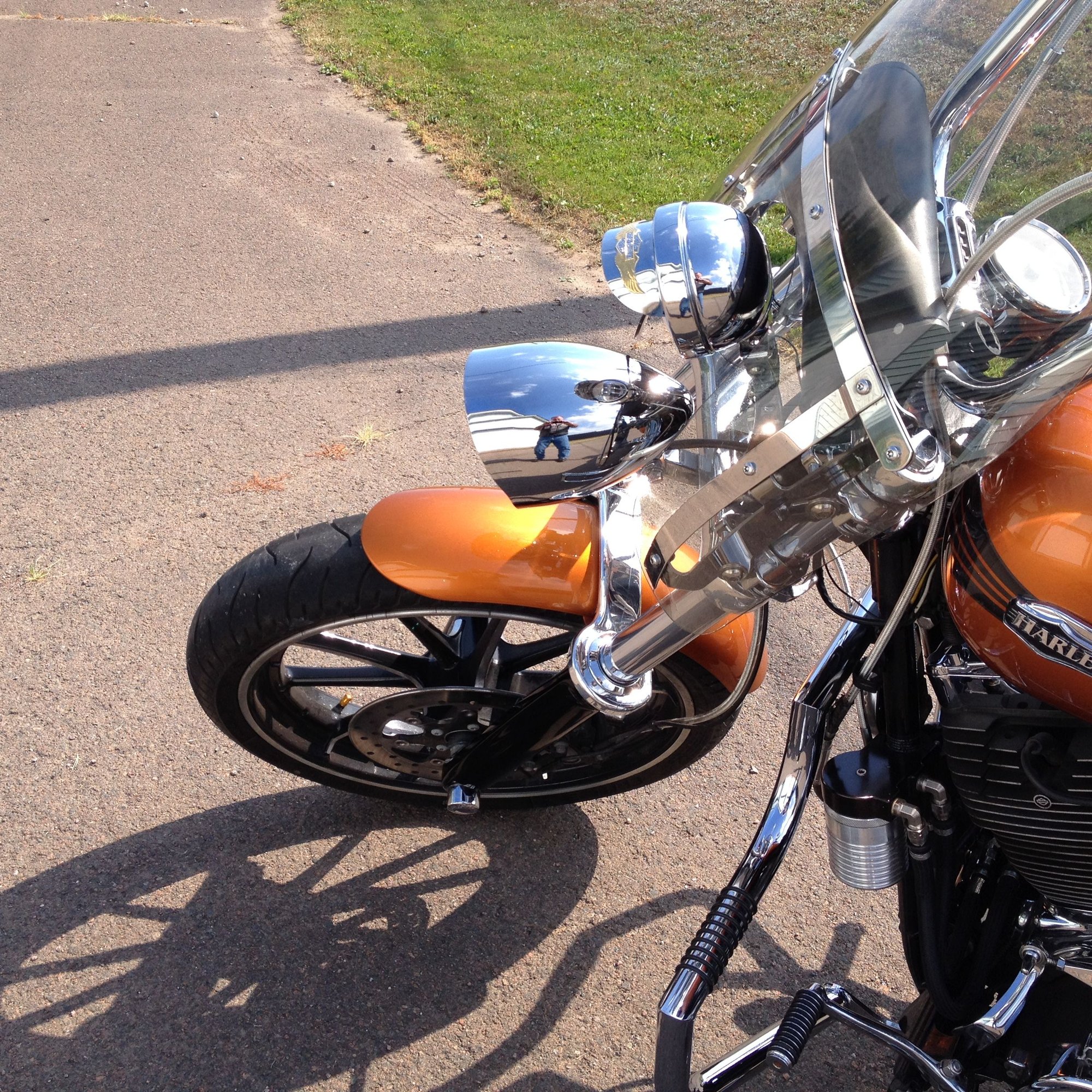

You might consider a permanent high flow filter and a filter relocation kit. You wind up with a passive system, no moving parts and a modest drop in oil temp and pressure. It can look great too.
TinCupChalice has done a remarkable job on this mod. Here is my effort:
It works.
It works.
I'm not sure how effective that would be on my lrs though. It's a great idea to reduce oil temps, and I appreciate the suggestion, but mine only overheats when I'm not moving. It's bad in the summer though, even hitting 2 or 3 red lights in a row will cause it to overheat. First thing I need to do is vent my ac and get it dyno tuned. I'd also like to add a jagg fan assisted oil cooler and see how far that reduces my temps. If that don't do it I'll have to get the god awful cooling fans.

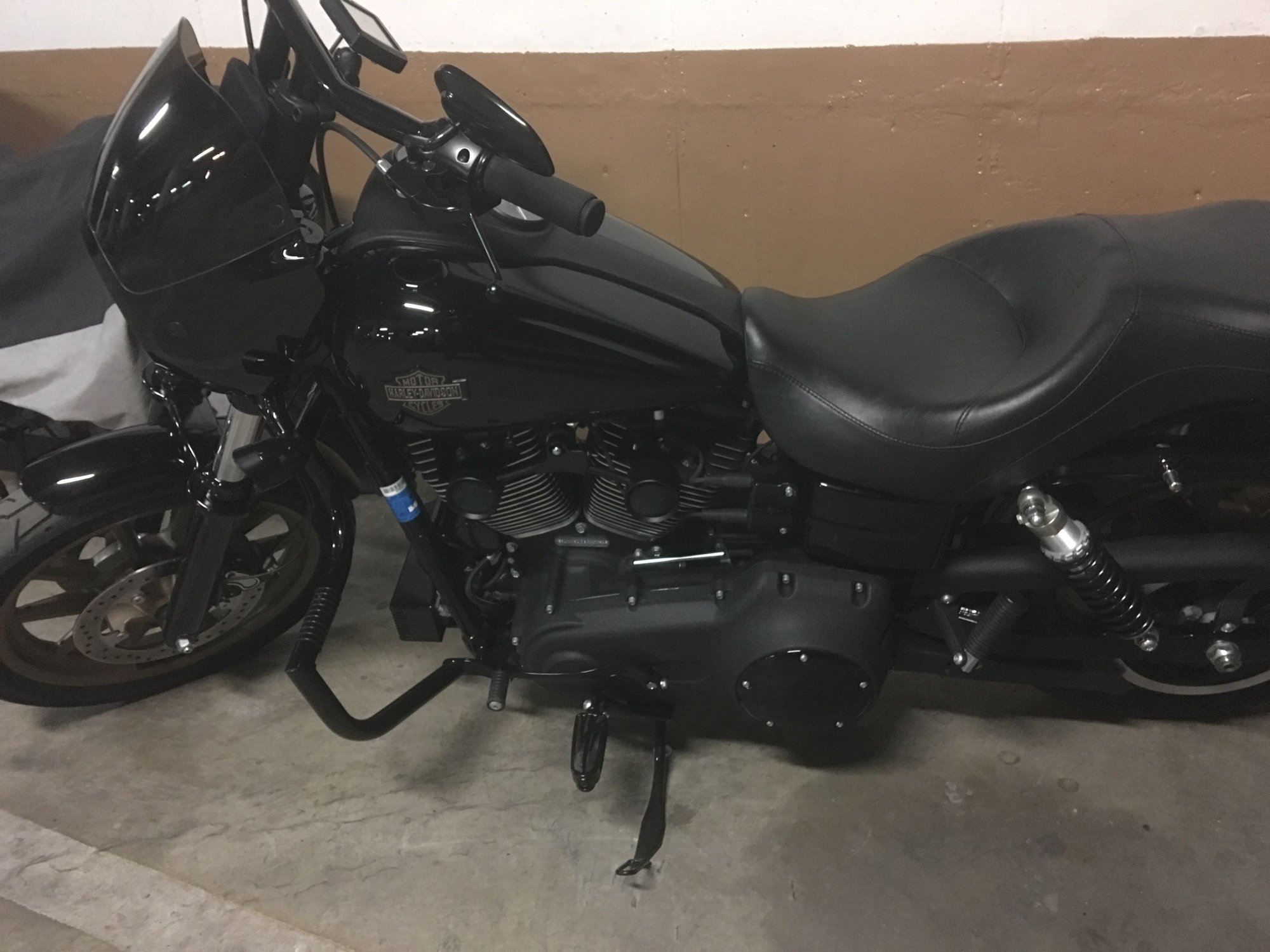

is is there any chance you could post a pic or two of your cooling fans? Sorry to hijack, but how hard is it to clean the engine? Are the fans easy to remove for cleaning? And did they bolt on directly, or do you have to buy a mount?
Old Dec 4, 2017 | 04:04 PM
Mchad's Avatar
Mchad
Joined: Dec 2014
Posts: 10,734
Likes: 3,755
From: SWFL
TBH, I don't have many. Here's and old one.
I don't find them too offensive. I definitely don't remove them, but I am not so "fastidious" in my cleaning routine. I spray the fins with soap and hose them off. That's about it.
For models with horns in the usual position, they use the existing mount. For the LRS, I had to buy the Street Bob top mount/horn bracket to install it. Easy enough to do. That and the HD accessory power adapter and done. The Love Jugs Mighty Mites come with a larger bushing for the horn mount. I'm using the standard HD bushing on my Wards on the LRS.
