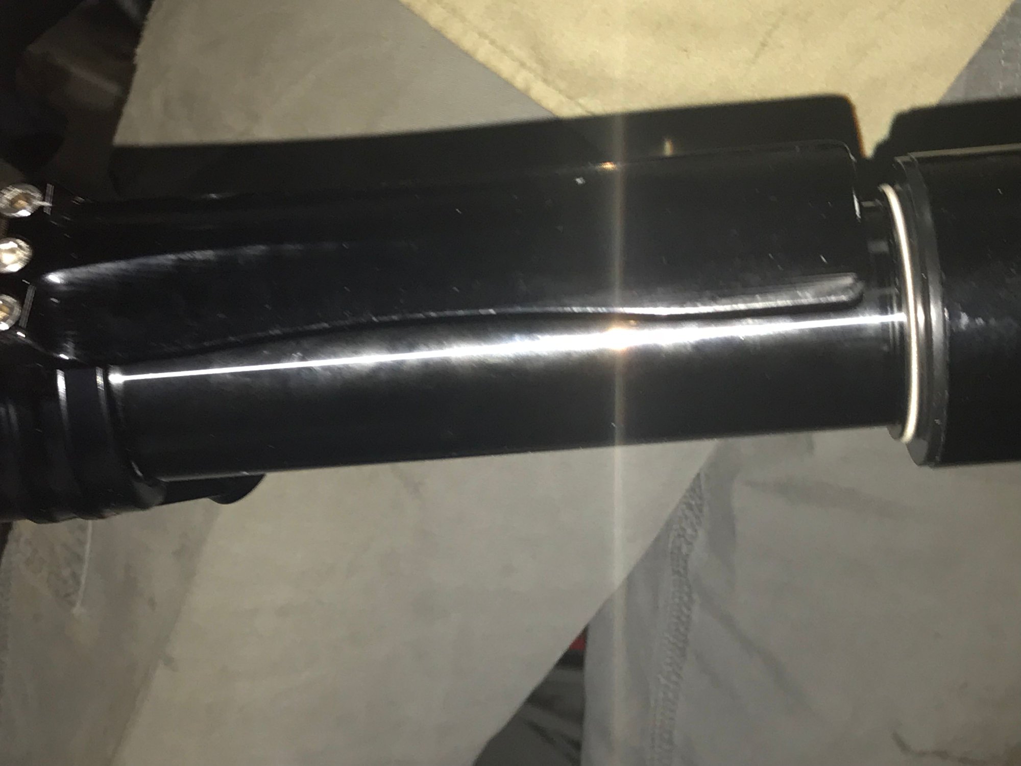

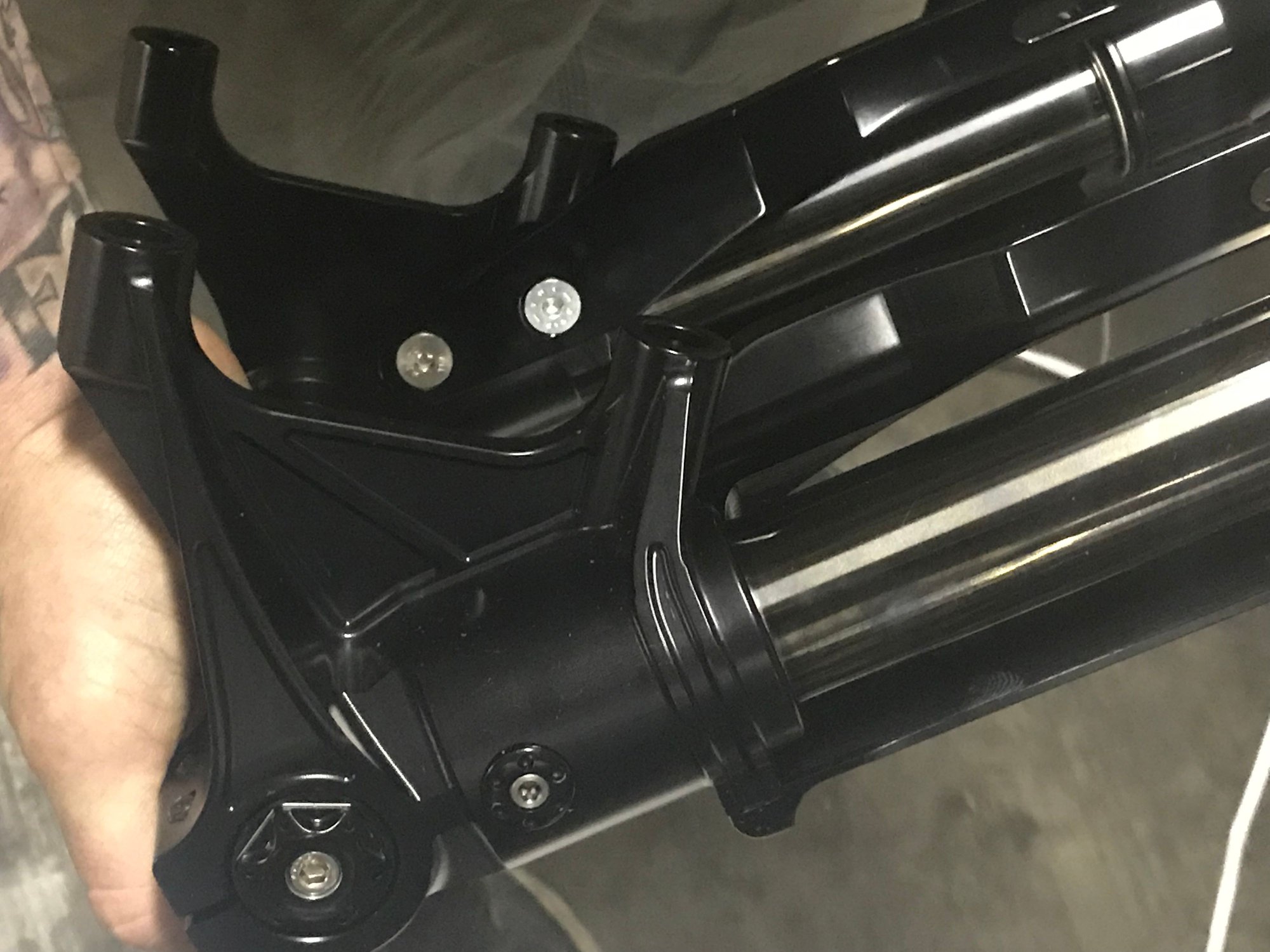

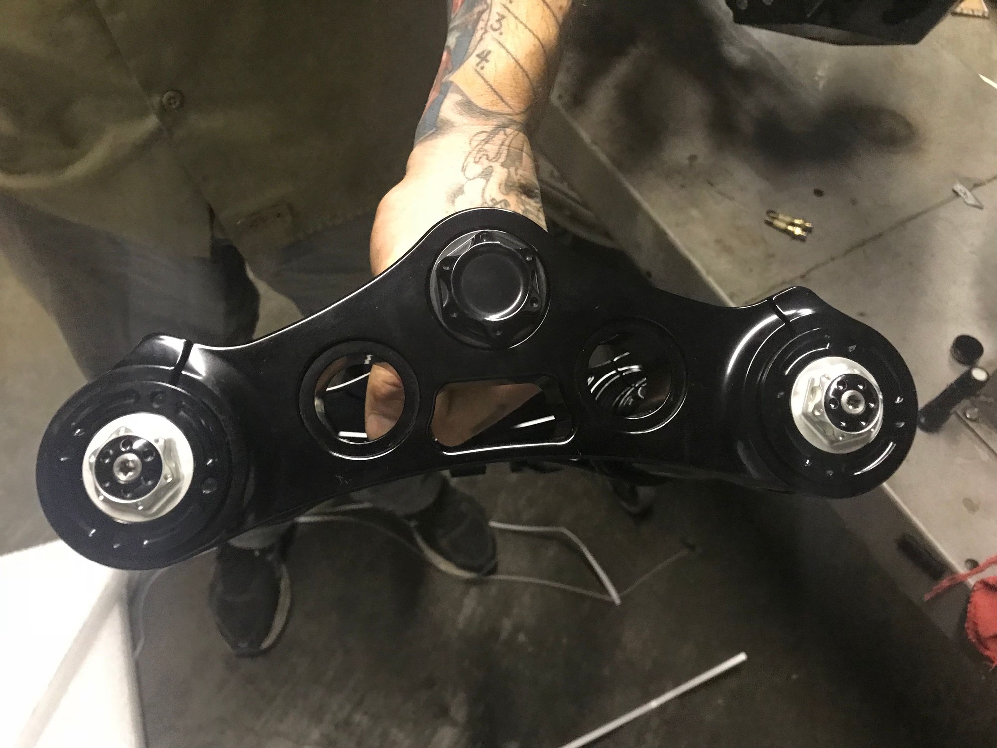

i saw your bro was making his own rotors.
@xmas gift. i'm already working on the swap. i got the setup yesterday. i was pissed but, Will took care of me. i love that guy. no idea how something got from italy to me in two days... mind blown.
https://www.hdforums.com/forum/sport...orking-95.html

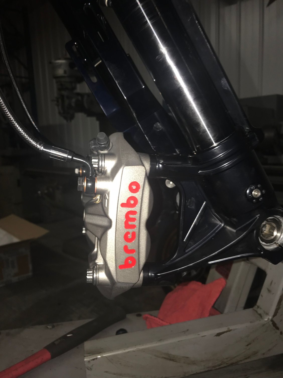

had to go axial because of the wheels but, i'm probably going to go street merchant for 13" radial brembro mounts the space the remainder for my 15" rotors. i'm pretty sure the hd touring brembros will not look all that great on the monza but, that's where i am right now.

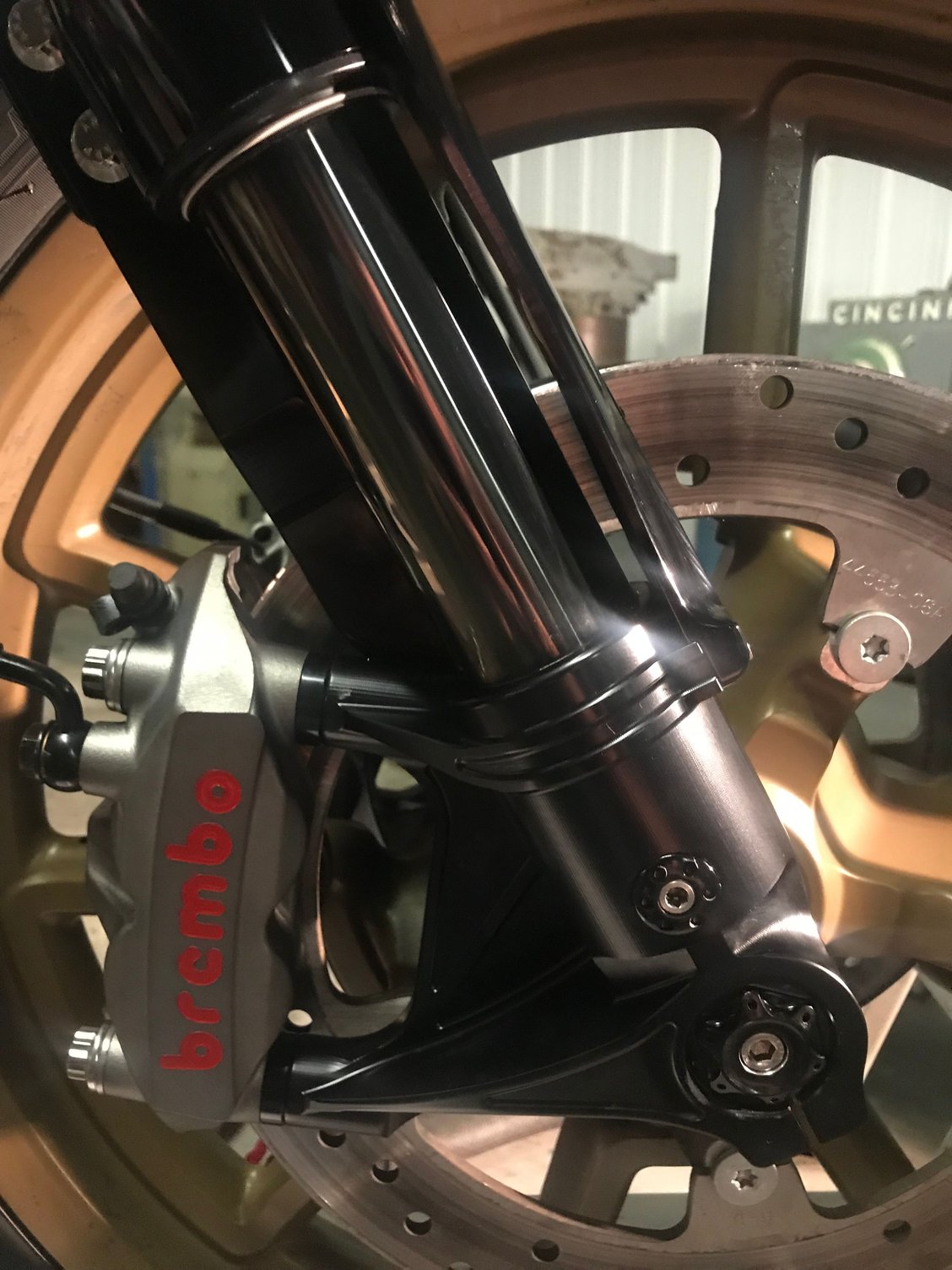

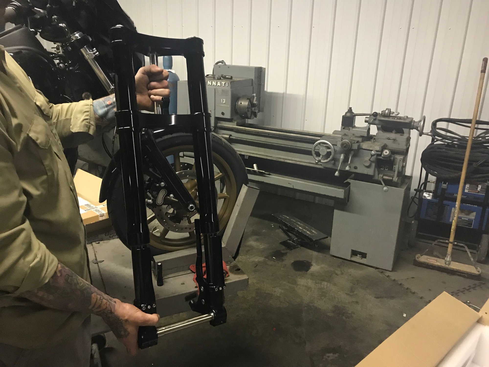

I'm dying to try one of the inverted front ends on a HD.
Curious to see how it handles the extra weight. It's hard to draw a comparison with sport bikes that weigh half of what a HD does.
Nice set-up you have there.

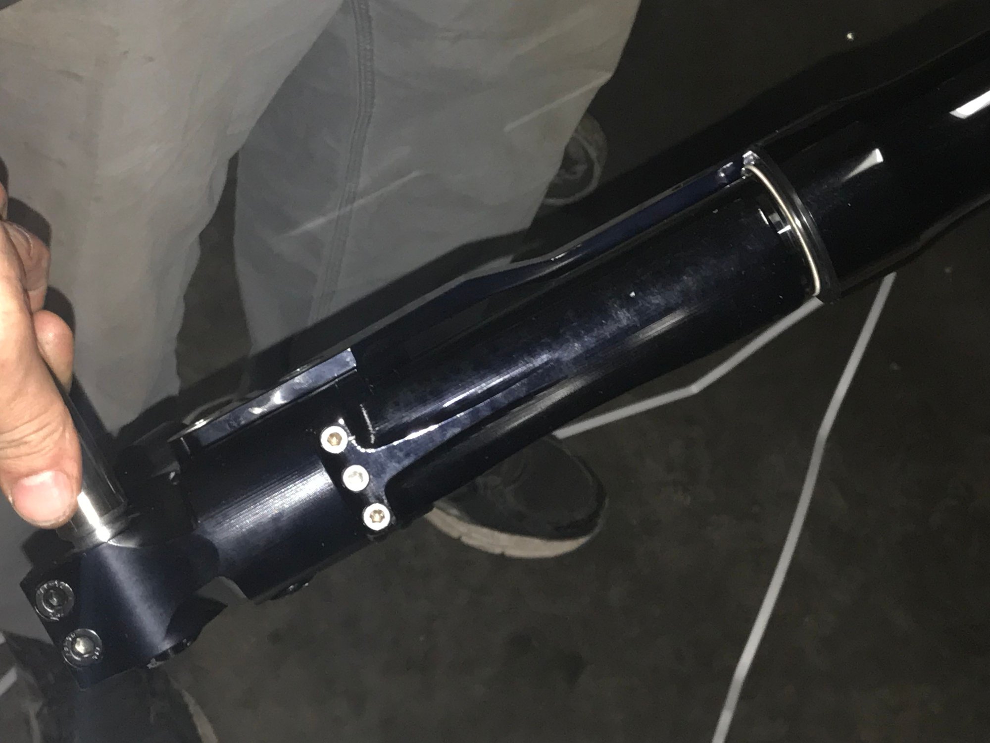

Thank you! The ODC parts were designed from the ground up for the weight of HDs as opposed to other manufacturers who have adapted sport bike parts for HD use. Valving is right, springs are the correct rate, shock shafts are thicker etc.

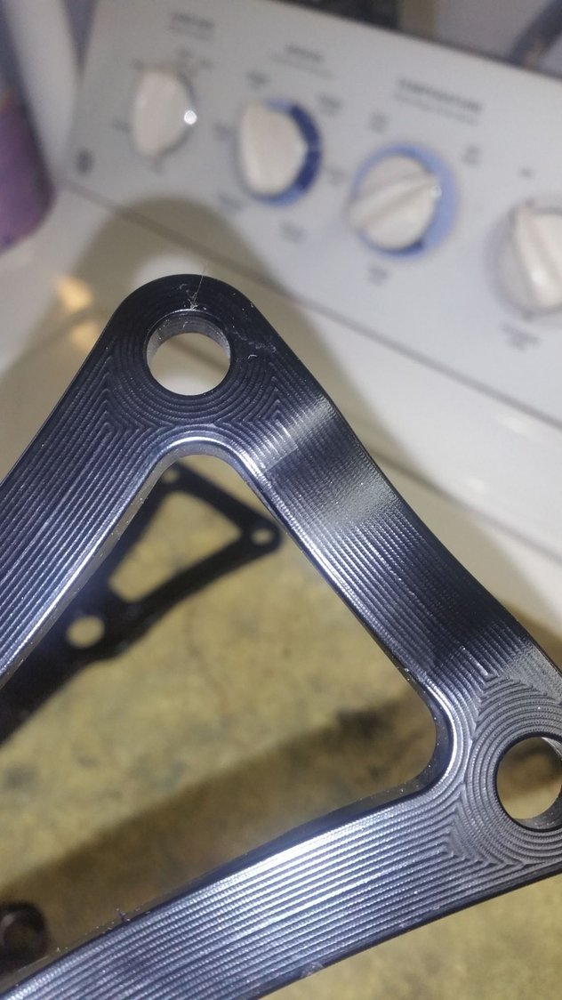

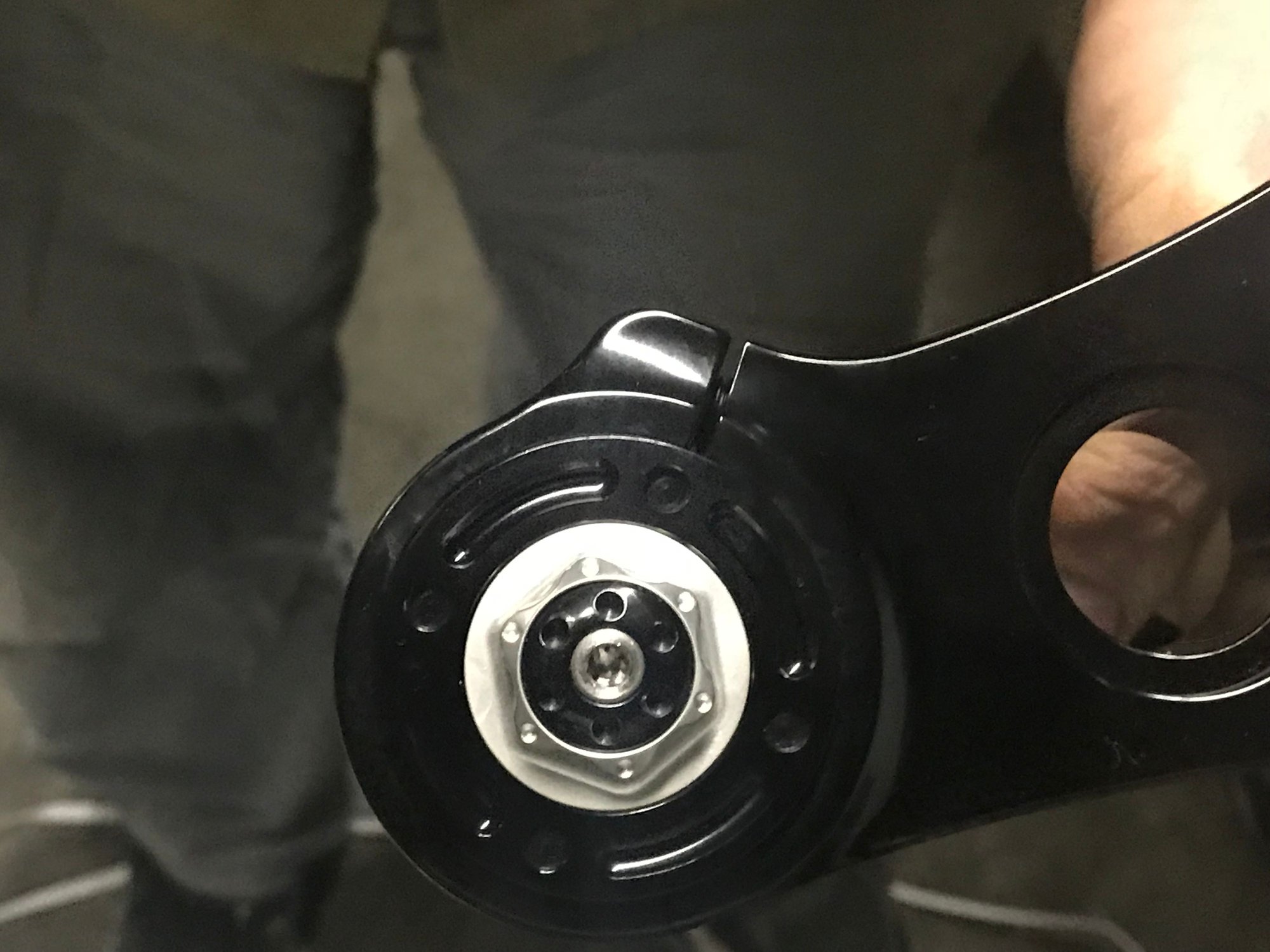

quality and detail is ridiculous... the parts are needlessly detailed in the most awesome way.... for no reason. you really can't see it in the pictures that are all over the web but, it's clear as day when you actually see them up close.

Not questioning the quality...the finishing may even be intentional, but we would consider that roughed in where I worked. Just CNC profiling with a ball end mill. A profiled part with a smooth finish takes a lot more time and money. Curious to hear Blue Bob's take.

I think that was intentional on the finish. Some parts are glass smooth and others are more like the finish on the bracket cvaria posted.
