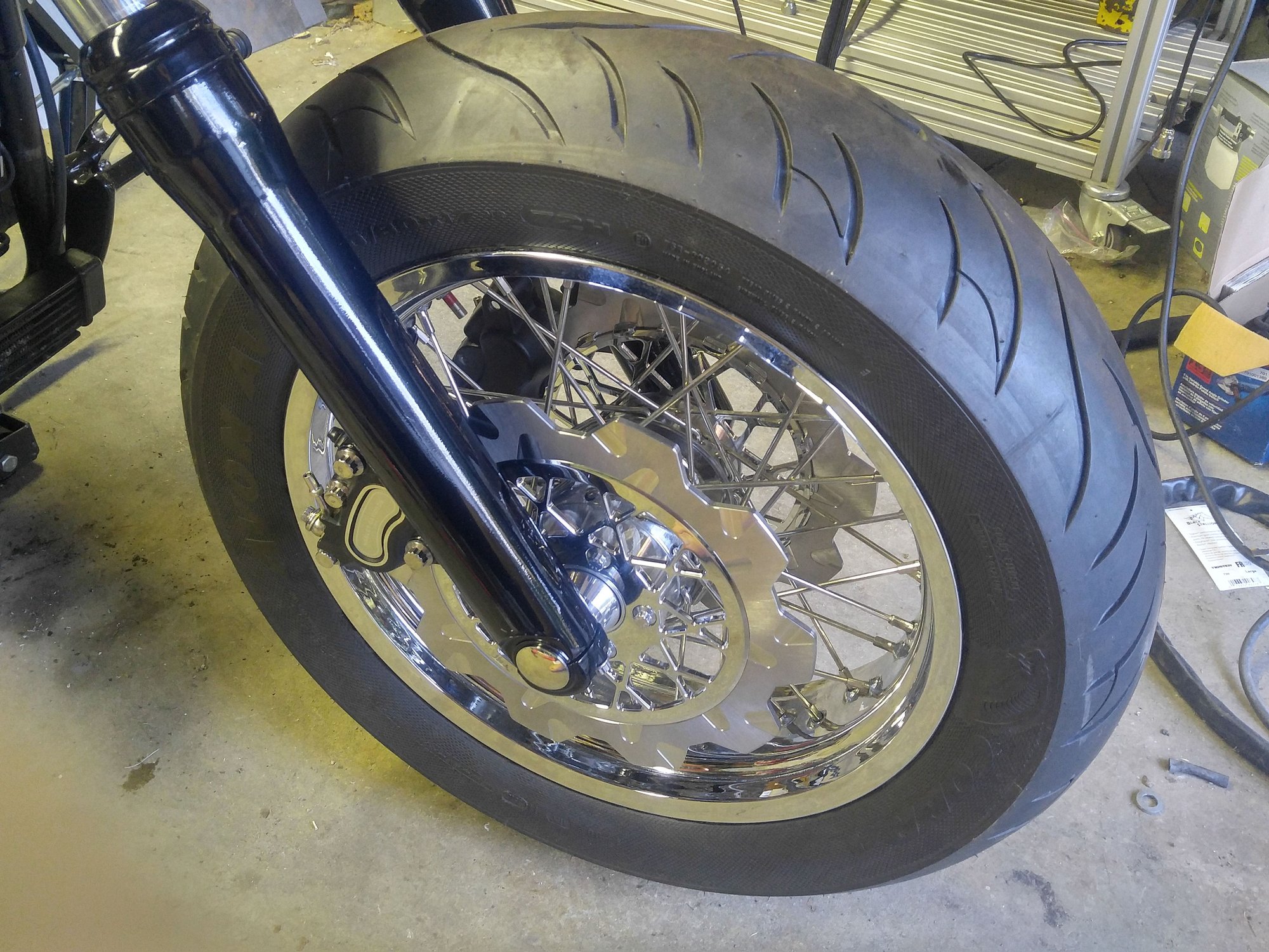

That's what I did, but I wanted a non-stock width, aluminum rim, and stainless spokes, so original was never an option anyway.
Roundabout a $500 wheel, but I feel it was worth it.

My front rim is 4.5 or 4.75 with a 150/80-17 and neatly clears (no excessive space) the sliders with wide glide trees. A 160 would fit...170+ would be a squeeze.
Regardless, I was unable to locate a modern front tire wider than 150.
The mid glide is 1" narrower, so I think a 150 would be a real squeeze.
Kinda moot anyway since the OP never (afaik) stated a width goal.
