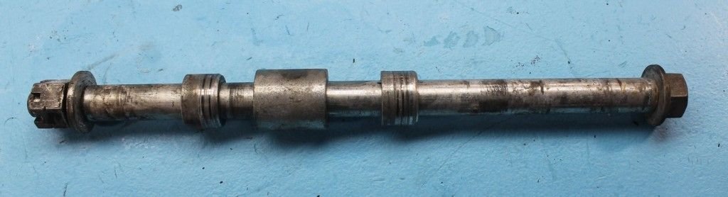

Old Mar 10, 2018 | 12:42 PM
Smite's Avatar
Smite
Joined: Aug 2017
Posts: 76
Likes: 7
From: CA
This is the spacers that I have. Ribbed and one next to it are same diameter. The other is larger diameter.
I mocked it up: large diameter spaced>long ribbed>wheel>short spacer>washer>caliper>swingarm it looked like i had a gap still.

Old Mar 10, 2018 | 02:05 PM
multihdrdr's Avatar
multihdrdr
Joined: Oct 2011
Posts: 11,175
Likes: 2,483
From: Nor Cal
Lol...Well, your 95 is 23 years old and you're probably not the original owner so who knows how they came up with that collection
Do you have a Stock Original wheel?
What are the lengths on that Middle and Right Spacers? Maybe you just need another "middle" (+ existing "middle" and "Right") and get rid of the others.
Here's the Original set-up (not in the correct order though )
Published lengths on those are .75" and 1.41" (1.417" ?)
Old Mar 10, 2018 | 02:18 PM
98hotrodfatboy's Avatar
98hotrodfatboy
Posts: 21,117
Likes: 7,640
From: Poolville
Pretty sure there should only be 2. Longer one on the left side and shorter one between the bearing and caliper bracket on the right. Once installed check to see if the rear wheel is centered and belt tracks properly...
