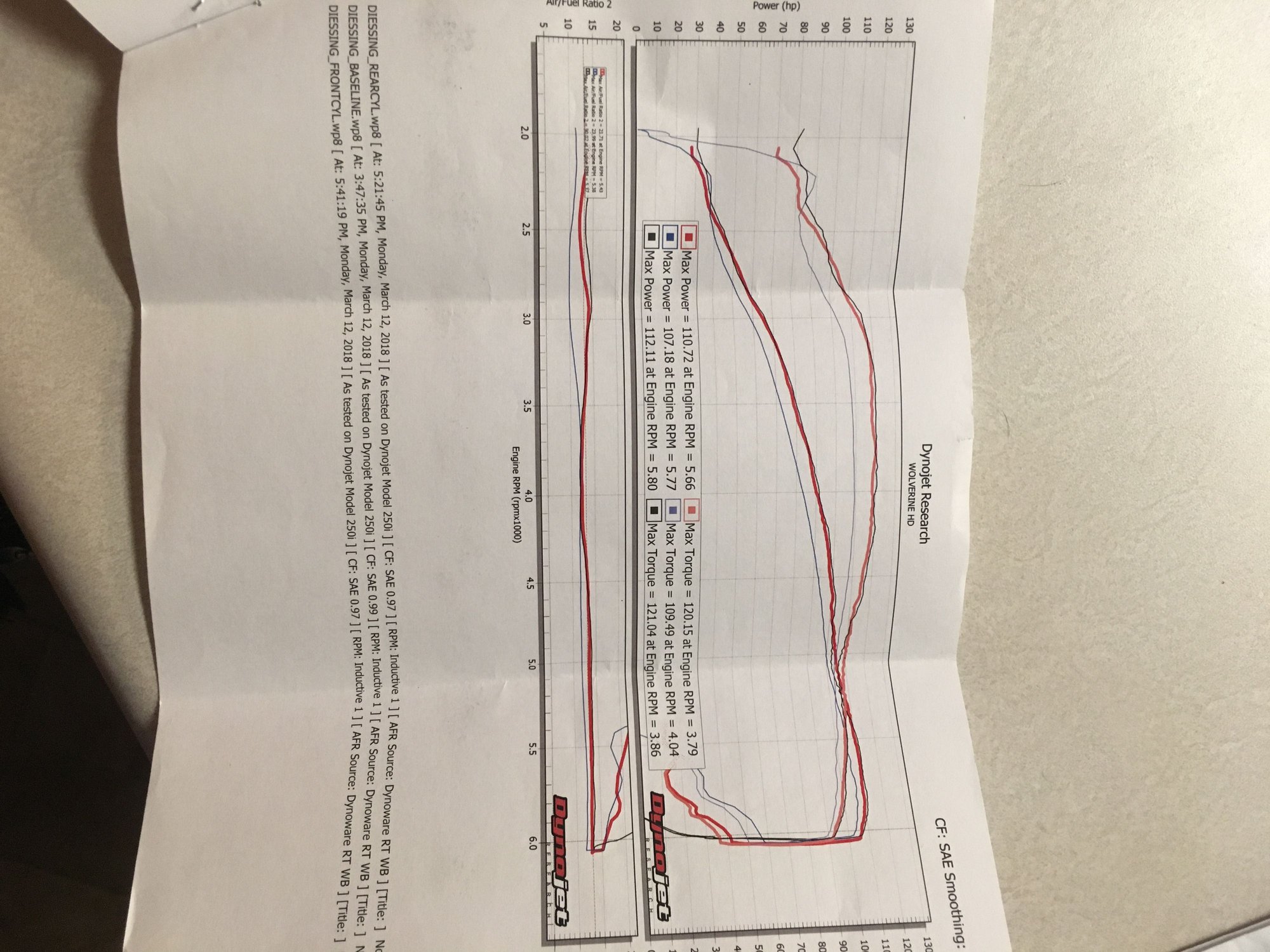

Well I went from 105/120 hp/tq to 112/121. Was definitely hoping for more of an improvement than that. On top of that they didn’t do the flash update to open the acr’s on start up so I don’t really know what to do about that.
If anyone knows how I can adjust my tune to open my acr’s on startup please let me know. Powervision allows you to enable or disable them but it doesn’t actually do anything. I listen and feel for the clicks when I turn the ignition switch to run but they never open so I’m not really sure where to go from here.
how does it run? smoother yes?
WHERE'S THE ******* CHART!!!!!!!!!!!

I'm no pro dyno chart reader, but it looks like she's got more to give.
HP still rising at redline (I think, that downturn beginning around 5800 might be something else) and it seems a bit lean to me.
Hopefully they tuned at multiple throttle positions...

agree with CGMacGuver, probably could have gone to 6500. looks like you now have a smoother ride, no more jerk at take-off. .... that and the pv did a damn good job to begin with judging from the baseline run.
now you gt to post this in the dyno room and have some jack*ss tell you you should have installed baby dolphin and got headwork by someother jack*ss, lol
https://www.hdforums.com/forum/dyno-charts-191/
dealers tend to suck at dynos. i'm not 100% in love with mine but, i opted to not ride for hours and kill myself over it.
