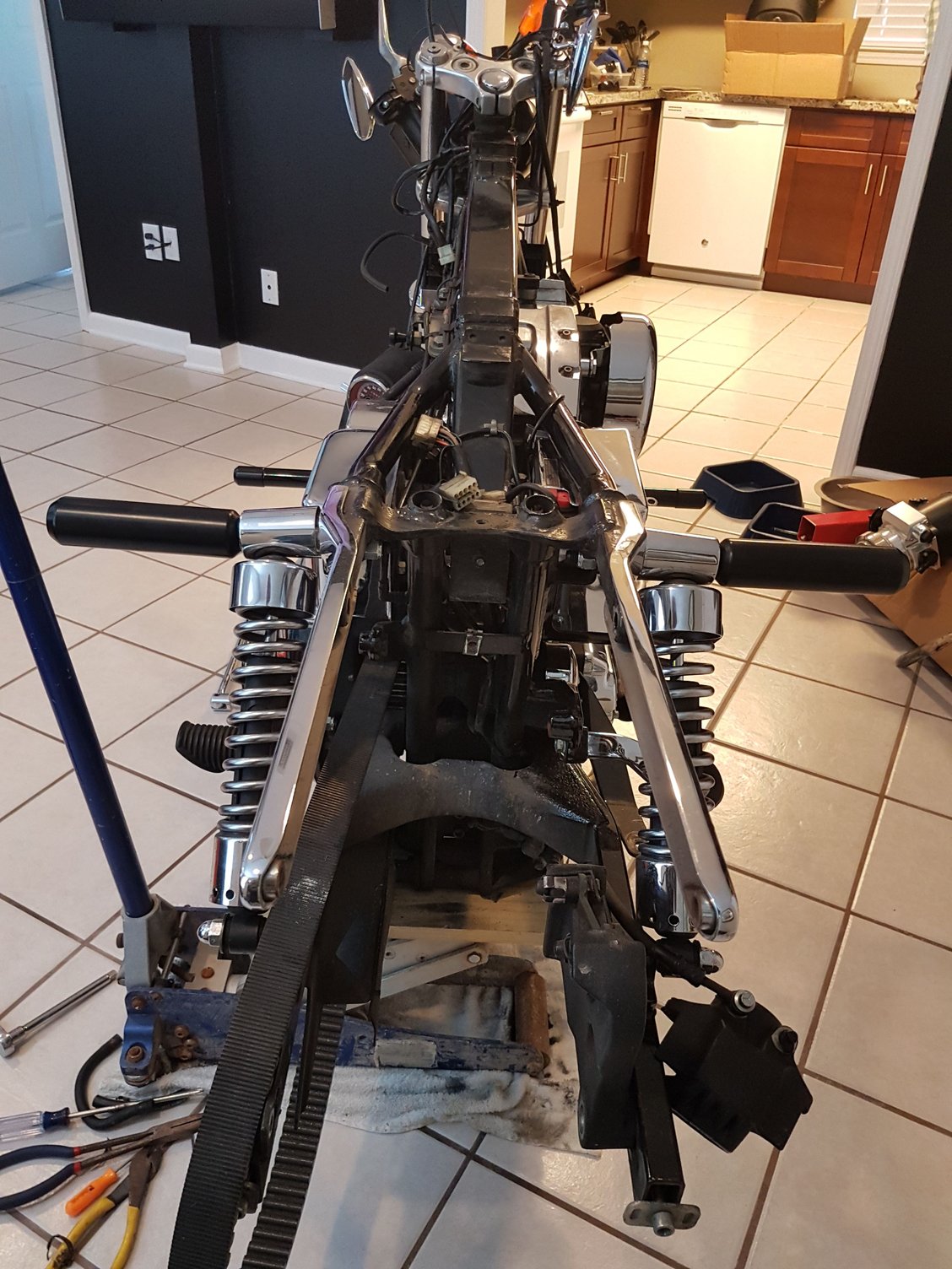

Ill do this on my break. Shouldnt take more than an hour huh?

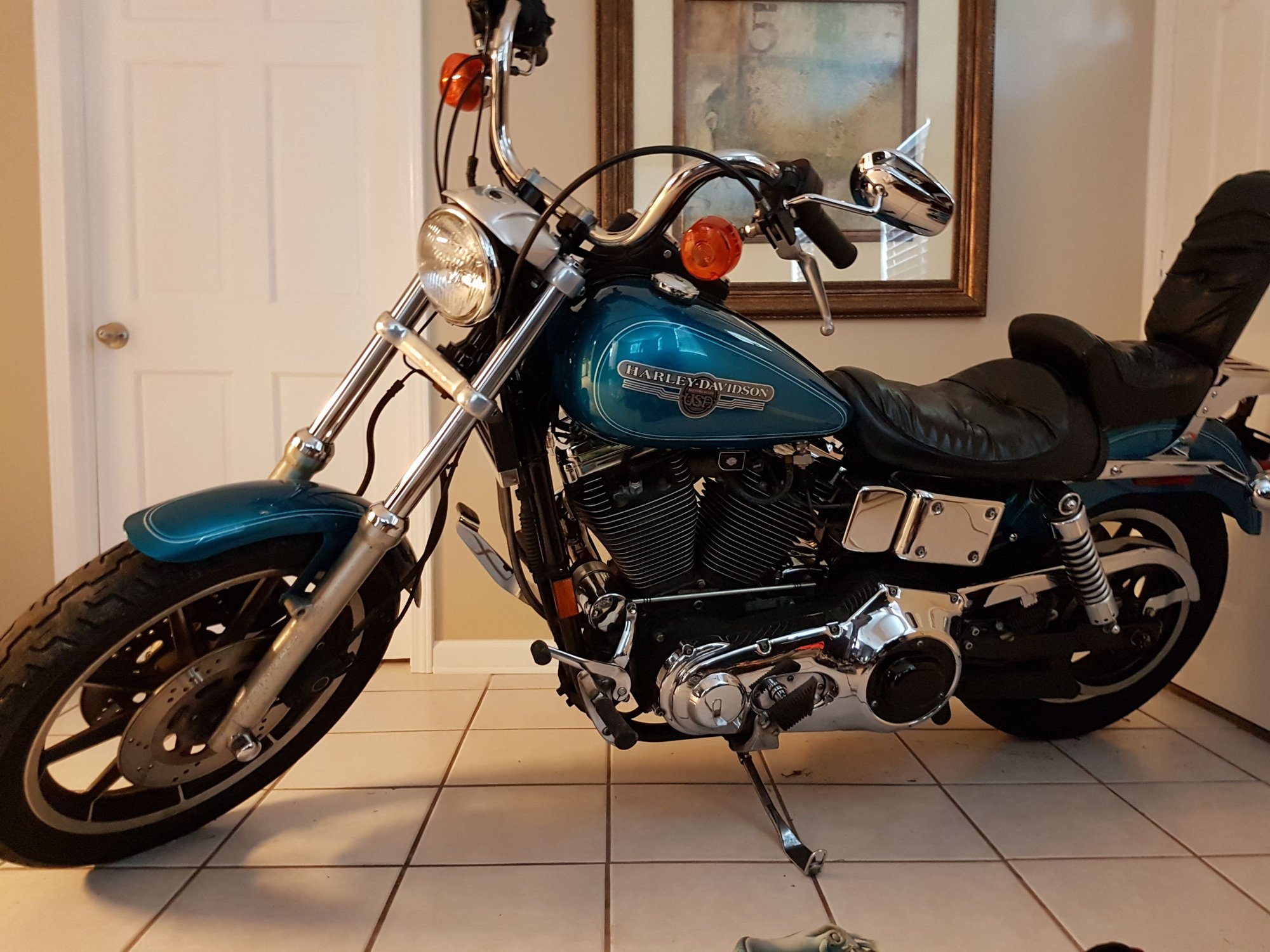

94 dyna.

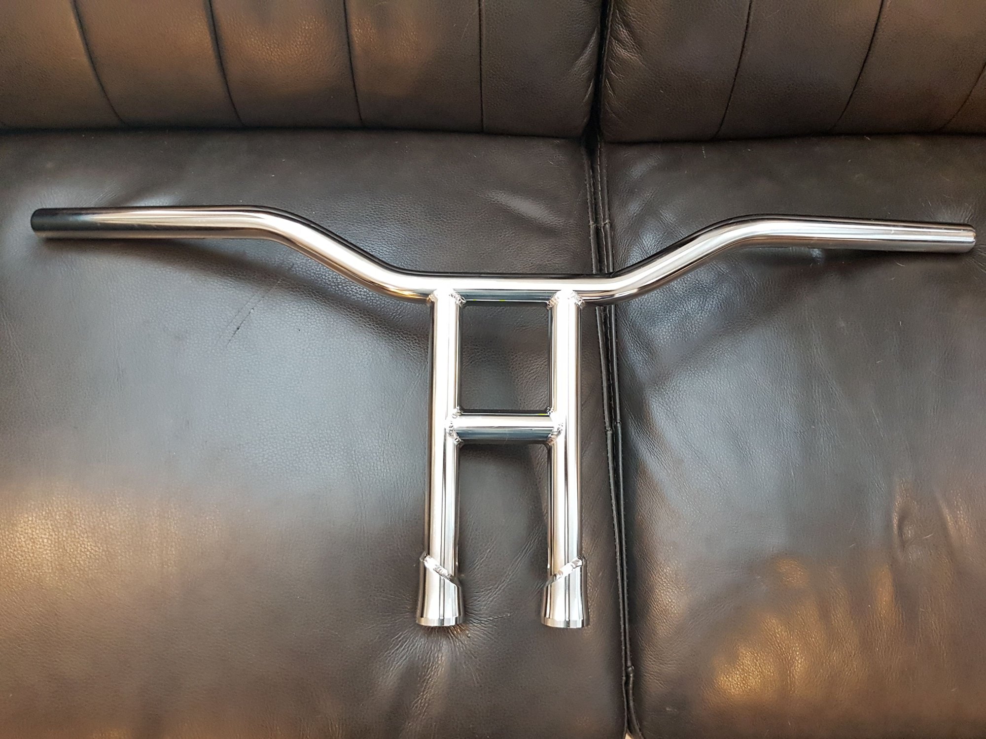

Internally wired bars.

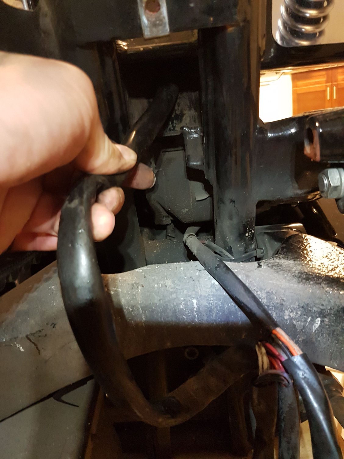

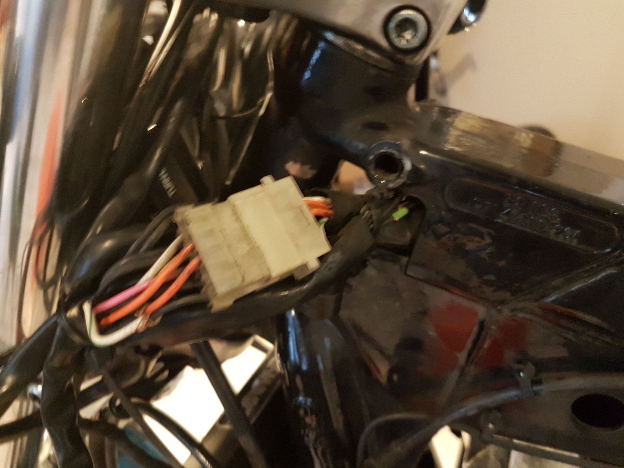

In order to access the plugs for the controls, and pull them from the hole in the top of the back bone...you must first pull the rear fender to shove the wires forward, while tugging them out from the front.
Not thrilled with this design.

Push the harness forward...
While pulling out from the front.... (broke a wire in frustration. The plug hangs up on the inside of the backbone opening. Dont do that.)
