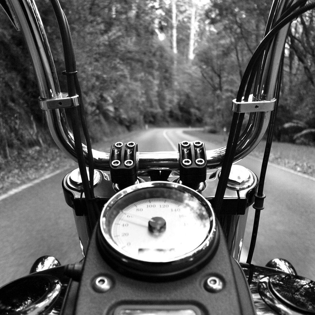

I ran 15" santee bonanza apes with stock cables on a street bob.
With RSD risers
