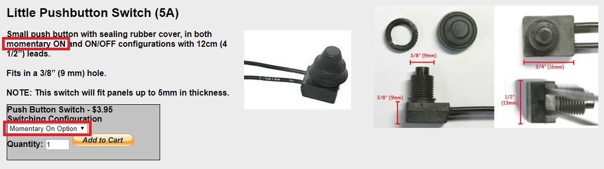

The kit is not my cup of tea. I dont want any bigger controls, I just want a button thats function as a passing light that positioned on the left side of the bar like any other bikes in general. When you hold it in - high beam on. Release it - high beam off. A simple small switch/button. Just to be clear, by releasing the button is not the same as physically push the the off switch again, like how it is done on HD in general.

This switch together with (home made) item #19 from this Instruction Sheet might be what you're looking for & a proposed wiring diagram.......
https://easternbeaver.com/Main/Elec_.../switches.html
Signal current from switch (86 ==> 85) activates coil; coil activates internal relay switch (30 ==> 87)
30 = + from battery (requires mim 2.5 mm2 wire)
87 = + to lamps (requires mim 2,5 mm2 wire)
86 = + from switch or headlight wire (to activate relay)
85 = ground
If you want them to work with high beam, splice power source wire to switch to the highbeam wire.
If you want them to work with low beam, splice power source wire to switch to the lowbeam wire.
If you want them to work independently from high/low beam splice power cource wire to switch to the runing lights wire (see your manual for the color, on my 2003FXD it's the blue wire) or run this power source wire to the + on the battery or the aux fuse in the fuse box.
