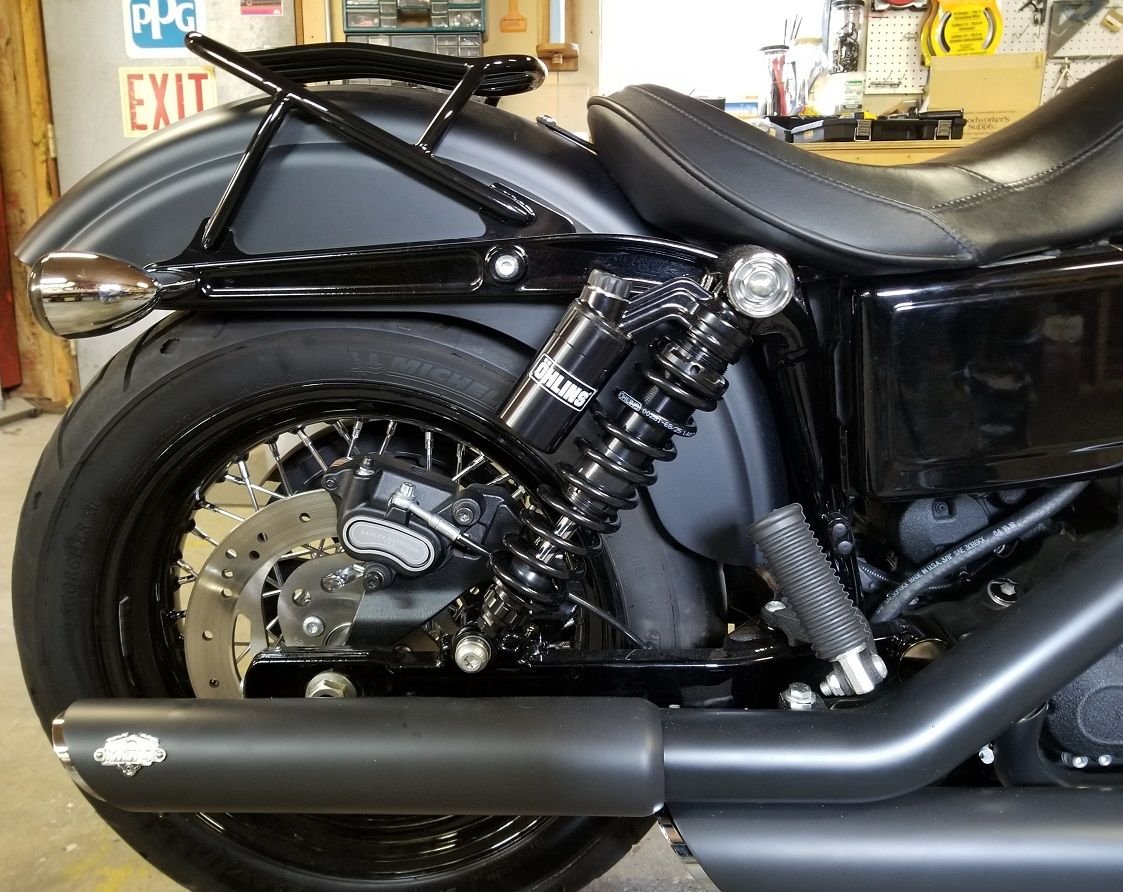

I chose the 13.5 inch piggyback model with the hydraulic preload adjuster. I got these before the blackline was out but I think I would have got these one anyway. I wanted the extra travel in the rear and I wanted to raise the rear ride height a bit to change the geometry a bit to make the bike a little quicker in transition. I also had to have the hydraulic preload adjuster because I'll ride two up at times and wanted to be able to adjust the preload accordingly with no tools.
