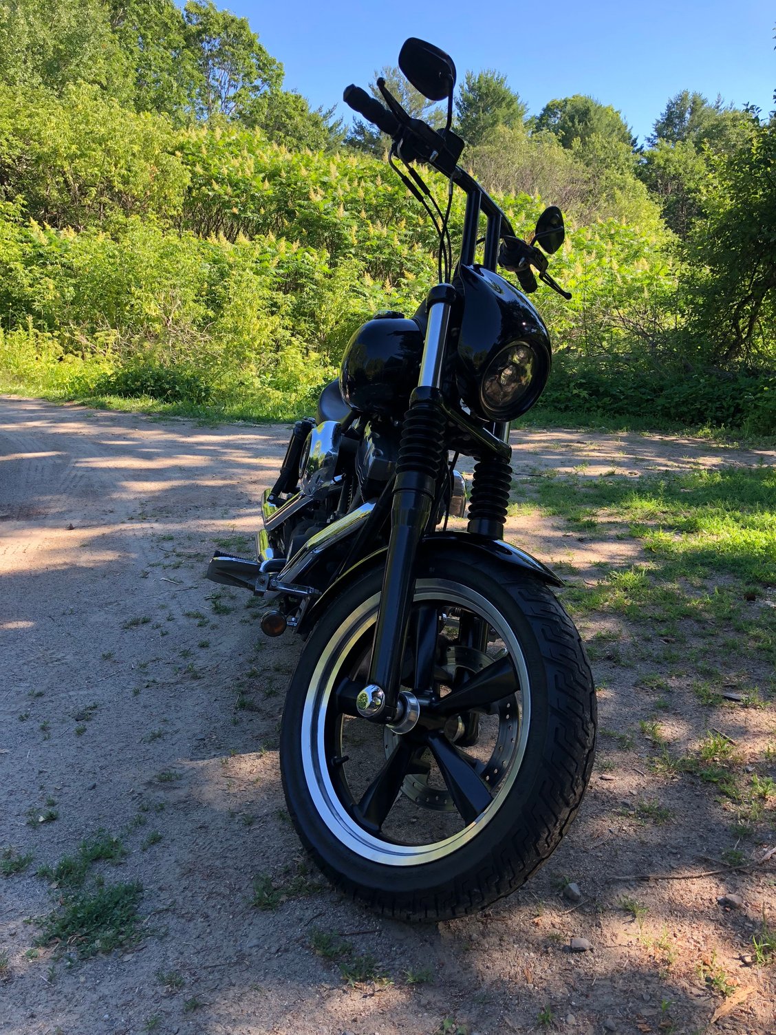

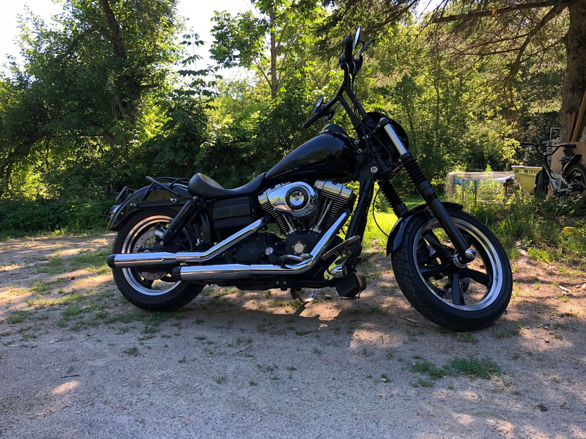

Got the switchback wheels mounted. Loving the 130 up front. Cut the front fxdf fender tabs down a little so it sits nicer on the wheel.

That looks really good.....

Looking good..
Are those stock rear shocks?

Looks good! I like it.

Originally Posted by REW13
Looking good..
no they are progressive full cover shocks

Looks good!
Got a pic of how much you removed from the fender tabs?

Nice. Looks sharp. As a Switchback owner, the rims were an aesthetic high point for me on the bike. They look great on your bike!
