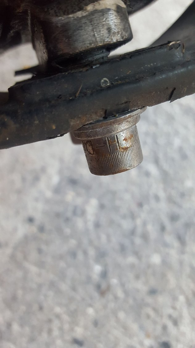

I did find this, red loctite and re torqued, not the source of the sound though....
