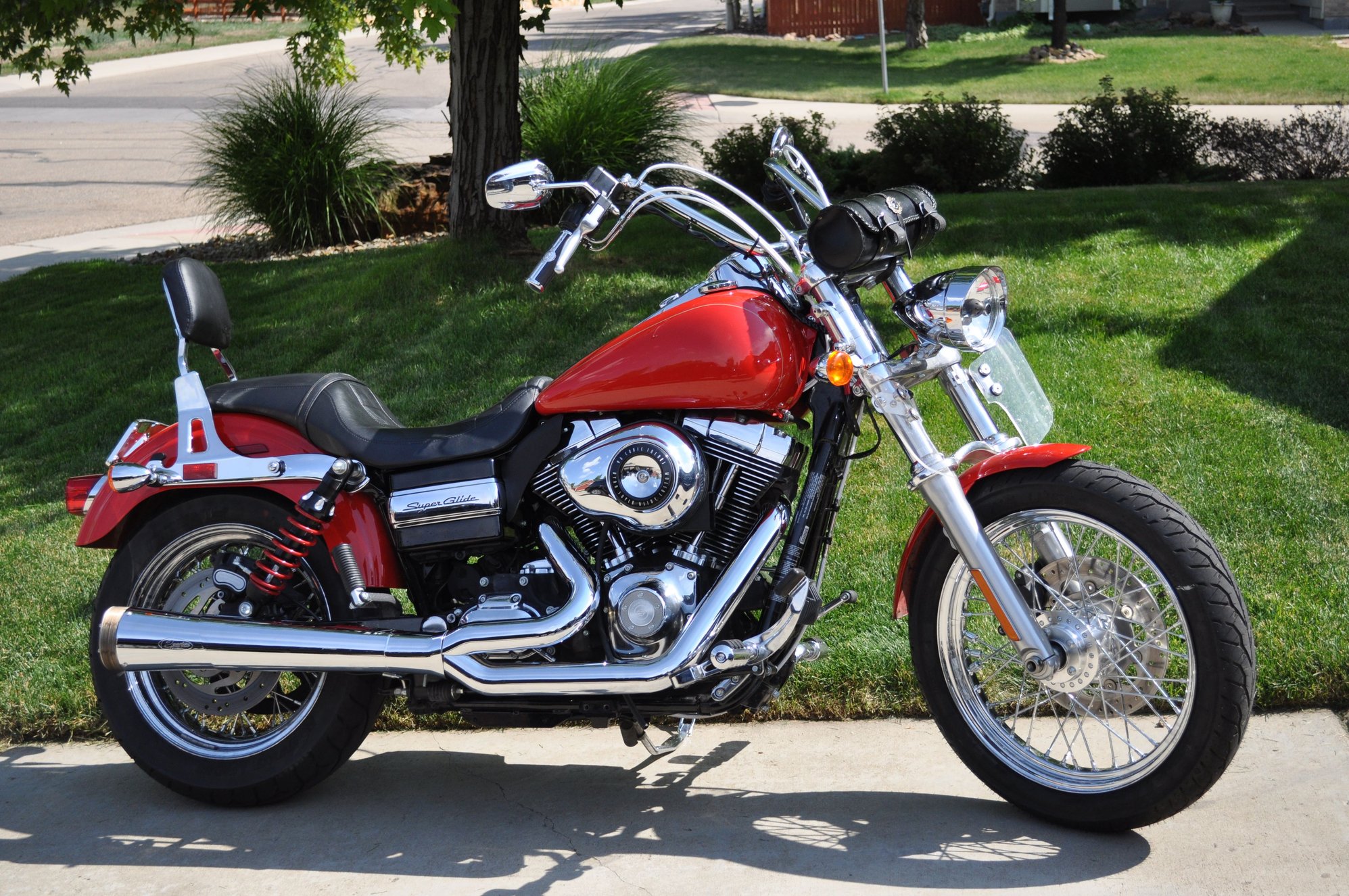

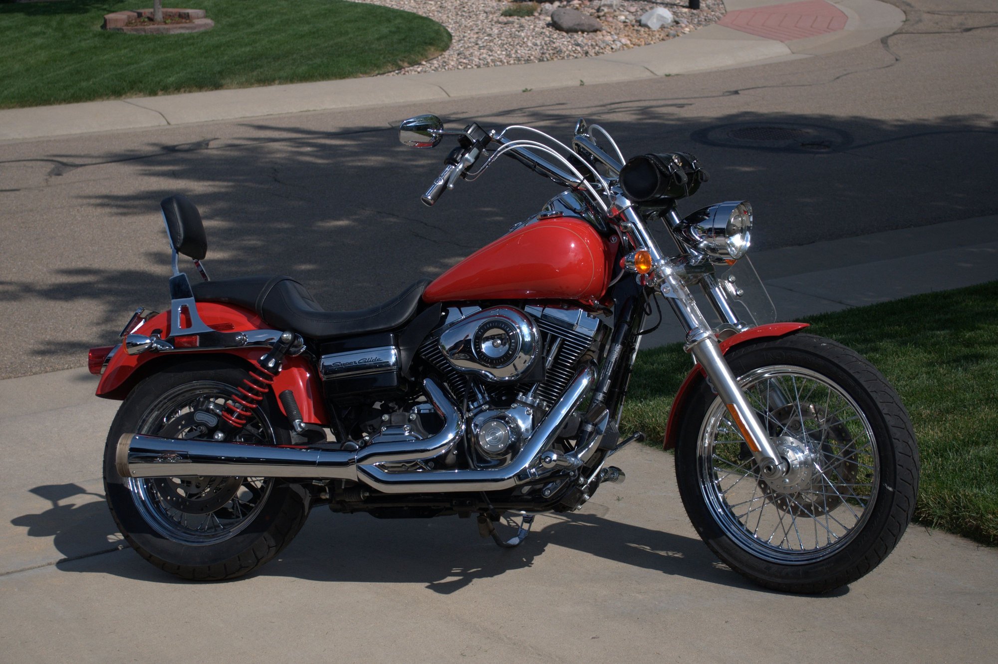

Here are a couple of pics of the end result.
Today I finished it off and put Pirelli Night Dragons on it, stock sizes. Major tip of the hat to High Country Harley who worked with me on an insane Saturday to mount and balance my tires. There were easily 100 Hogs at High Country all day. The Dyno there was running all day. Packed. Rockin. I am not really a big part of the social scene but its always the best fun to be around hundreds of bikers.
I pulled the rear wheel and delivered it at 10, they called to say mounted and ready to go at 11:15. I live 3 miles east of them but I was on the way. So I pick it up, take it home, install it, jack up the hog and pull the front wheel. I got it to them at 1230. They called at 2 and had it ready to go.
I remounted the front wheel and just went for a quick installation run. Just a mile or two.
