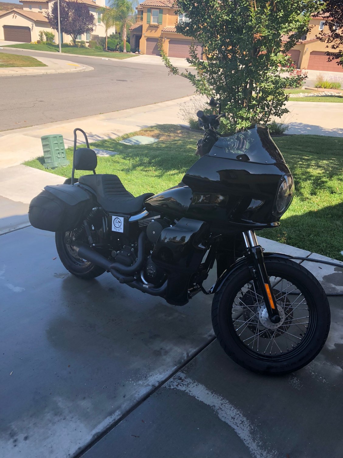

I’m sorry if this is repeating a previous thread, I have looked through a bunch of ones and can’t find the info I need. I am looking at converting my 2016 FXDB to a chain final drive so I can change my gear ratio to lower gearing (higher numerical number). 6th was always super tall but since I put my cams in (585c) it’s almost unusable. My engine guy/tuner is recommending a 26 tooth front pulley to avoid any damage to the primary, I see a lot of guys running smaller front sprockets with a chain slider so am curious to hear anyone’s thoughts on this who have actually done it. Also, if I do run a 26 tooth front, how large should I go on the rear sprocket? I definitely want to improve the gear ratio but don’t want a top speed of 80 and a stunt setup. I usually cruise around 85-90 on the freeway and still want to have a good top end, just more useable power throughout all the gears. Any help or insight you guys can provide would be appreciated. Thank you!
