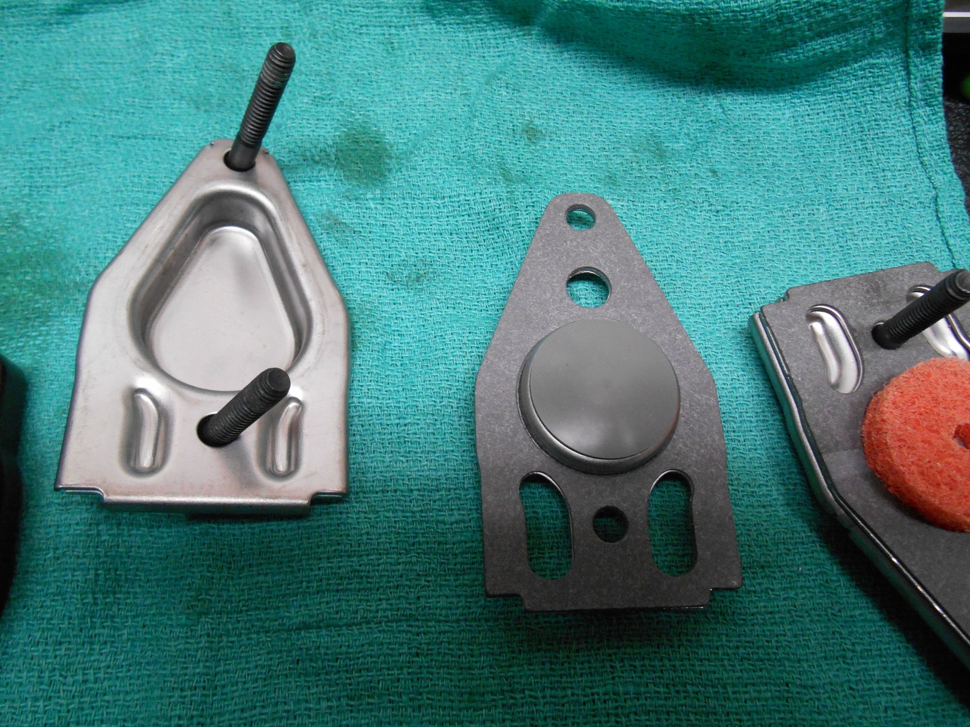

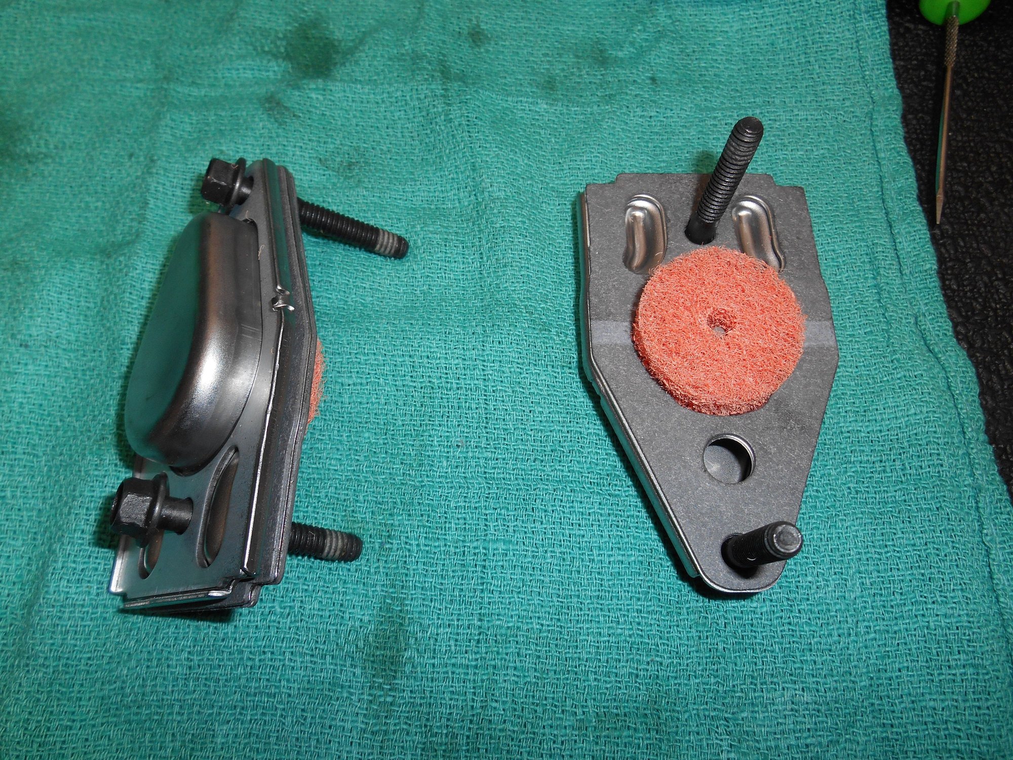

Under the rocker covers. There is the shuttle valve and a filter sponge with some gaskets. This located in a aluminium housing between the rockerarms on each cilinderhead.

I also had a minor leak that I thought was coming from the pushrod tubes, turned out to be the rocker cover gasket to the heads. Take a closer look at the forward side of the lower rocker box to the head for any wetting / seepage .
Rocker Box Oil Leak:
https://www.hdforums.com/forum/showt...eferrerid=9012

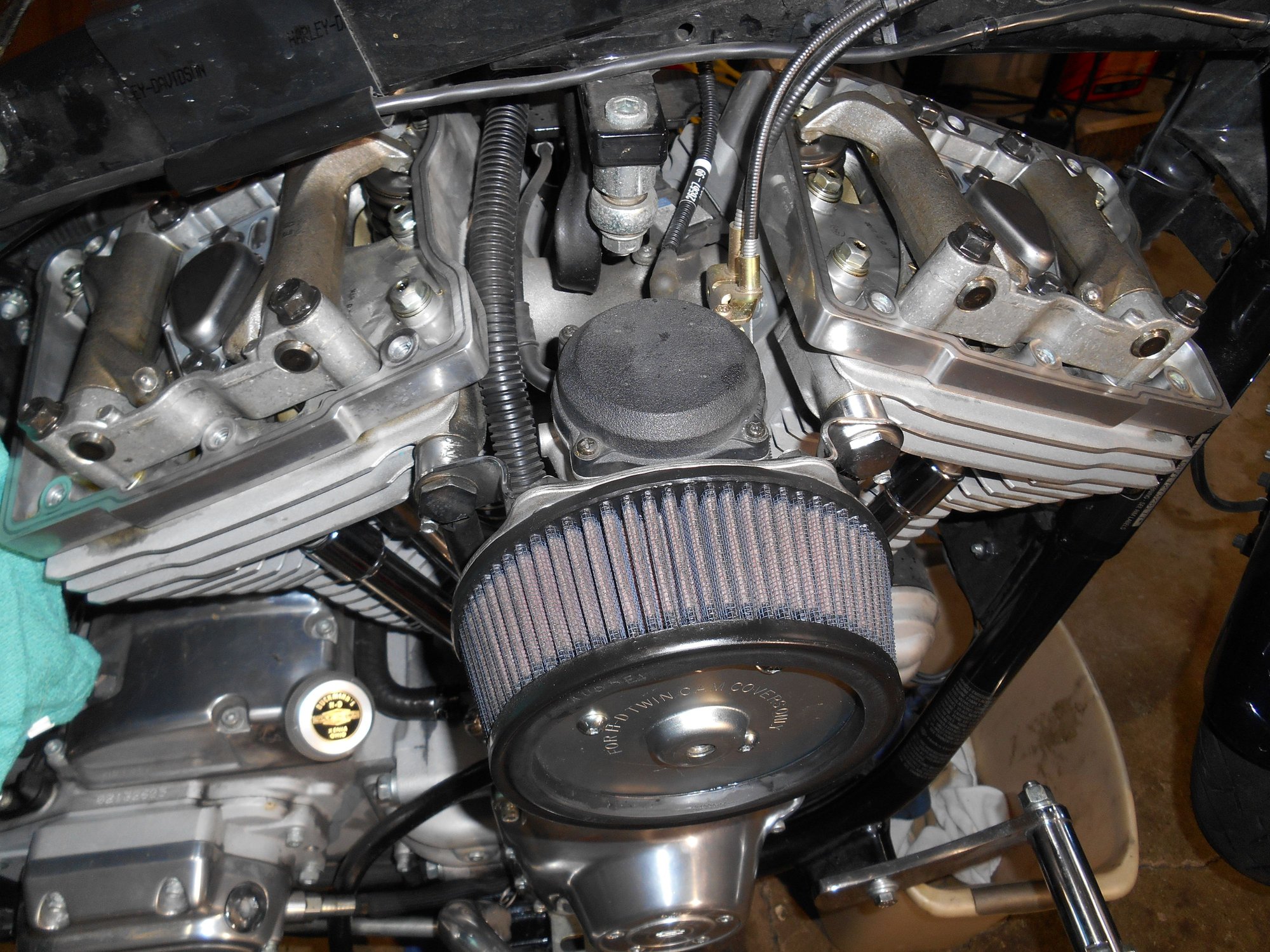

Just replaced the lower o-rings on the push rod tubes. There was no point in replacing all three as the leak was definitely coming from down low. Also tightened up the four bolts on the lifter cover. They were really loose - barely more than finger tight. The Harley manual calls out for 90-120 in-lbs which isn't very much and there is not room to even get a socket on the back two bolts.. Barely enough for a small allen wrench. Using a small allen wrench I just applied my favorite german torque spec - 'gundentite'. Maybe I should have replace the gasket, but just tried tightening up the bolts. Worst case - I get to do it again. I also checked the breather valve.
Everything seemed OK. I foam filter was not plugged up and the rubber 'valve' seemed pliable enough. Was not sure what else to check for so I just reinstalled.
Have not had time to ride the bike yet but after I get a couple of miles I'll post of this took care of it or not.

This did not fix the leak. Did the job again replacing all o-rings and gasket on lifter cover. Leak still persists. I do not see the oil trail, but the leak must be from rocker cover, rocker arm support plate or between cylinder and crankcase. Cylinder fins seem dry so I fear that it is the cylinder to crankcase o-ring. Really need to de-grease engine, run just a little and start looking for seepage. I really hate tracking down oil leaks...

Thanks for the link. Leak still persists, but fins seem clean & dry so I fear that the leak my be between the cylinder & crankcase. Will have to degrease and carefully look to confirm.

I don't disagree w/ you as it being unlikely. I will have to spend for time meticulously tracking down the source of the leak, but at the present do not see any oil on the fins. Oil can leak there if the o-ring is damaged even if the cylinder head bolts are properly tightened.
