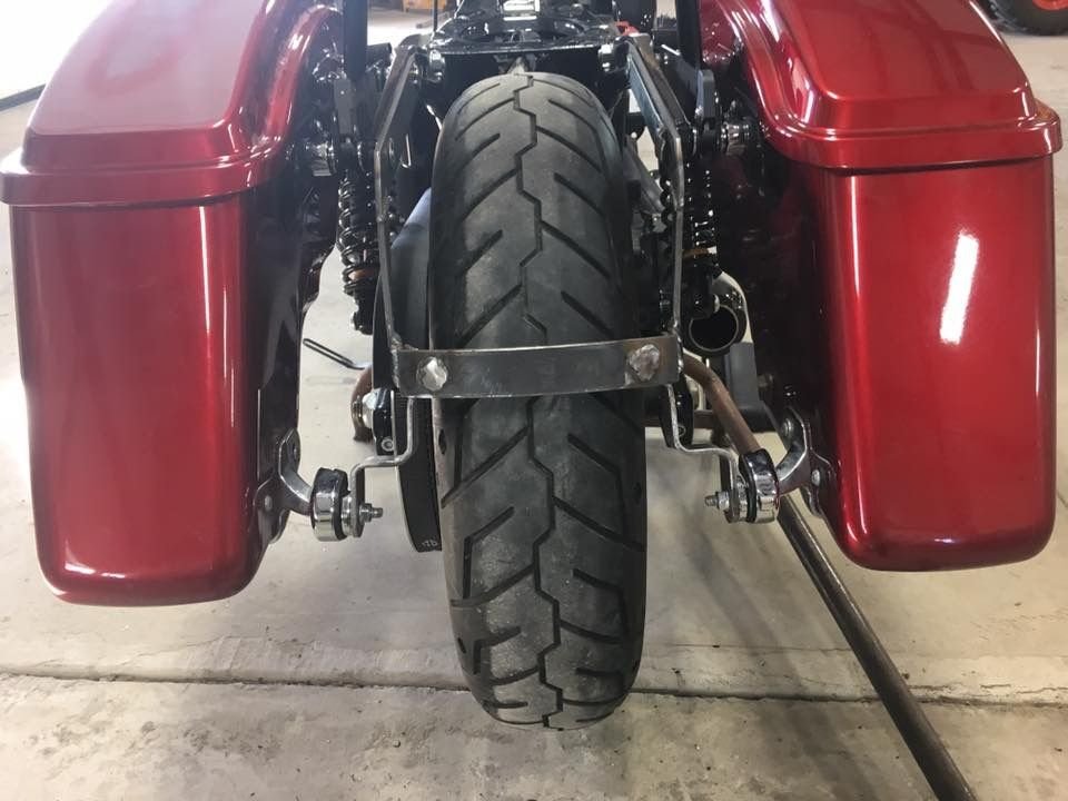

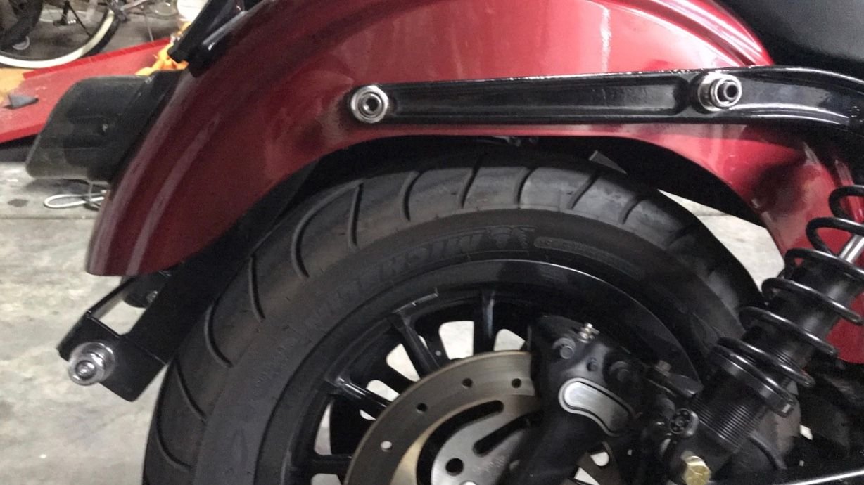

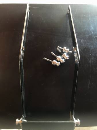

Yep, just went to mount the first bag and am realizing these things are going to shake horribly without a third mounting point. Any ideas?
I'm running a bracket like this on mine. Guy I bought my bag setup from had fabbed it up already, the downside is you can see the barbelow the fender. The last pic is from someone who modified the design and hid the bar under the fender.
Man, I wish I had the skills to make that myself. I dont mind the bar being seen at all.

Contacted Grear Bike Gear about weight limits on their easy brackets. They replied first thing the next morning writing that the recommended weight limit is 15 pounds. So that option is out. I'm scraping this project, sooo if anyone wants to buy some bags, pm me!
