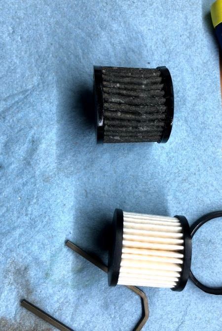

Well, after I picked up and replaced everything on the interior of the fuel tank...I'd be willing to bet my issue was a dirty fuel filter. Now, I don't have everything back together yet to be 100% sure this was the issue, but it sure looks like it.
That's what I get for waiting to disassemble the fuel delivery apparatus on the interior of the tank until I had all the parts to rebuild it!

Make sure you clean the tank out before you put the new filter in.
