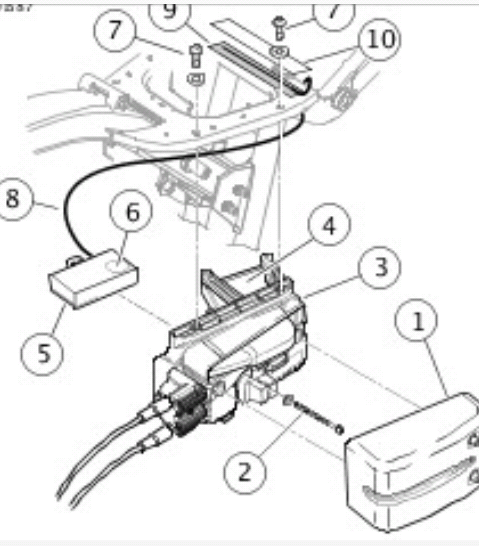

Old Sep 6, 2018 | 10:01 AM
DaleM1's Avatar
DaleM1
Joined: Aug 2018
Posts: 125
Likes: 38
From: Calgary Alberta
Thanks.
Im guessing that 5 or 6 is the security system and the plug that the siren would plug into must be somewhere under number 10.
Dale

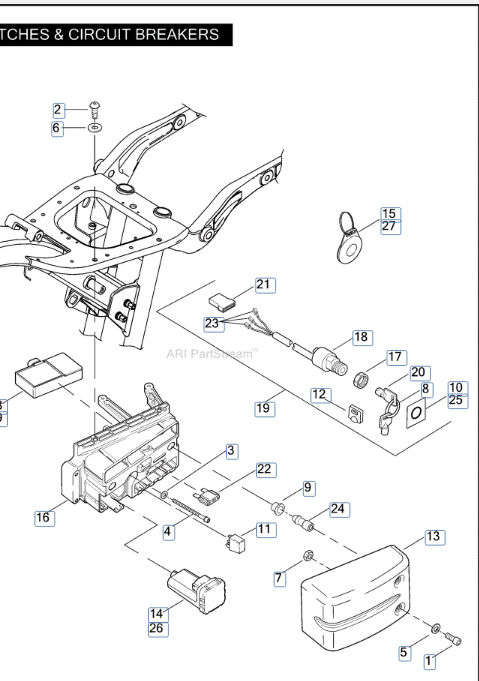

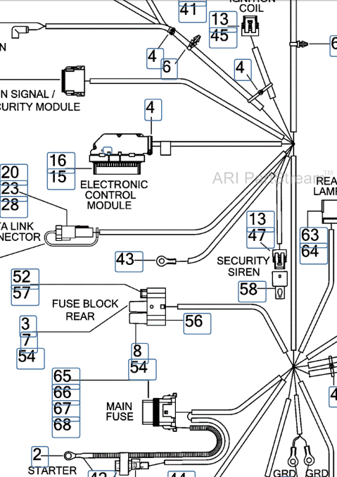

I don't have any first hand experience with your bike, but perhaps this will help. #58 on the diagram is a dust cap that covers the siren socket. Look for that dust cap.

Thanks, that’s the mysterious plug
that I can’t find.

Did you take #13 off, and look behind it?

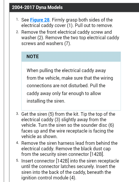

You have to tilt out the electrical caddy (#3), it's behind that. Look for the dust cap.

Step #4.
