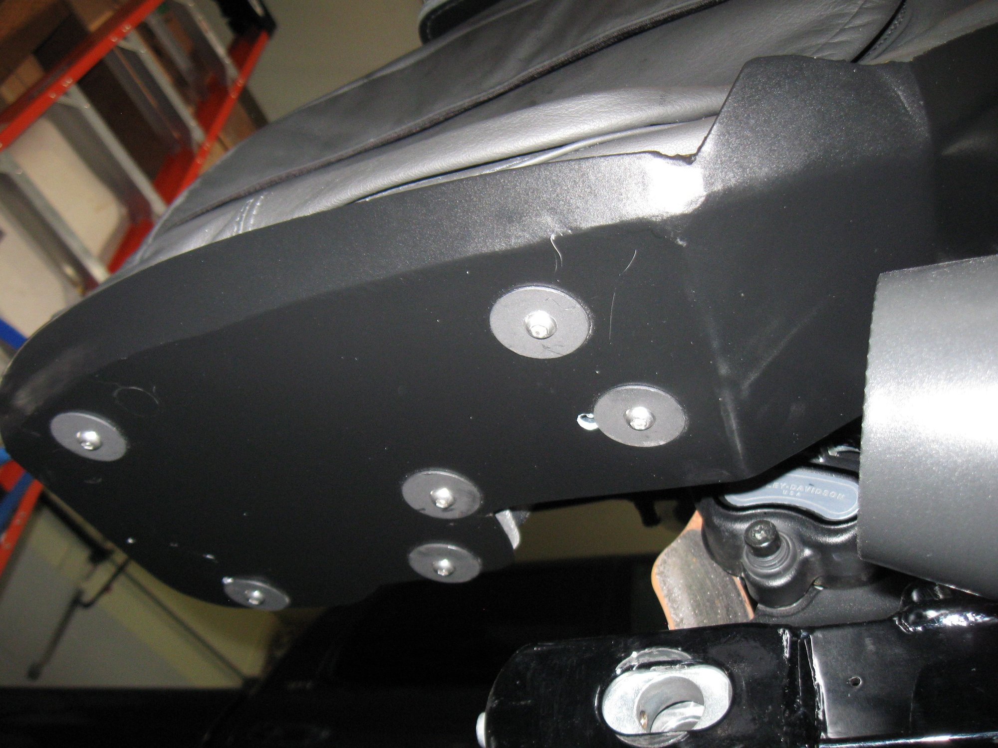

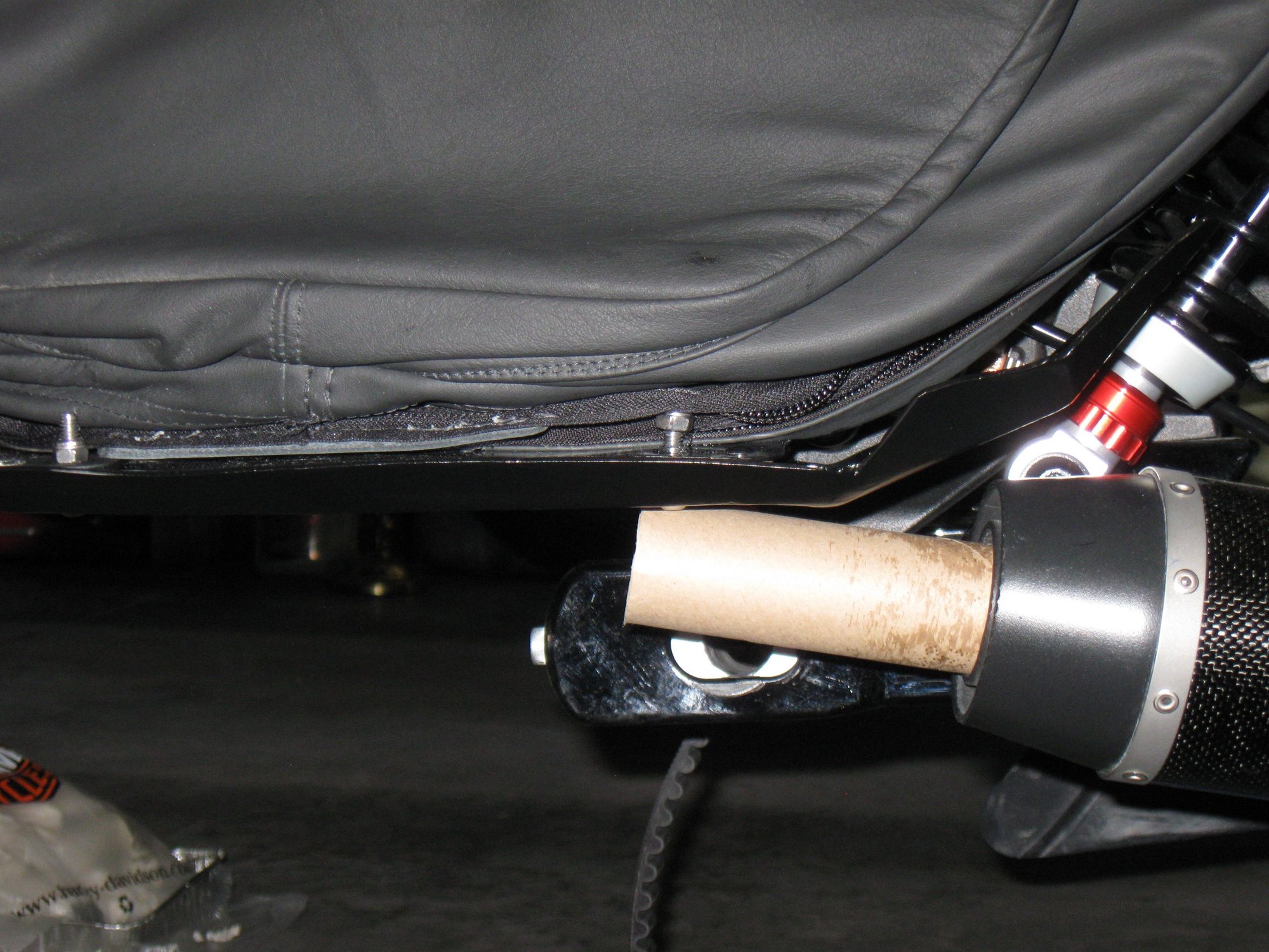

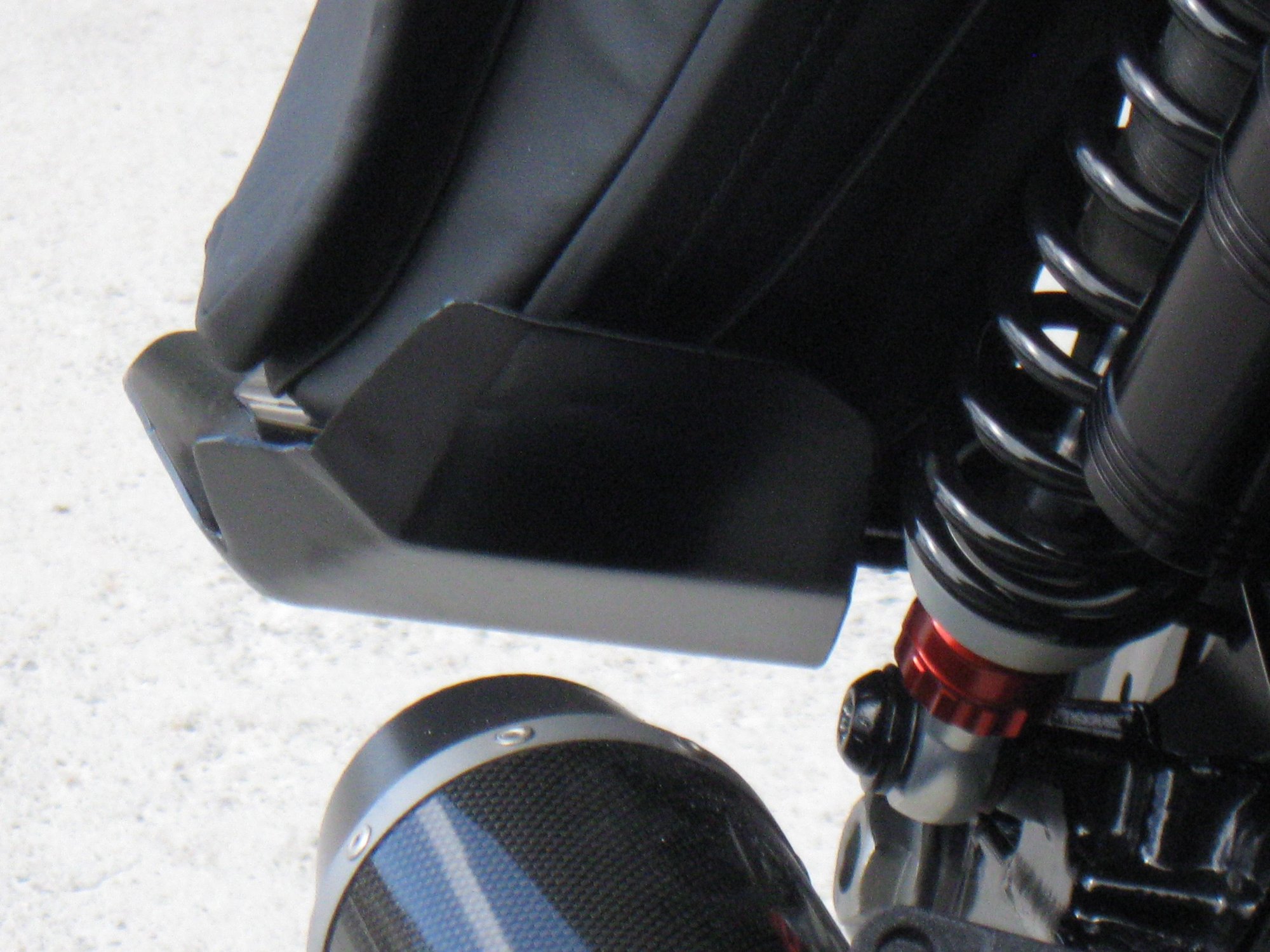

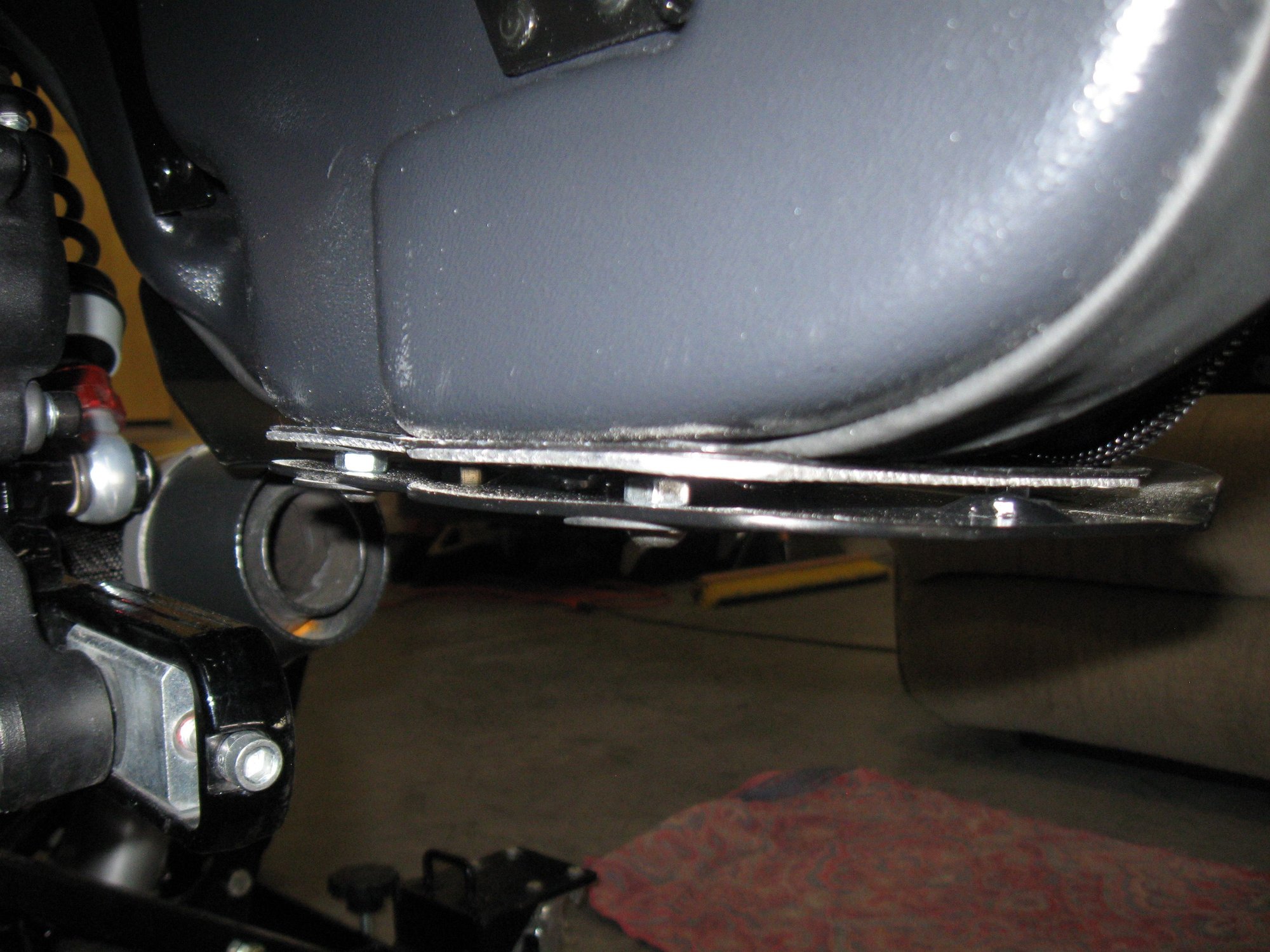

Antonio, here are some pics that might help, and anyone for that matter, the shield is easy enough to build. I think mine is around 3/16's aluminum, heat it gently and make your bends. (After you have layed on your back making the template over and over again to get it just right [make sure it clears the swing arm]).
The deflector is half of it, use nuts on 1/4" bolts to create the space between the shield and the bag to provide airflow between them.
You will love the Bobcat!

Drill the holes one at a time (first two anyway), I used some sealant [maybe high temp but don't remember] in each hole in the bottom of the bag. I can't find a pic of the inside of the bag at the moment but can take one if you need.
