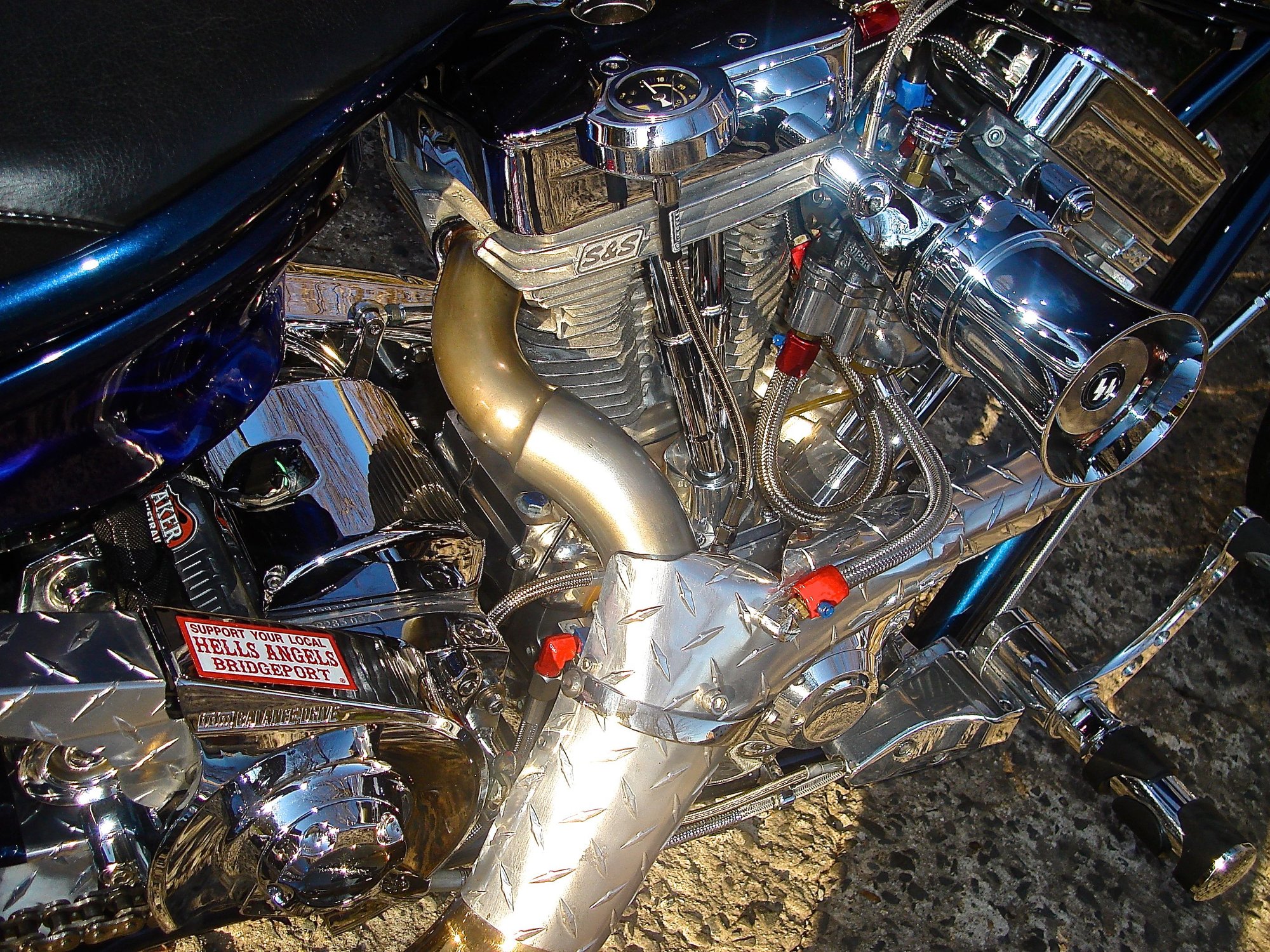

Old Oct 14, 2018 | 07:59 PM
S&S145's Avatar
S&S145
Joined: Jul 2018
Posts: 83
Likes: 7
From: America
Stainless Steel diamond Plate,cut it,measure what you need as well as your pipe diameter, then buy the appropriate stainless steel hose clamps,cut em and size em up to ensure a snug but effective shield away from the pipes themselves behind the diamond plate ( the clamps themselves will give you 1/2" and help with heat clearance and burn issues )
