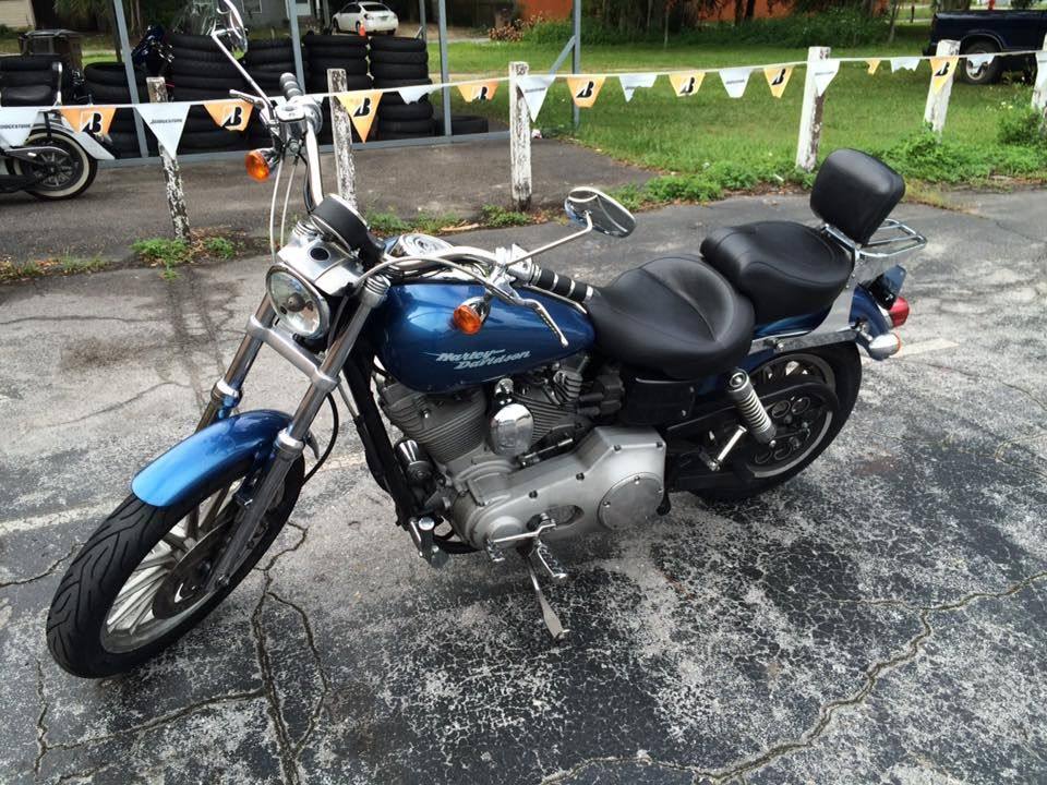

All Good Answers Above other than the 05 is 1" Front Axle and 04-05 are Frames unique to those 2 Years .. Found that out when got such a good deal on my Mustang Seat for my 05 .. Vendor wanted it gone .. Also No Worries on Cam Tensioner Upgrade ..
