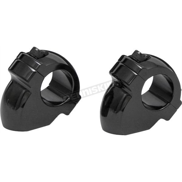

Did some more digging, found these, which have a slight offset, but have the 1" rise that I want...thoughts?
https://www.denniskirk.com/west-eagl...k.p5902138.prd

Those should work fine.
They only have 1/2" Rise
With that "Offset" or "pullback", you still get full thread insertion of the large mounting bolts while being lower than the STD Short risers (1.5 - 1.7" high)
I believe rise is distance from bottom to the center of the bar, no? If so these are 1" rise.

Ok 1" rise ... I was really just referring to with that only being ~1/2" (dimensionally) from the bottom of the riser to the bottom the bars that the offset allowed more large hold-down bolt thread insertion than if it was a straight riser

Yep, excellent point, didn't think of that, definitely gives more security for the bolt.
