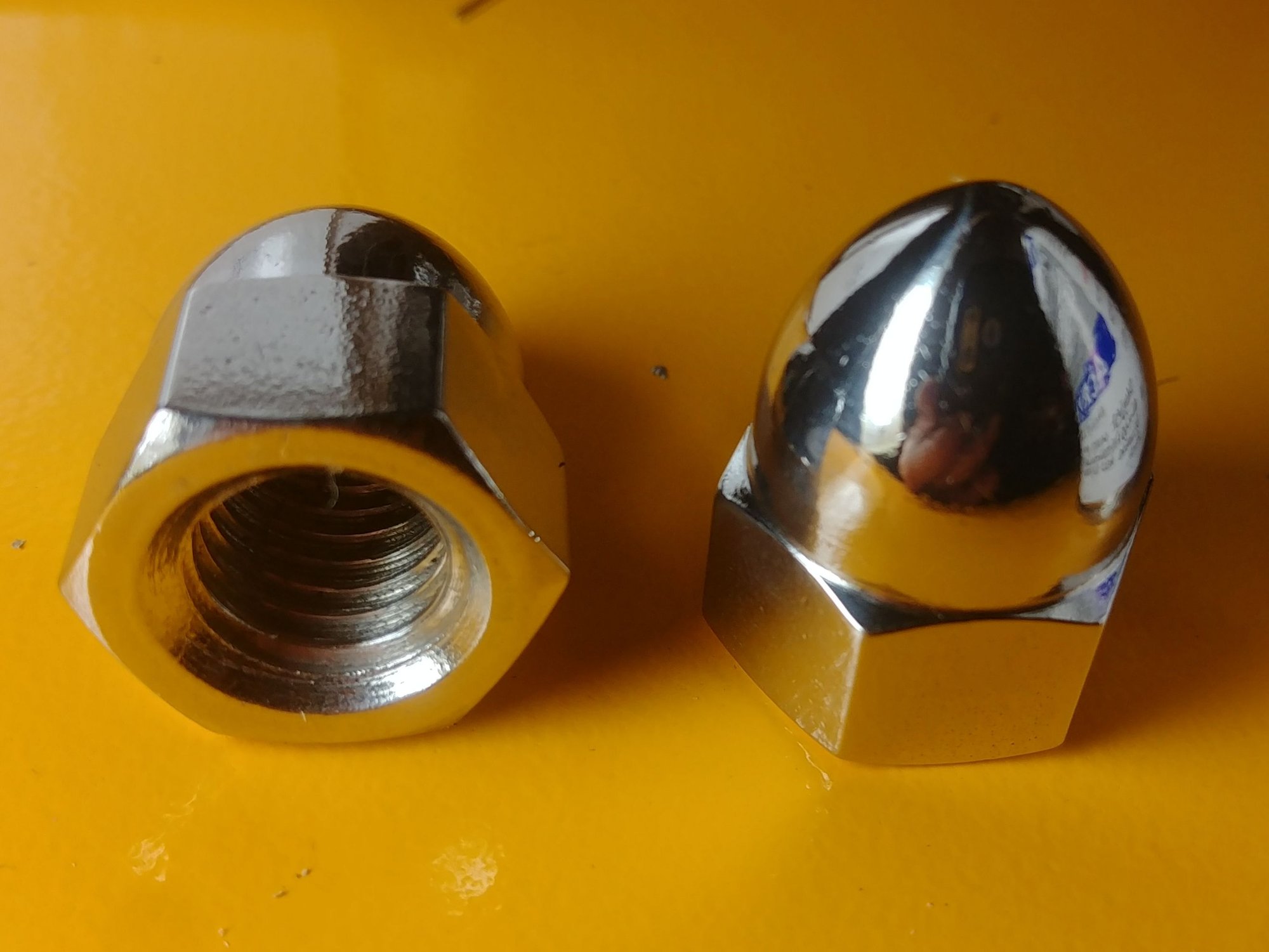

From: Philly Suburbs
I guess this is just one of those HD mysteries... The microfiche clearly shows my bike as using p/n 7554, as it does for the OP's bike... But yet we both have 1/2"-20 thread on the stud/acorn. And at least in my case, everything appears to be undisturbed since new...
I can't help wondering about the difference between 54557-90A and 54627-00... I'm assuming it's length. But I wonder whether the thread is different as well. Maybe there were specific acorns for each of these studs, but an error was made in the parts books when they were all listed as the same.

Originally Posted by F86
Chris - If your threads are 1/2 13 and you got the wrong acorns from AlloyBoltz, we could switch! I got coarse and need fine...
I checked. Mine are also 1/2-20. The acorns I got from Alloyboltz are 1/2-13. Sorry for the confusion.
Here's what I had in the spares bin...
1/2-13, long acorns, non-locking, stainless.
I'm currently using the stock (?) 1/2-20, short, locking ones on the bike
Interesting. I suspect something's inaccurate in the HD parts book. It lists two different part numbers for the stud, but only one for the acorn. It seems there were two... I sent a note to AlloyBolts about it, and here's what I got back:
"I don't stock a 1/2-20 Acorn. The stock Upper stud for the Harley Dyna uses a 1/2-13 acorn for the Outer Nut. I'm not sure why you have a 1/2-20? Did the stud get reversed? The portion of the stud that goes through the frame and fender Strut is a 1/2-20."
I'll double check tomorrow, but I think my studs are 1/2-20 on both sides. I bet that's the difference between the two stud part numbers.

My stud is 1/2-20 on both ends.
So that's three of us on this thread... I really think there's an error in the books. I've reinstalled the OEM locking acorns as well, at least for now.
Three pages about one nut... Who woulda thunk it?
Update: AlloyBoltz have ordered a set of 1/2-20 acorns for me.
