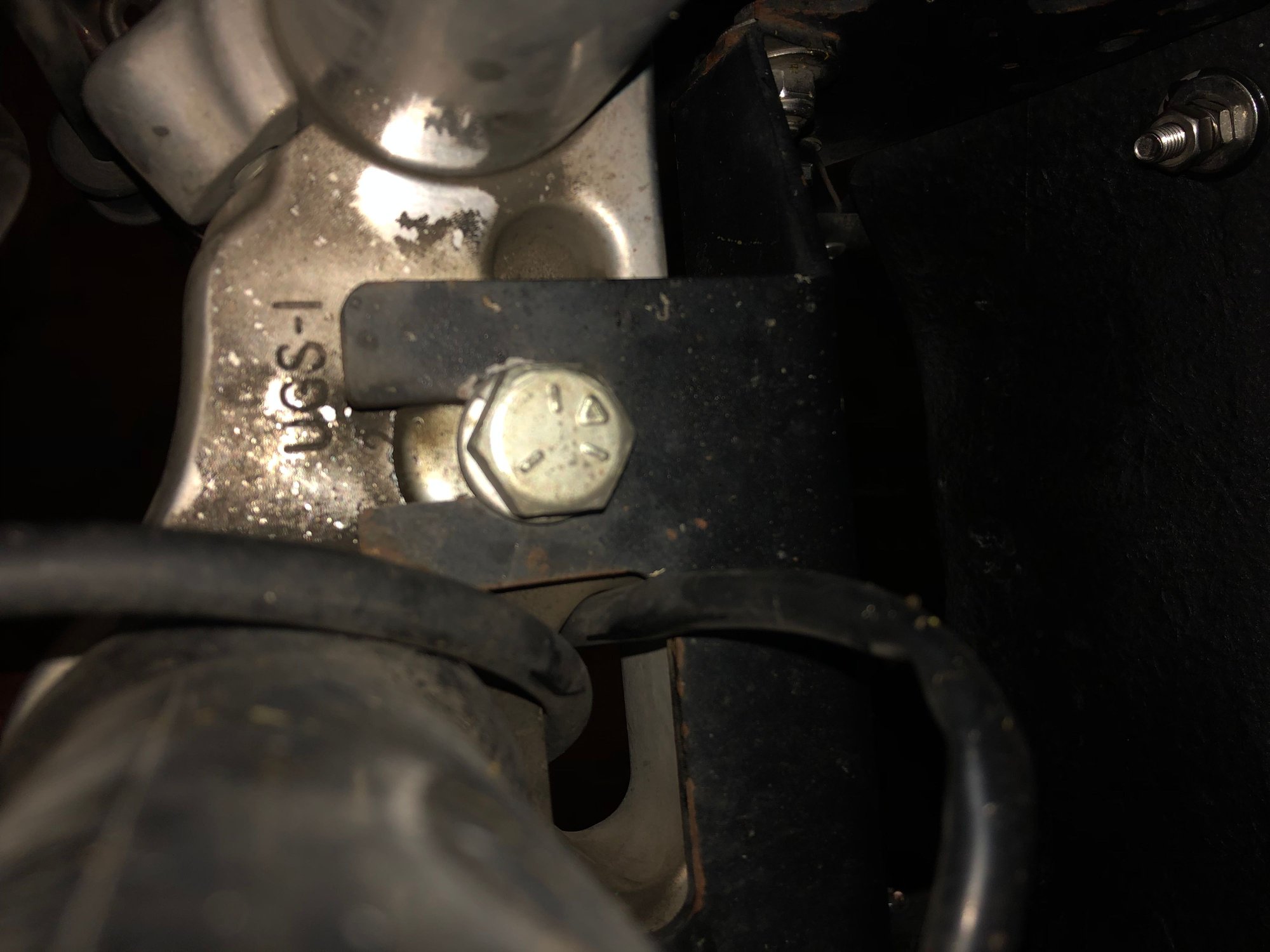

I don't know anyting about the Krause trees but there is about an inch between the bracket and the front of the top trees on the jd mount

Also my bracket is slid all the way back too so it could be pushed out even farther

I believe Hell Hound's bike is a 2014 Low Rider, which has a 1.28" triple tree fork offset. The Kraus trees have a 2.6" fork off-set, so judging by the picture, the bolt is going to right at the edge of working/not working with that bracket. I would check with a local sheet metal shop to make a new extended bracket. I can't see it costing more than a buck fifty to have a new top and bottom bracket made if you give them the JD bracket as a template.
I know Kraus stuff is expensive, but it is nice.
Dave
