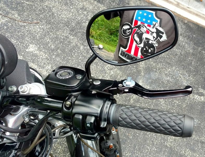

I use them, and I'm super happy with them! Is it possible you're missing a bushing/clip/spacer somewhere? The fitment is very good on my bike. I'm at work, but will look for a picture later...
For me, they're very comfortable, the adjustability is nice, and they have a sport-oriented look that matches my bike nicely. They're also really nicely made.

Did you put on that shirt to stage that pic? ... you SOB
Haha! I posted that picture awhile ago when I first got them, but I think you're the first one who commented on it! Honestly, it was a lucky coincidence... I didn't notice until I was looking at the pictures, deciding which one to post. This was the one where Evel was most centered!
