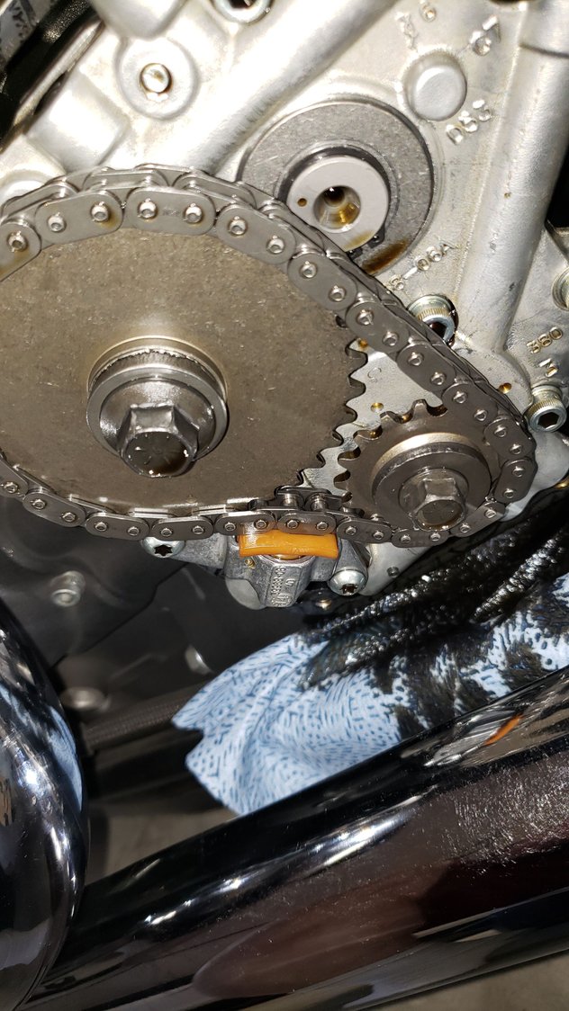

Im about to go pull the timing cover off now and hopefully see a bad hydraulic cam chain tensioner.
Make sure you grab a small mirror and flashlight to check the inner shoe as well... Don't assume it's in the same condition as the outer one. My outer shoe looked "good enough," but the inner had started to break apart.

NO4NJNK's Avatar
NO4NJNK
Joined: Oct 2016
Posts: 293
Likes: 84
From: Mississppi
Well, this is seconds after removing the timing cover. Shoes look good front and back. 22,000 miles on the bike. Chain is tight, clean and everything looks great.
What should i be looking for other than that?

Oh, silly me... I forgot you obviously have hydraulic tensioners already, so my "tips" were worthless...
Does your bike have a position sensor in the cover? I don't know how that could rattle, but if you're sure it's under the cam cover...
Another thought: Could it actually be from the compensator area, and the sound is being carried through by the crank?
Did you try listening everywhere with a screwdriver or stethoscope to really narrow down the location?
