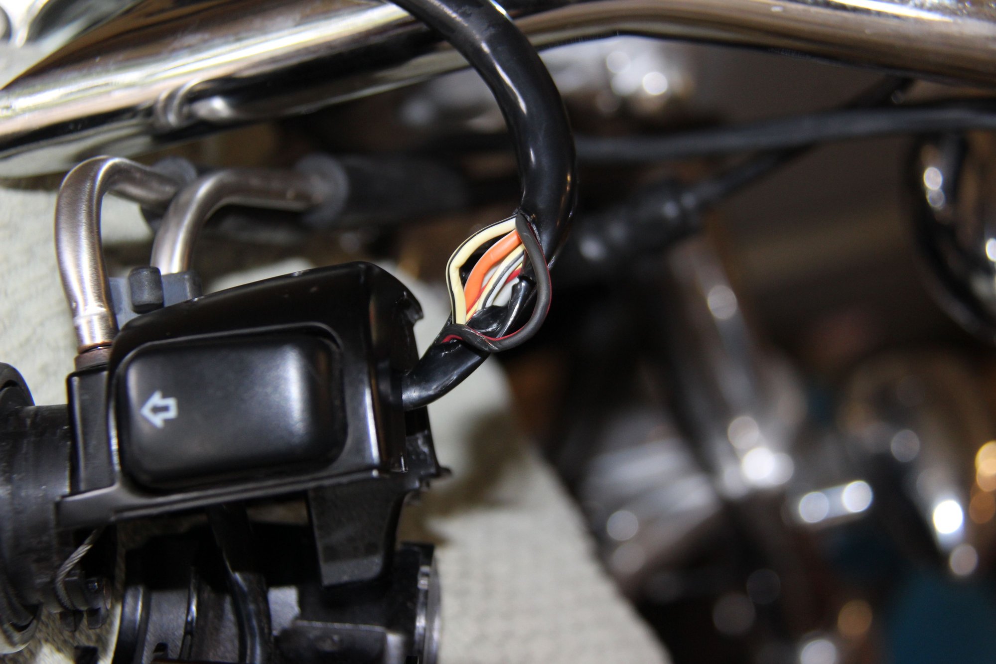

Ok, so today, I ohmed out the orange with white stripe wire (from ACCY fuse) and I had a dead short between it and the handlebar.
Would you just start cutting the outer sheath and testing until you found something? Certainly there must be some usual places to check? I DID pinch wires in the process of installing the controls on the new bar so that's where I'll start. I just don't see how it could be a dead short (?) to ground.
ANY tips welcome, guys/gals.

Can you unplug the switch and recheck? How about the connector at the neck? Try unpluging them one at a time while checking for the short.

Rereading your post I think you answered your own question. Look closely where you pinched

I did it!! I found 2 shorts. I created both , so they were fairly easy to find, once I started looking. That was the scariest part, lol.
Anyway, got them sorted out, cut some wire slots in my new bars, tried out my one of my new risers, and called it a day.
