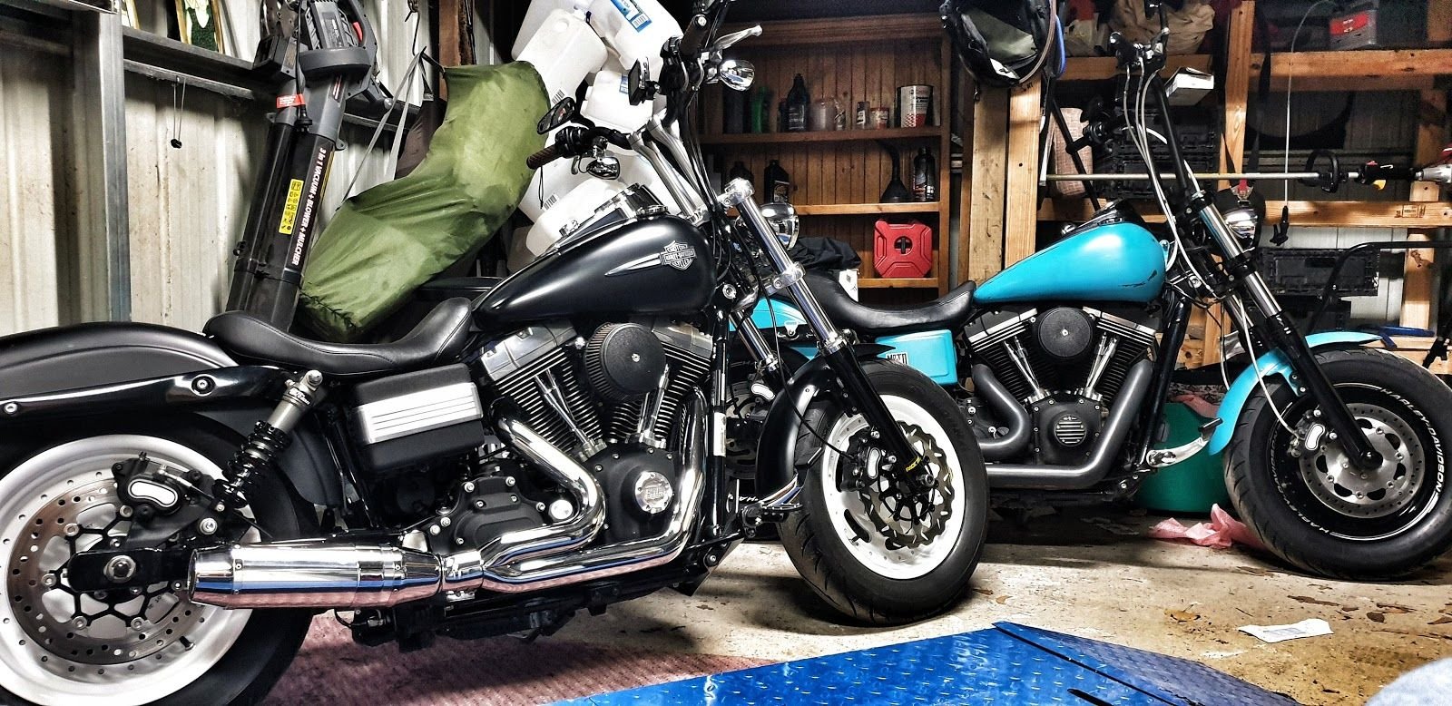

Pretty happy with my 11” pro action shocks.
They are lower but have longer travel (I’d guess 2-3 times the travel of my 11.5” progressive 444s)
made to your weight and riding style too.
