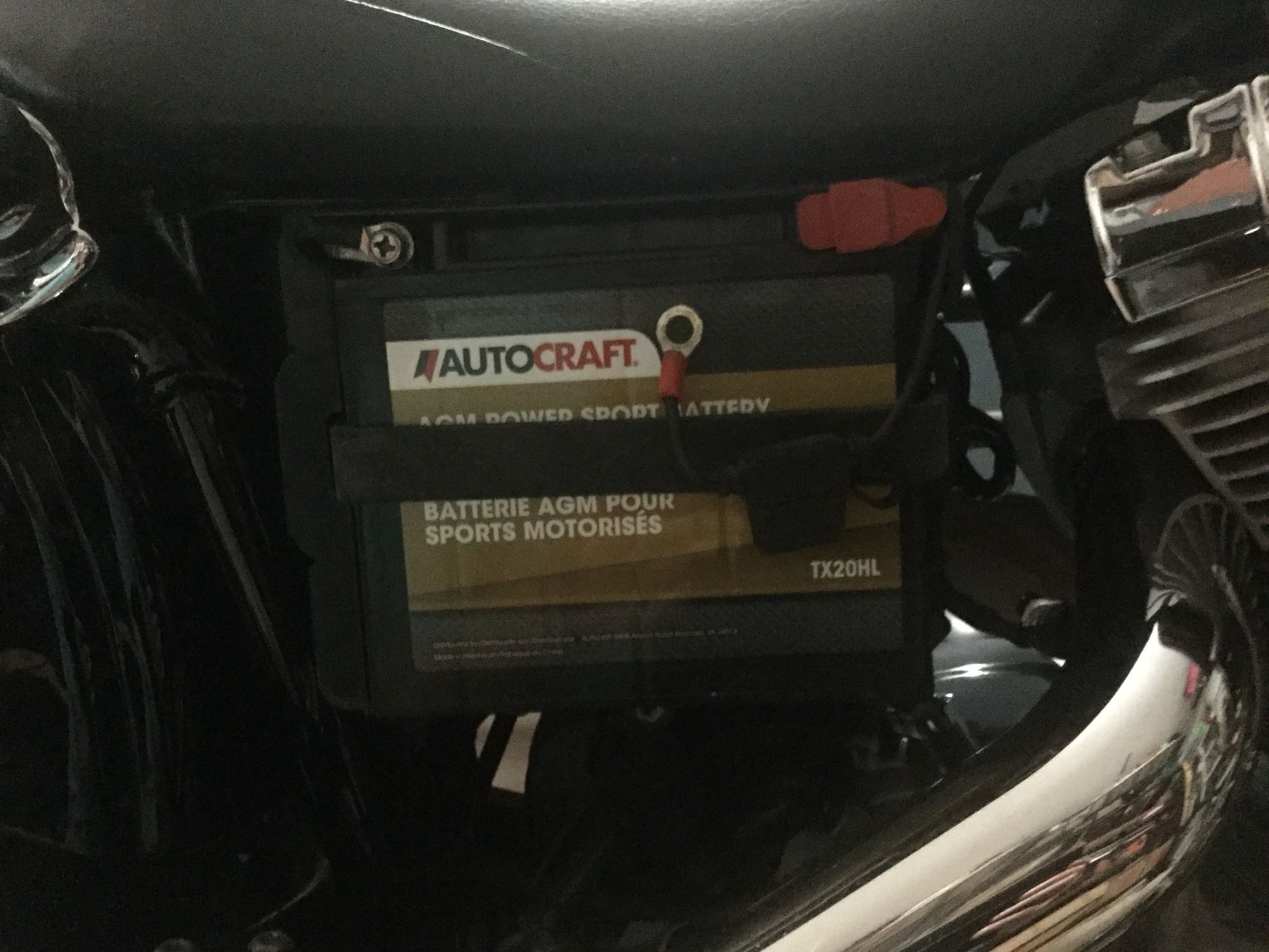

On my 2007 Dyna Custom there is a wire with a fuse connected to the positive battery terminal. The bike has the factory alarm/security system. If I don’t ride the bike for a couple weeks the battery dies and I need to charge it. I’ve replaced the battery but it still dies after a period of no use. I’m thinking the alarm system might be draining it down. I’ve disconnected this wire and the bike still runs fine. If I move the bike without the key fob the signal still blink on and off. So what is this wire powering?

It looks like the positive wire for you battery tender harness.

Connect it to the positive post and plug in a smart tender when you don't ride.

Ah ha, thanks all.
