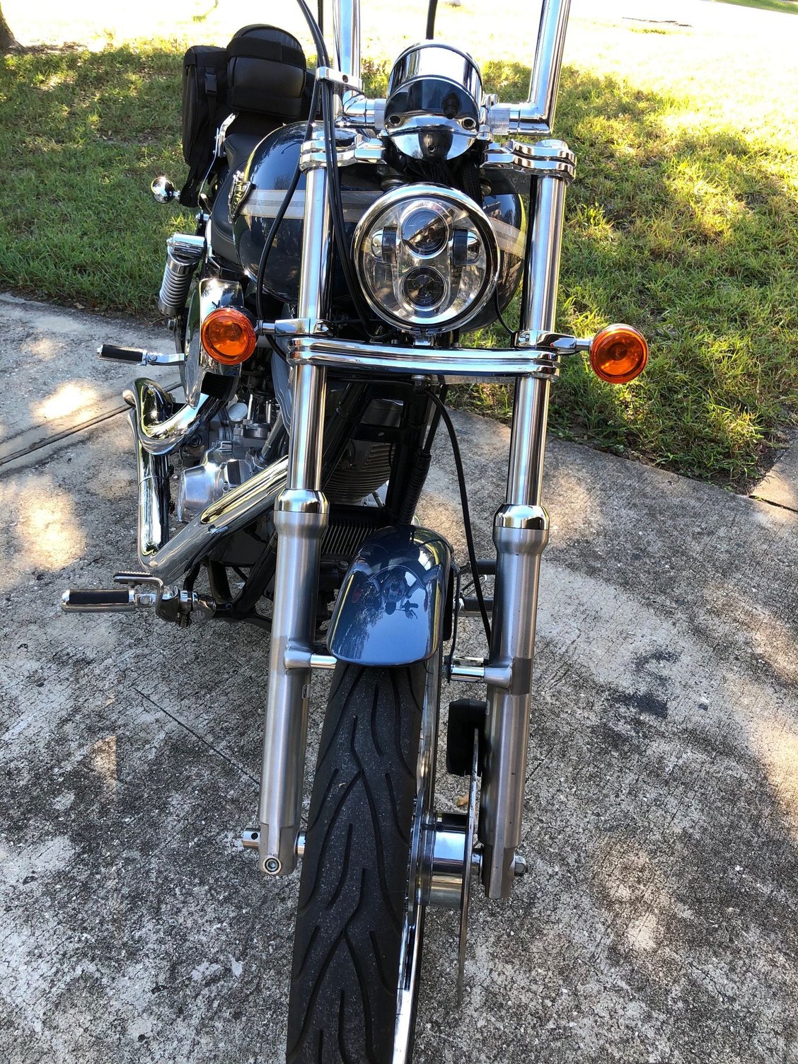

The steering damper thing recently became a topic at the shop during a "death wobble" discussion.. Ive been riding nearly 40 years and guess Ive always been on healthy bikes or just lucky..?.. Just rebuilt front end of my FXD this week. Installed the accutronix wideglide conversion kit. It keeps the stock rake and uses the 39mm forktubes. I completely reconditioned the forktubes along with progressive springs and 15wt fork oil. I did the complete job because of all the stories of the wobble and potential causes. And like the wideglide front end much better. This seems to be a good forum for help, advice, and just good conversation. Please forgive this newguy for running with the thought. Can anyone tell me how to add an avatar to my title ? Thanks

To me its like this, and I'm not an engineer or anything but i have spent my life as a contractor building stuff, when you have something that pivots and that something that pivots is wider than the point it pivots, it is much easier to hold it steady, without binding it, at its widest point, so on a bike it would be the forks. It you think of a damper as something that is limiting shake by dampening it just makes a lot more since to me to do it at its widest point.
If you put one bolt that connects two pieces of perpendicular 2x4's in the middle at the connecting point it doesn't matter how tight it is that sucker is movin, put a gusset 2" out that connects the 2 pieces it is strong as ****, 5 " out even better
plus I just think they look cool
