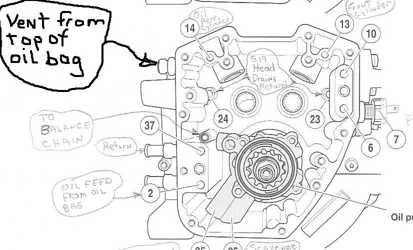

A twin cam oil diagram

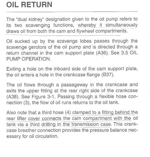

Please explain...
I looked at the EVO and others with the lines and they are all similar enough. Most all my pictures showed the lines coming up and then disappearing behind and you only see two coming in/out the top. My TC was the same design but a lot clearer.
