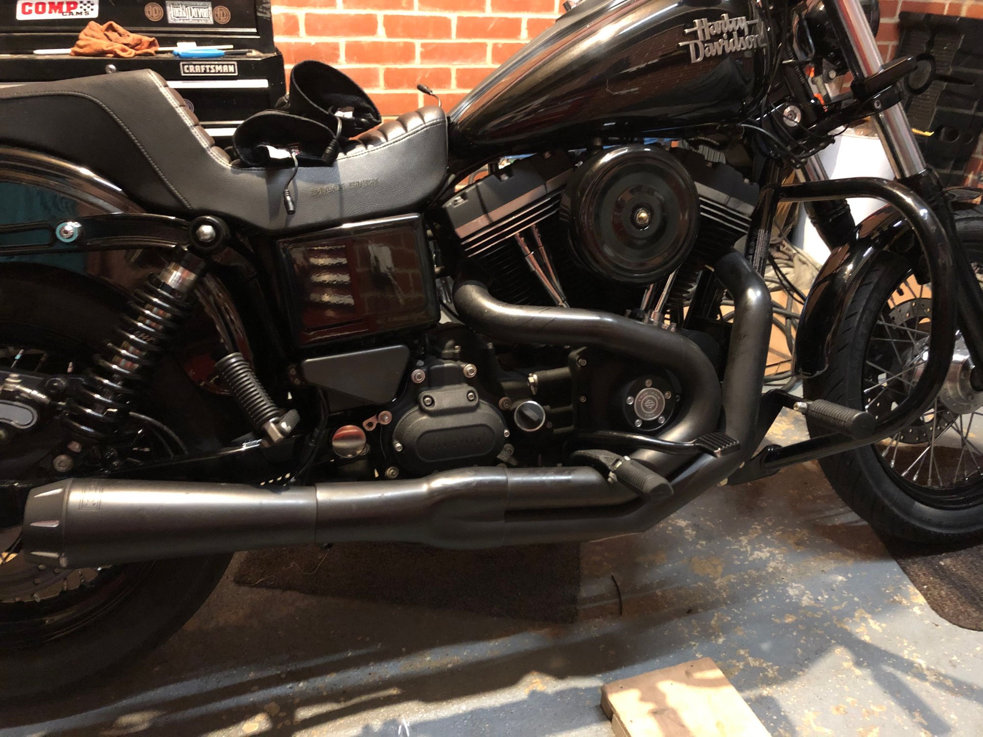

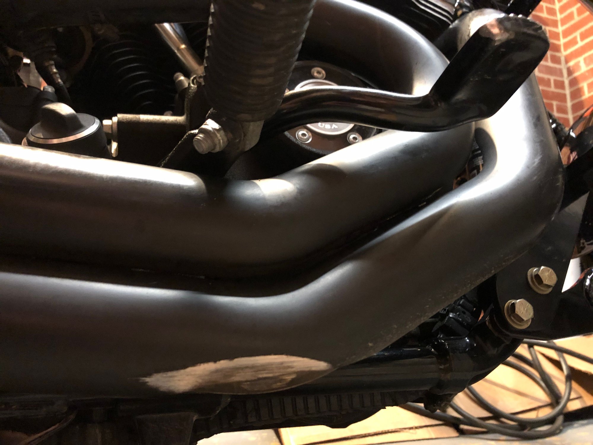

I have the pipe and my only gripe is the ground clearance. I have 13 inch shocks with mids and I scrape quite a bit because how the pipe goes under the controls. You will get a better lean angle with other models.

My is a 2013 street bob running metzeler cruistec tires.

The heat shields are the issue. On a rr3 it’ll be a little harder to scrape since they don’t run full shields. Honestly those riders who scrape will scrape anyways since they are in the 5% of extremely aggressive riders. 13.25 shocks and have about an 1/8 in of chicken strips on my rear night dragon no scrape yet
