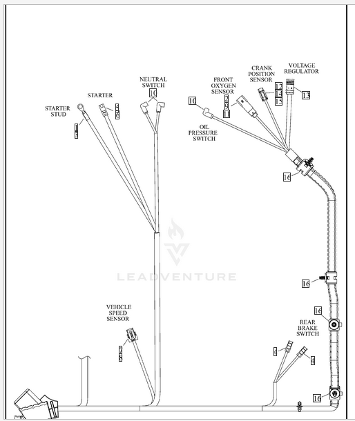

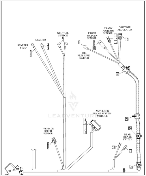

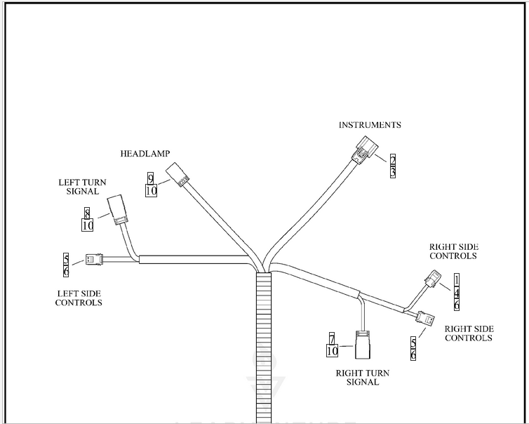

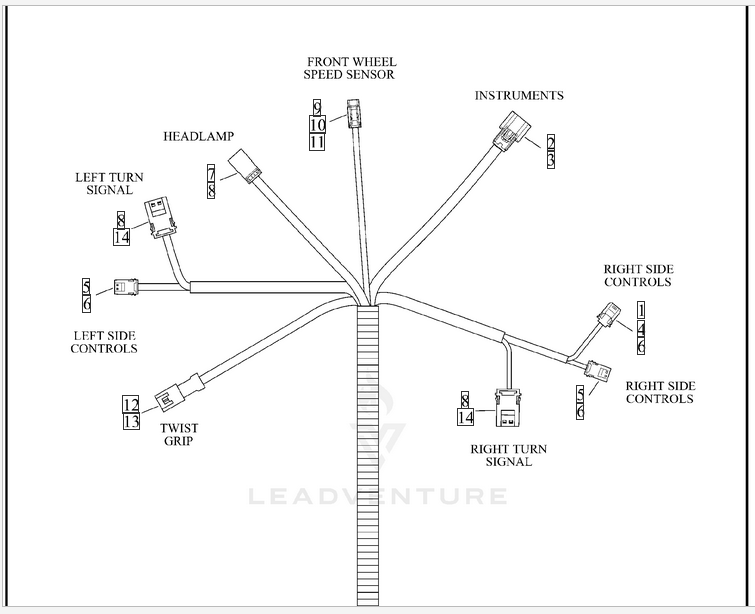

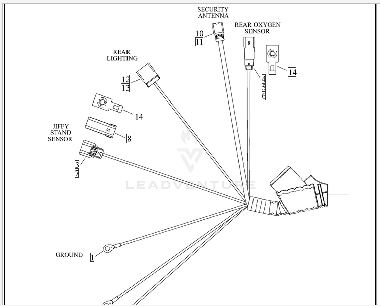

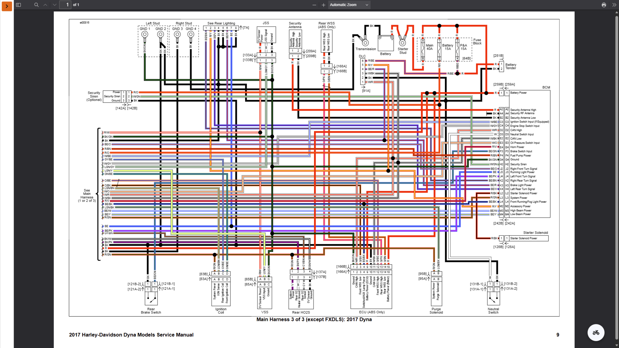

For anyone that wants to play along, here's some more analysis. Comparing the harness in the major areas of impact, there are others, but I used all the available space in this one post. It's becoming pretty evident that not only is this possible but could also be done without replacing the whole harness. Those of you that follow my posts know that I would NEVER patch in a bunch of wires jumping to the ECM, but you know, just saying, it could be done.
It also looks like I'd need to get speed sensors installed also or deal with CEL codes, same might go for ABS? Whatever, I'm going to post this before I lose all my hard work.
FXDB Induction harness
FXDLRS Induction harness
FXDB Hand control harness
FXDLRS Hand control harness
FXDB BCM/ECM harness
FXDLRS BCM/ECM harness
FXDB Rear wheel harness
FDXLRS Rear wheel harness

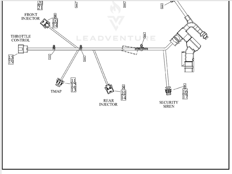

This is the only remaining difference that I've spotted so far, obviously more detailed analysis needs to happen before decisions are made.
FXDB Engine harness
FXDLRS Engine harness

More clearerer information.
EDIT: The front lighting and hand control wiring referenced in the diagrams below does not differ for TBW/Cruise control equipped bikes. As far as I can tell those connections are routed through the bars and meet the main harness in the backbone. Same goes for ABS and speed sensors, there are no sub-harnesses.
FXDB
FXDLS
FXDB
FXDLS

I noticed something else while comparing schematics, looks like I'll need a FXDLS speedo too, the part number is different and I'm guessing it's because there's a cruise control indicator on the bezel.
