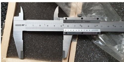

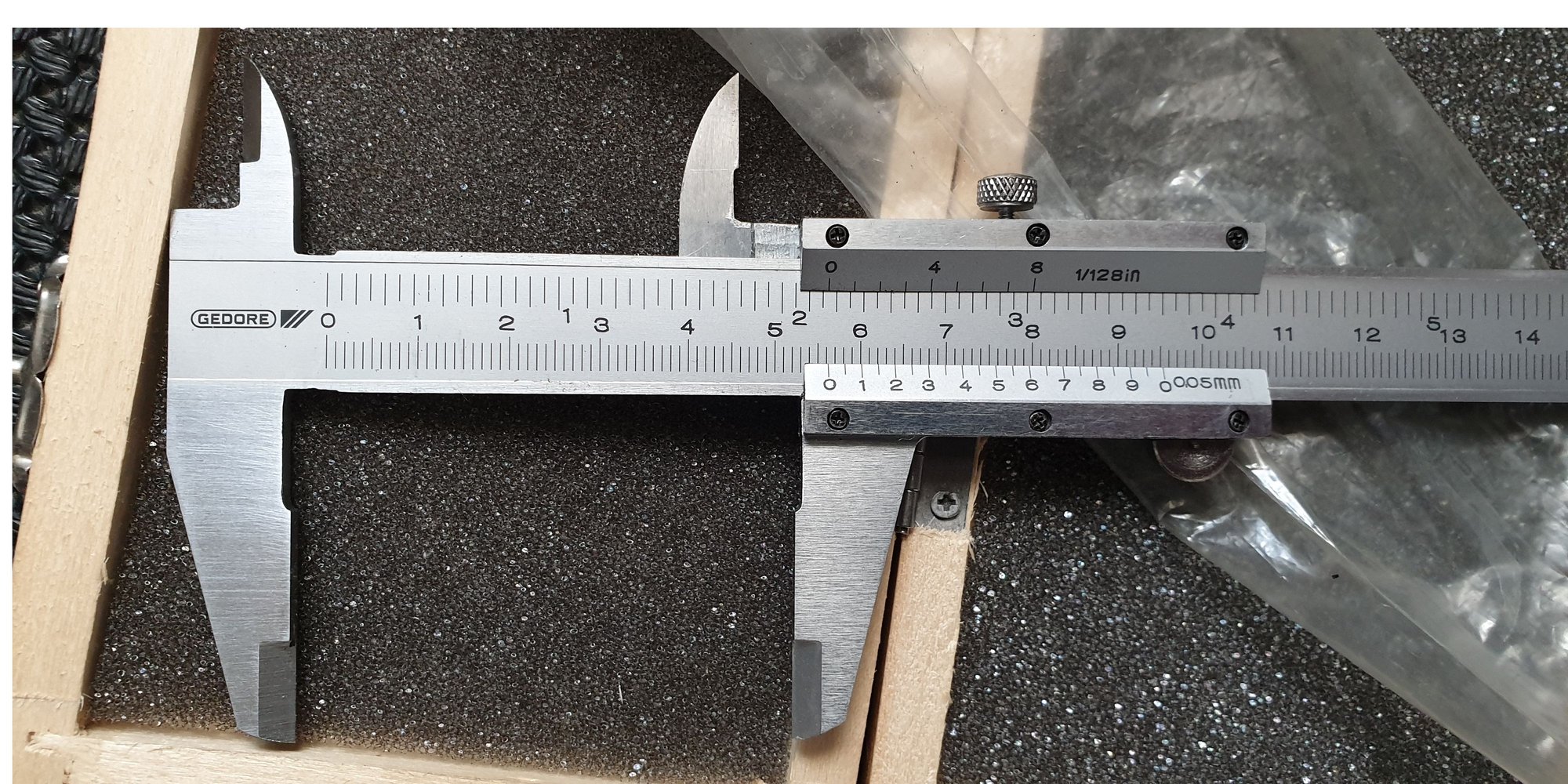

Here's an image of the actual measurement on the r/h side of the front wheel hub on my '03 FXD...

Forgot to add FXD2003Rider ...
Your picture of those particular calipers (and Not that they are Vernier) and with an "Actual" measurement gave me a chuckle ... (and others who do precision measuring in the U.S.)
