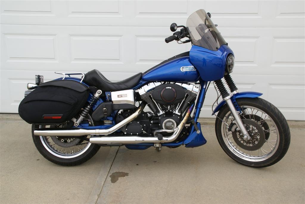

That's what I did. Truly wish I had gotten weights but I spaced. It's a marked difference, With rotating mass, the closer you can keep the weight to the axle, the more pronounced the effect.
