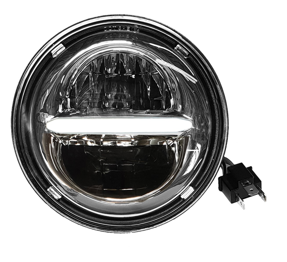

After riding my buddies bike with an LED headlight, I knew it was time to upgrade mine. I could see so much better at night. The only problem is that I love the look of my street bob's stock light... nothing fancy.

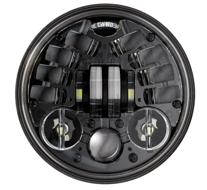

All the LED headlights I see either look like R2-D2 or a robotic spider with like 8 bulbs or a halo or something. They just wouldn't look right with what I'm going for (I know I'm stubborn).
Does anyone have any suggestions for any headlights that still have that stock/classic look? Or are thaere any LED bulbs that I can just replace the stock bulb with that make a significant impact? Check out the pictures below for more detail. Thanks in advance for the help.
~ Blaque
What I have
What I don't want

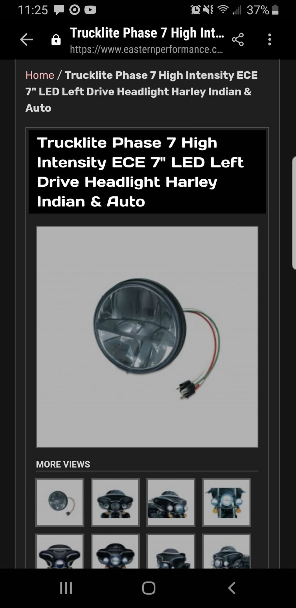

The closest thing I've found so far

I know what you mean, I put a set on my Heritage and I'm not crazy about the look but because they are lights I went with funtion over style. The old design had me replacing bulbs every 6 months.

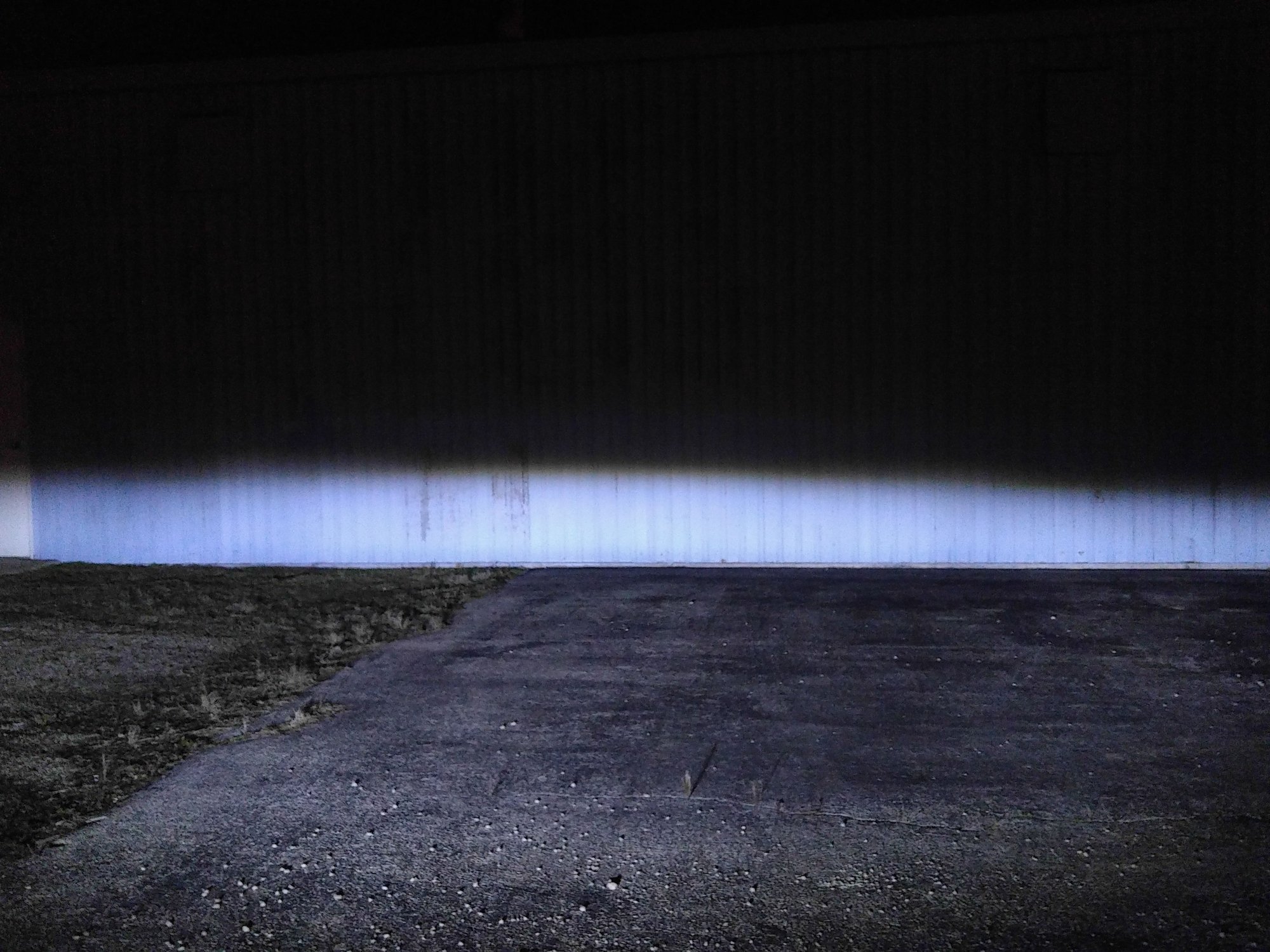

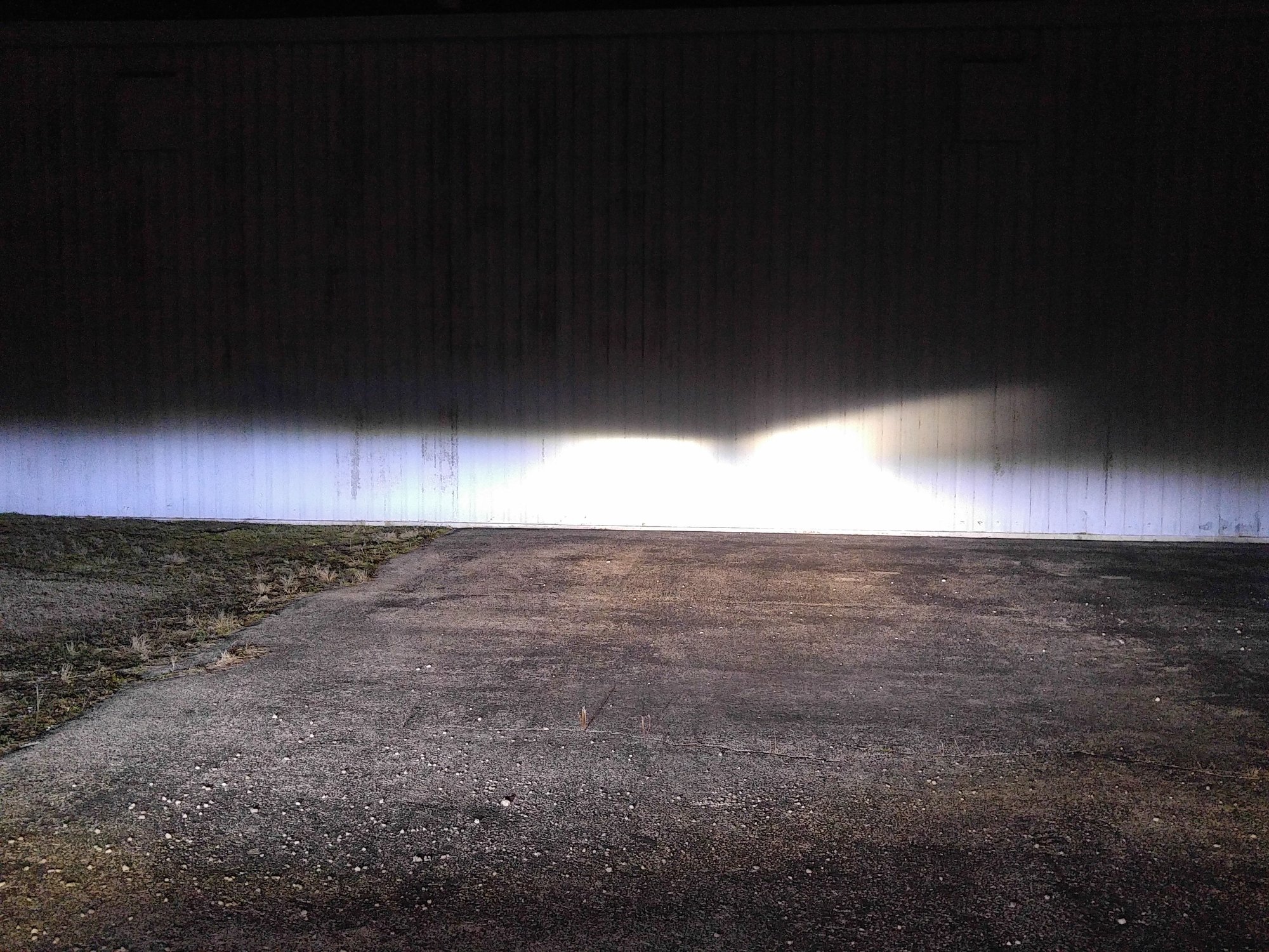

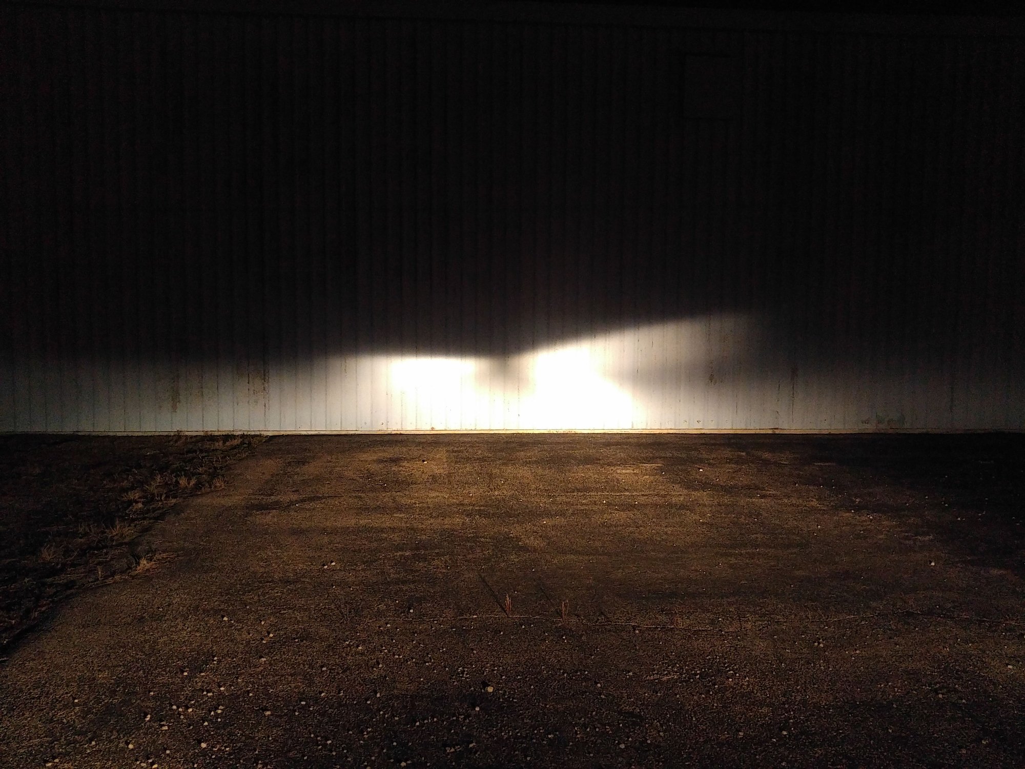

One style or technology is not automatically better than another and brighter is not better without a good beam pattern.
Lots of LED bulbs and replacement housings boast super high brightness but can't put that light into a usable pattern. 10k lumens is useless if most of the light is in the trees and/or at your feet and those setups blind oncoming traffic.
Here is a comparison I did between a very good halogen setup (Cibie E-Code w/ Philips +130) and a decent LED (Clone Speaker 8790A)
about 25' from a white-ish warehouse wall...
Speaker Clone.
Cibie / Philips.
Both at the same time.
These are both low beam. I absolutely LOVE the Cibie/Philips combo. The clone pattern is too wide to be properly bright down the road. The Cibie has that "wing" that cuts up to right and really makes signage pop while the other half of the beam is just wide enough to fill the road while projecting way out there. I am still planning to get the genuine Speaker 8790A in the hopes that it performs better than the clone as I think the adaptive feature is better suited to bike dynamics.
