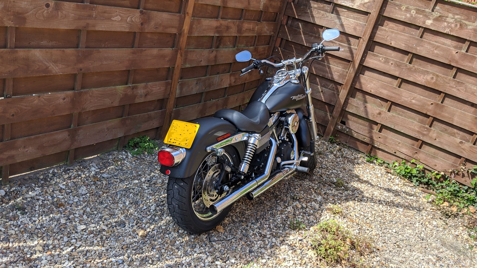

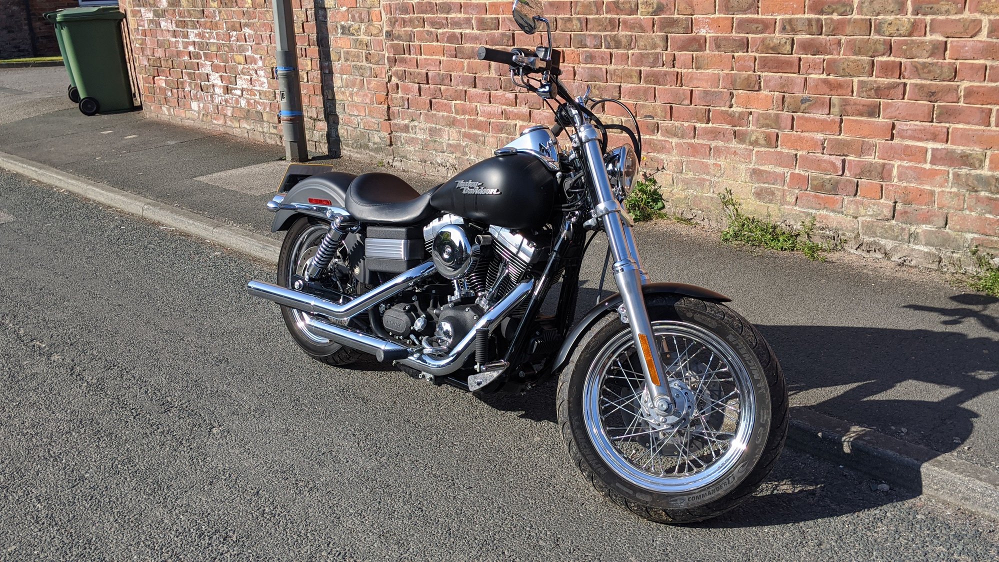

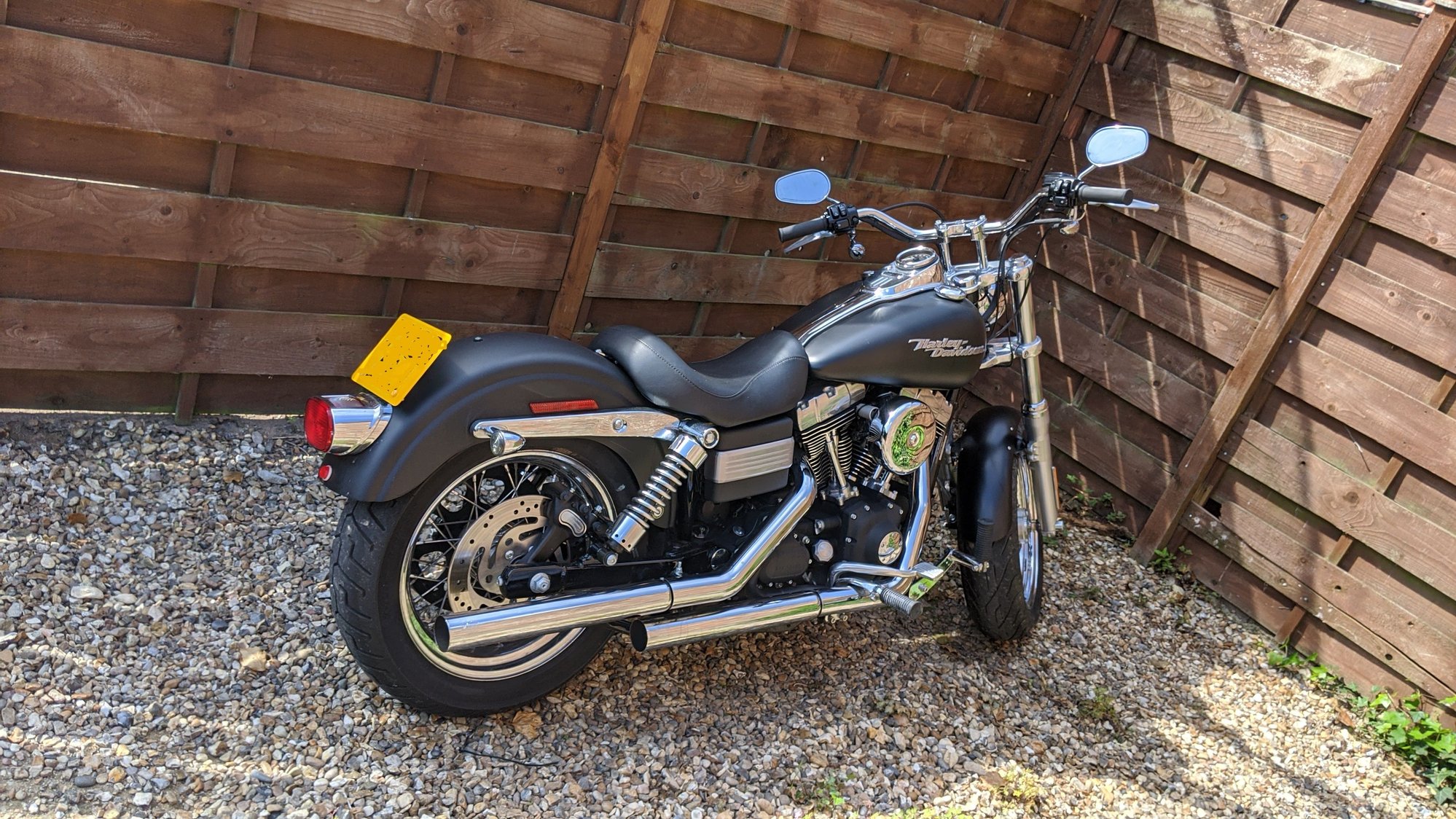

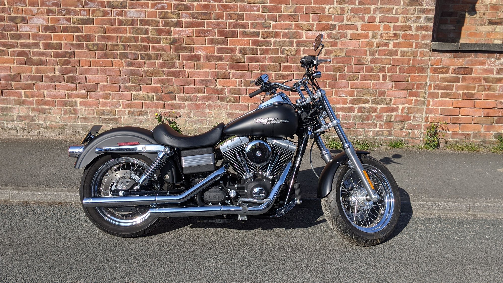

First time posting pictures on here so hope it works. Sailed through the MOT so back out on the road-ish

Look cherry, man! I bet the inspectors had no idea it's a custom.

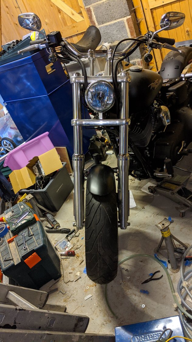

Old May 9, 2020 | 08:10 AM
Limey's Avatar
Limey
Joined: May 2007
Posts: 344
This is the only one I have head on at the moment, in my very messy garage. I was a bit worried that the testers would pick up on the front fender which is slightly narrower than the tyre but they said nothing.
