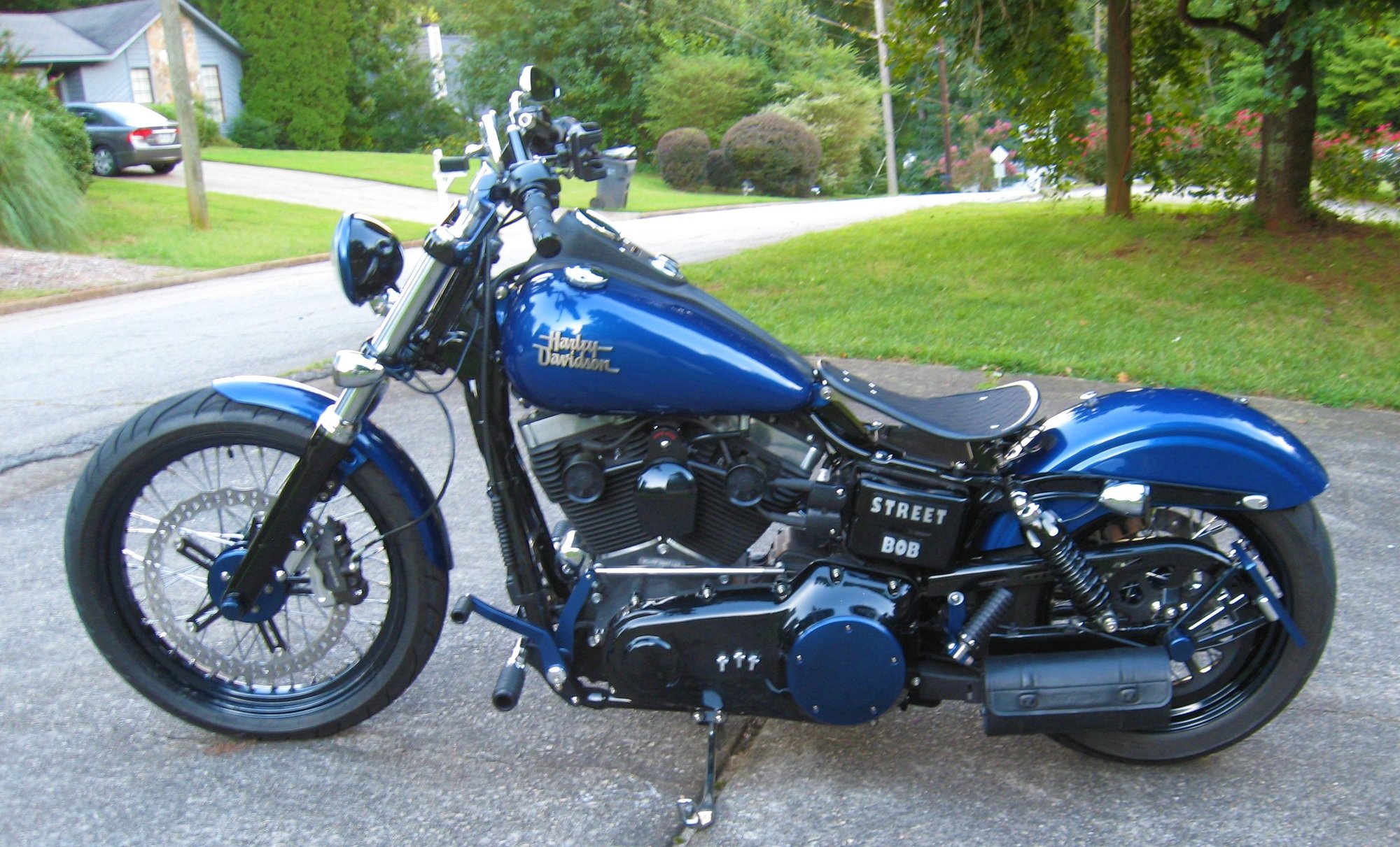

Originally Posted by Blue Bob
There are probably thousands of people who just cut the shaft myself included.
Yes I have heard the horror stories of not being able to find neutral with the wrong shift arm.
I have never had a problem finding neutral.
I did change the outer cover along with a custom derby cover.
Just sayin
Blue Bob, I never get tired of looking at your bike!

Blue Bob's Avatar
Blue Bob
Joined: Jun 2017
Posts: 1,705
Likes: 1,017
From: Lawrenceville Ga.
Originally Posted by snake_eyes
Yeah man, good on you. That's the kind of thing that would bug the **** out of me on every ride...knowing that I half-assed it.
Well thank you....thank you very much!
I promise this brief "thread hijack" is done know, but for the record: Your bike and Chris's bike (cggorman) are always treats to look at. Obviously there are tons of really nice rides here in the forum, but I always get lost in little details on both of your bikes. There's an endless list of fascinating little things on both of them... The kind of stuff that's obviously a labor of love on the owner's part, because a casual observer probably never notices half of it. But those are the kind of detail on cars and bikes that always leaves an impression on me.
Carry on with the shifter shaft discussion...
