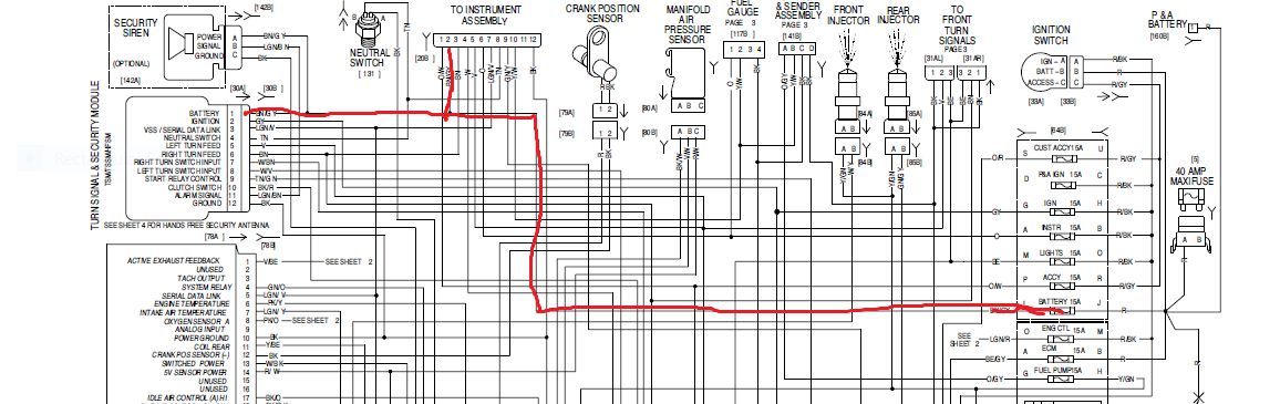

Won't start and everything lights up except for speedometer and security system

Those items are powered by the Battery circuit...
Have you recently done any work on the bike?
Un plug the connectors for the instruments and TSSM.
Look for chafed wires (Brown/Grey).
See if the fuse pops when ignition is turned on.

Blown fuse indicates a short somewhere.

All you can do is disconnect plugs and reconnect one at a time till the fuse blows that will give you the circuit to check. Your manual will tell you whats on that circuit.

I'm not sure what you mean by a battery fuse. There is no fuse for the battery itself.
You can find the fuse diagram on the inside of the fuse box cover.

There is a fuse and a circuit named "Battery"...
As I said in a previous post, the circuit powers the speedometer and the security system.
