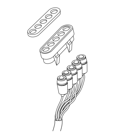

On FXDL models, the lamp trim is a snap fit and must be carefully pried out of housing before lamp can be pushed out of socket.
You're a saint, FXD2003Rider! Where on earth did you find this diagram?? Thanks!!
In my 2003 Dyna Models Service Manual.....
