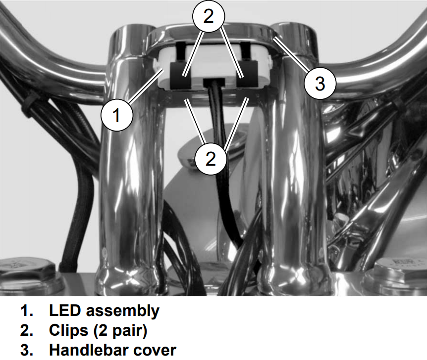

I just noticed your bike is an '08 FXDL?
Removal:
1. Pull riser cover from between handlebar risers.
2. Squeeze clips (2) together and gently pull LED assembly (1) from handlebar cover (3).
Installation:
1. Install LED assembly (1) into handlebar cover.
2. Engage clips (2) into tabs on LED assembly.
3. Install riser cover between handlebar risers.
