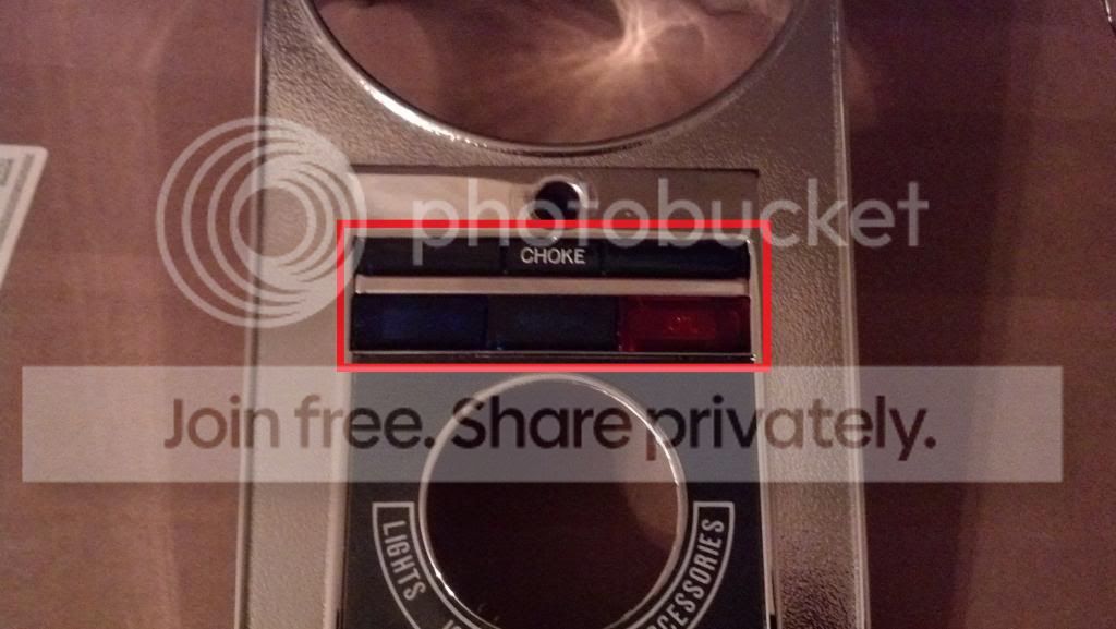

First off, this is the area I'm talking about on the dash, highlighted in the red rectangle. This is the old style dash, with the giant plastic indicator windows. for the record, my choke is relocated, because I have an S&S carburetor, so the hole just above the lights is no longer for the choke, just for a stud and acorn nut.

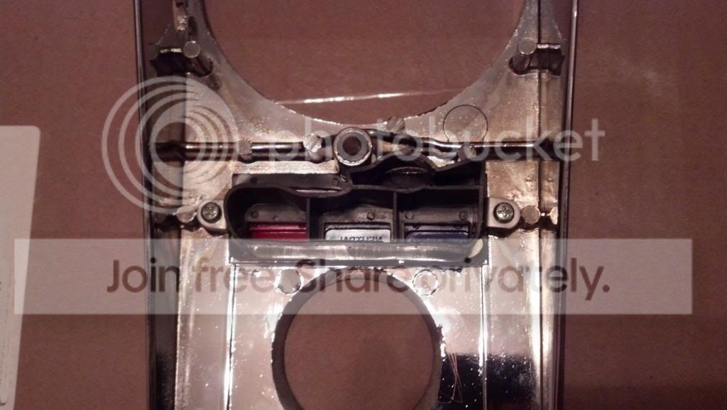

Now, if you flip the dash over, you'll see a giant rubber piece that is meant to keep the lights from bleeding through to one another (which doesn't work all that well). The rubber piece has sort of a hard face to it (not sure if there's a metal or plastic plate in there) that is held in place with two brackets and two Phillips head screws.

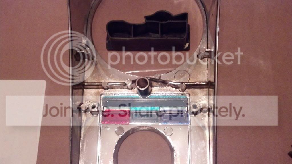

Now, with the rubber piece removed, you can see that it just presses up against the colored lenses, and a little chrome bar that splits the two rows of lights. There's nothing that holds the plastic lenses in besides just being sandwiched in place by the rubber piece.

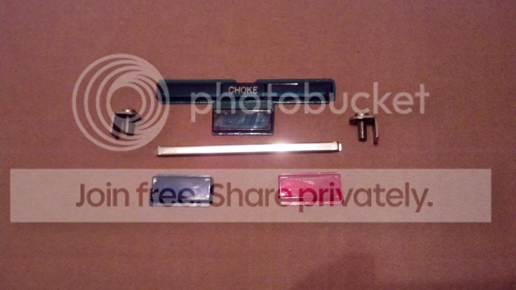

Here's the plastic lenses, the chrome bar, and the brackets and screws

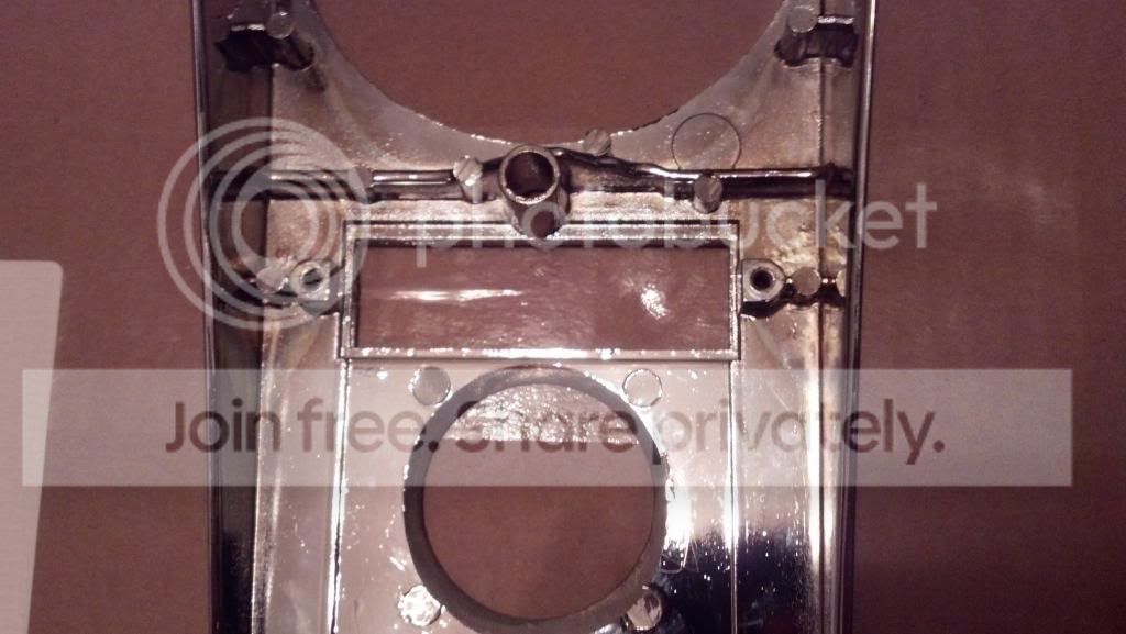

Here's what the underside of the dash looks like with all of it removed. You can see that it's a stepped opening, so there's a sort of rim around it. The lenses are cut to have a little flange around them, so the main part fits through the smaller part of the opening to go through to the front side, and the flange sits in the larger part of the opening in the back side. The rubber piece keeps them from going inside the dash, and the stepped flanged opening keeps them from coming out the top.
From the front side, you can see the nice, neat, rectangular opening. My idea is to find some type of a plate that will fit all the way through the front side of the opening, to sit flush with the top surface of the dash, but have a stepped edge to it to fit the inside lip of the opening. Then I can re-use the brackets to hold it in place.

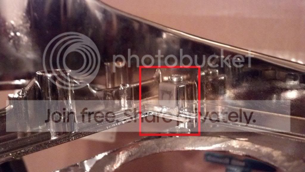

Here's the tricky part, though. Because the lenses and rubber piece are so thick, the brackets don't reach down very far. Any type of filler plate I come up with will have to be thick enough to be held in place with the brackets, or I will need to find or fabricate some longer brackets. You can see the bracket highlighted here in the red rectangle, and see the large gap I'm talking about.
