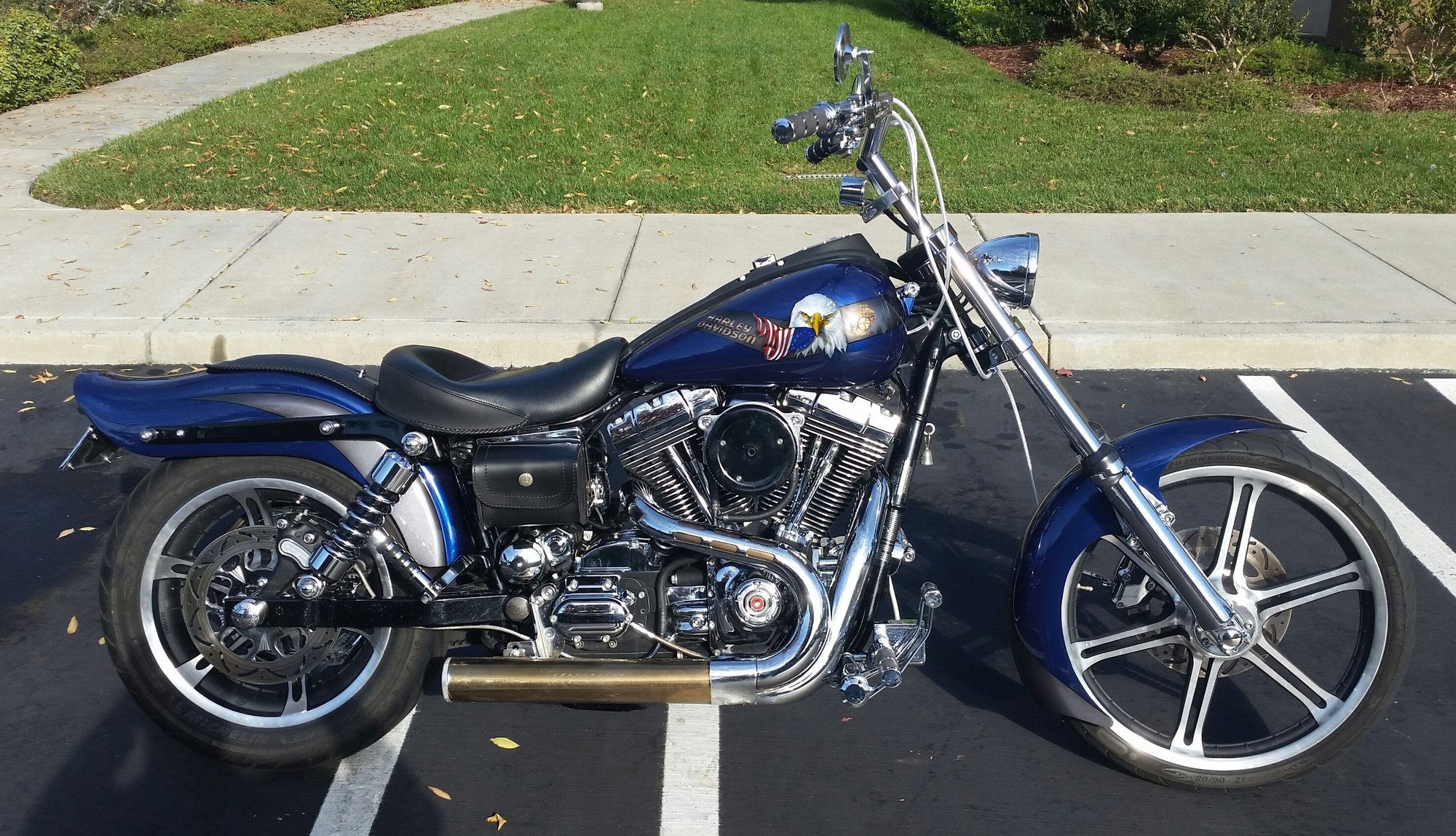

36 degree rake
You can see more here:
http://www.8541hog.net
http://www.8541hog.net/images/pipes1d.jpg

Originally Posted by 8541hog
bike looks great.... that’s exactly the angle I’m looking for ... not to much not to little.....did you get the whole front end forks and all? Or just triple clamps?

Sorry it has taken so long to respond. CORRECTION, my trees are 4 degrees over stock to make it 36 total
I bought the trees from hawg halters and then 2" extended tubes online and can't find the details, other than that all stock up front. Well except for the bars, lights, controls....

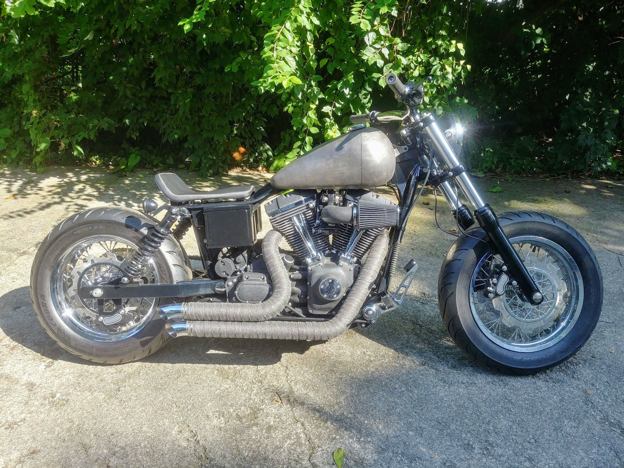

Probably not representative of your goals but I have +2 degree trees and (I think!) -2" length WG tubes on my 99 Wide Glide. The front end is a combination of 49mm ('06+) WG trees and Fat Bob sliders. I assume the tubes are also from the DF but never tried to confirm that since it just happened to sit perfect as I received it. Bought complete, used and poorly described, on eBay.
Regardless, +2 on a 99-05 WG frame:
