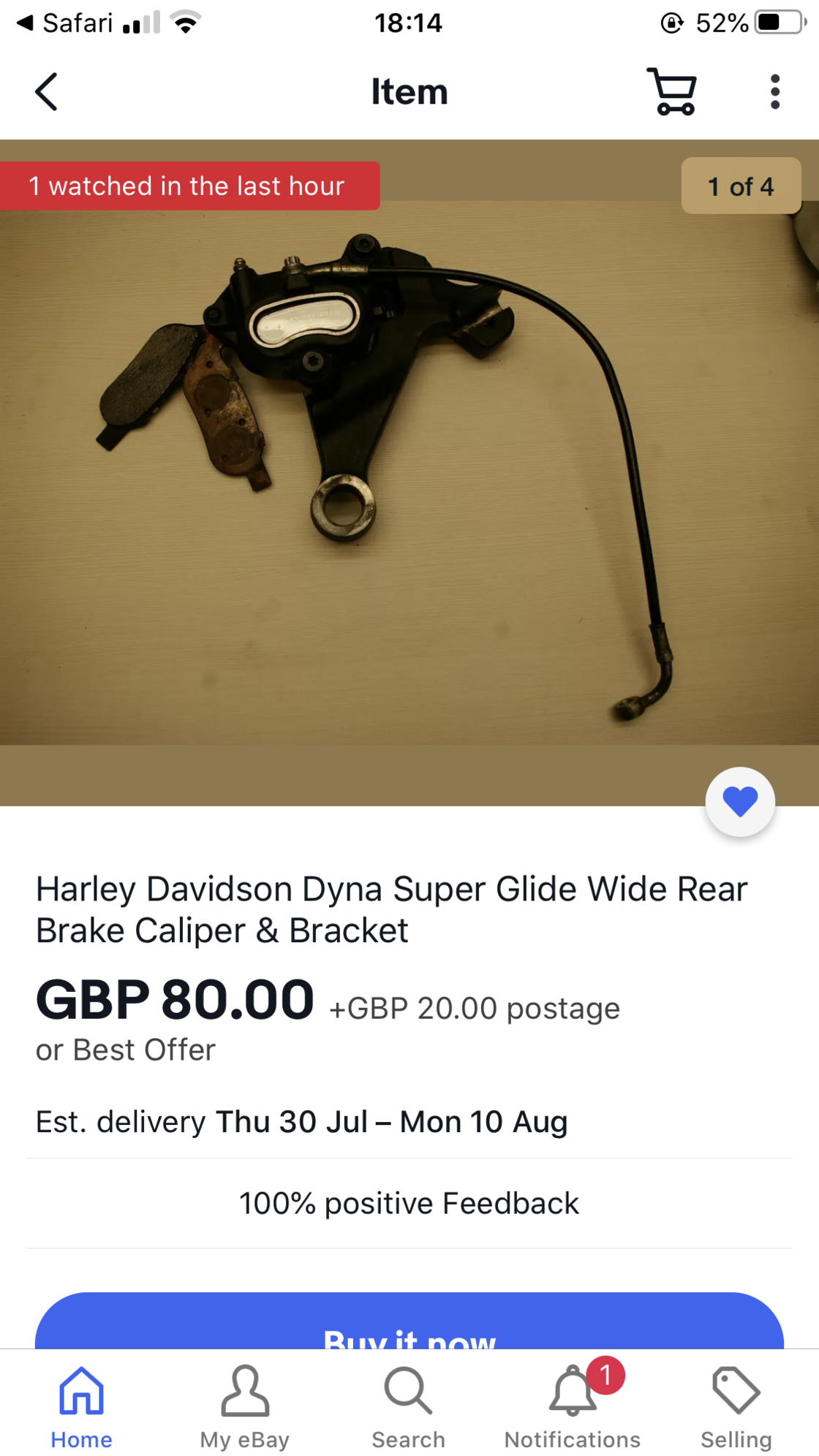

Rear brake keeps binding. Tired of working the pistons with G Clamps. Can I fit a 2000-2005 caliper ? Will it fit straight in. Anyone made this upgrade?
Will this retro fit to an earlier Evo FXD (1997)

It wouldn't be simple. The slider/reaction block on the swingarm is completely different.
Not what you asked, but another alternative.... I switched to a Wilwood GP310 and matching bracket. Works great. Fixed/monoblock caliper and the reaction block can be locked down with a set screw after adjusting drive belt tension and wheel alignment.

To add ... that pic is of a 2008-later Caliper/Bracket ... Not 2000-05
