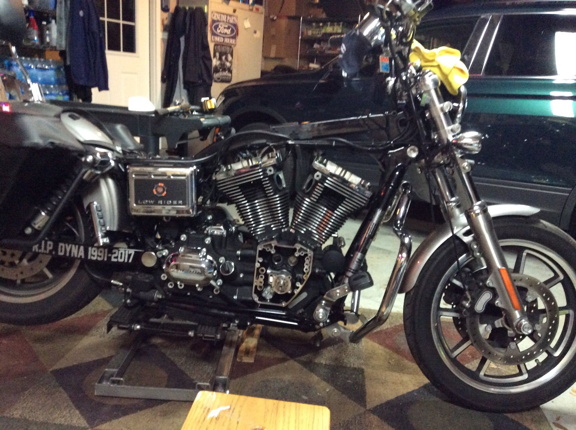

So, I bought this bike new. Over the last year and 4,000 miles. I have had a top end noise. Pretty sure lifters are failing. I tried the rocker lockers, didn’t fix it. Now I am installing TTS 150 cams, S&S lifters, HPI55MF TB and a set of S&S adjustable pushrods. I am also replacing my throttle cables with 4+ inch stainless cables as well as 4+ inch stainless clutch cable.

Before

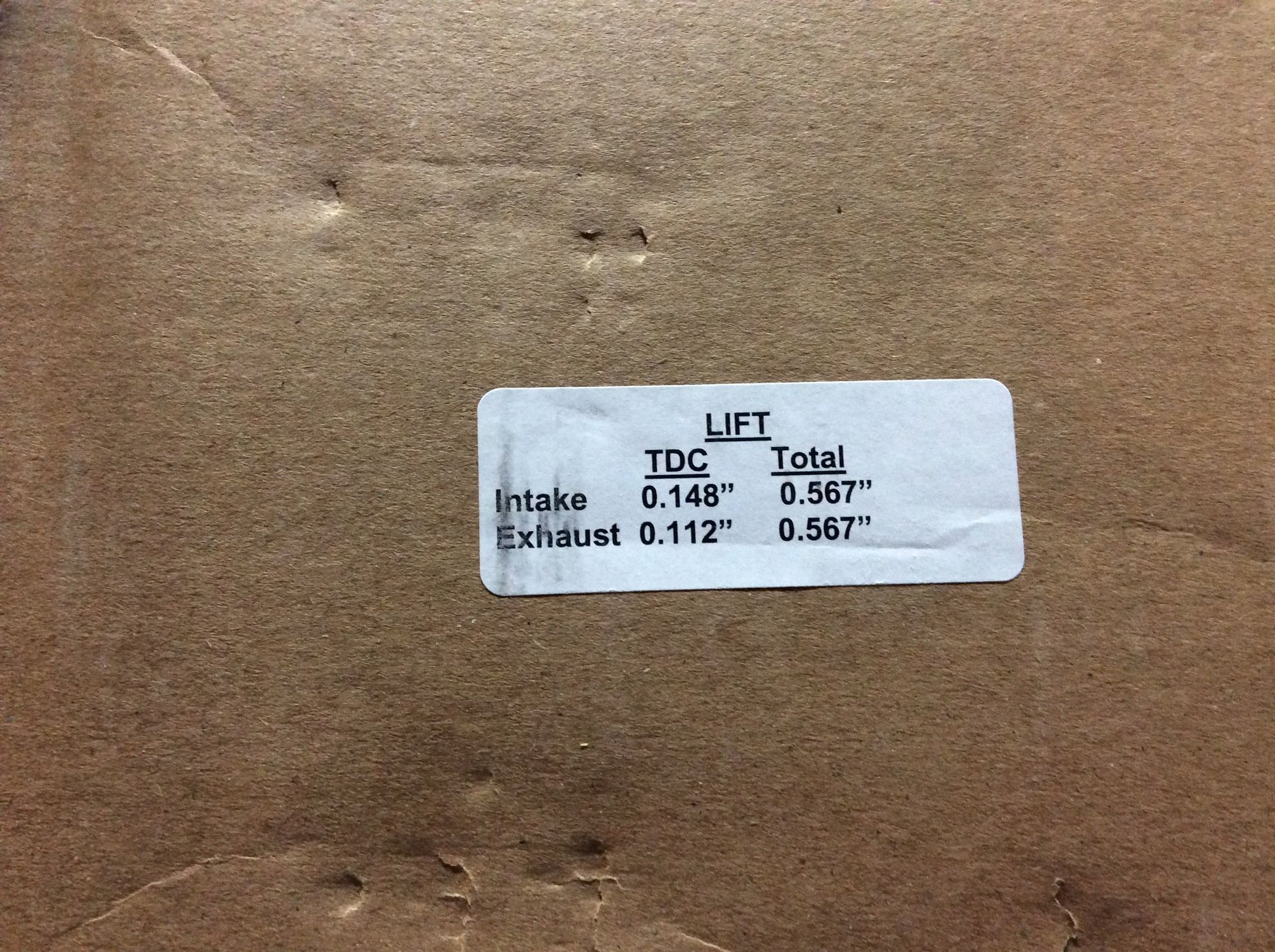

Thanks for the reply, here is the cam specs
