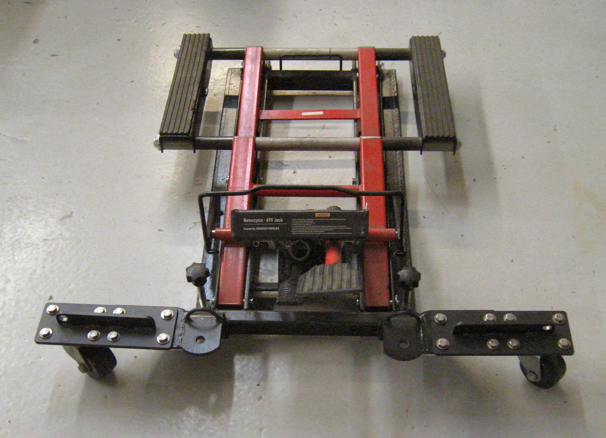

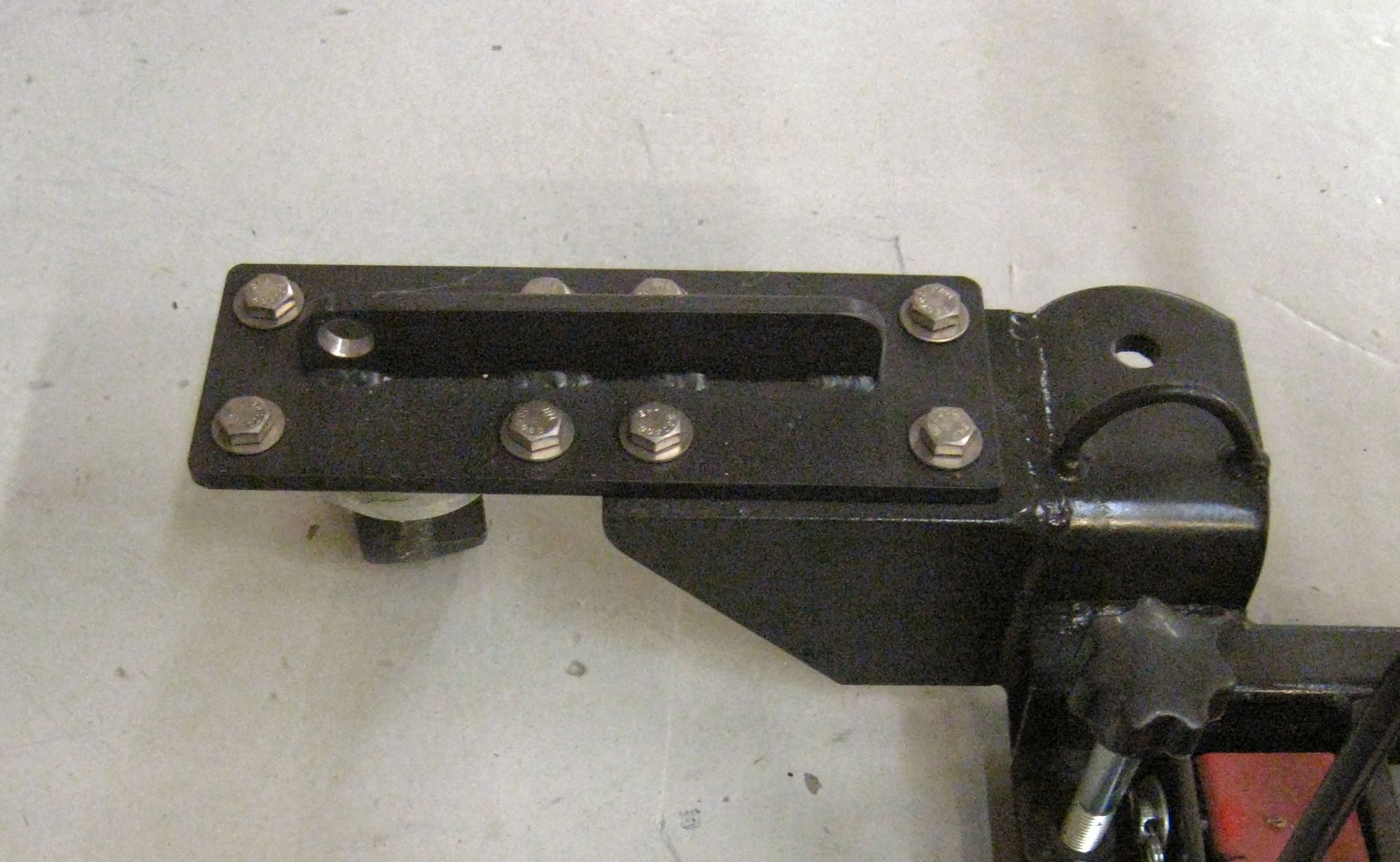

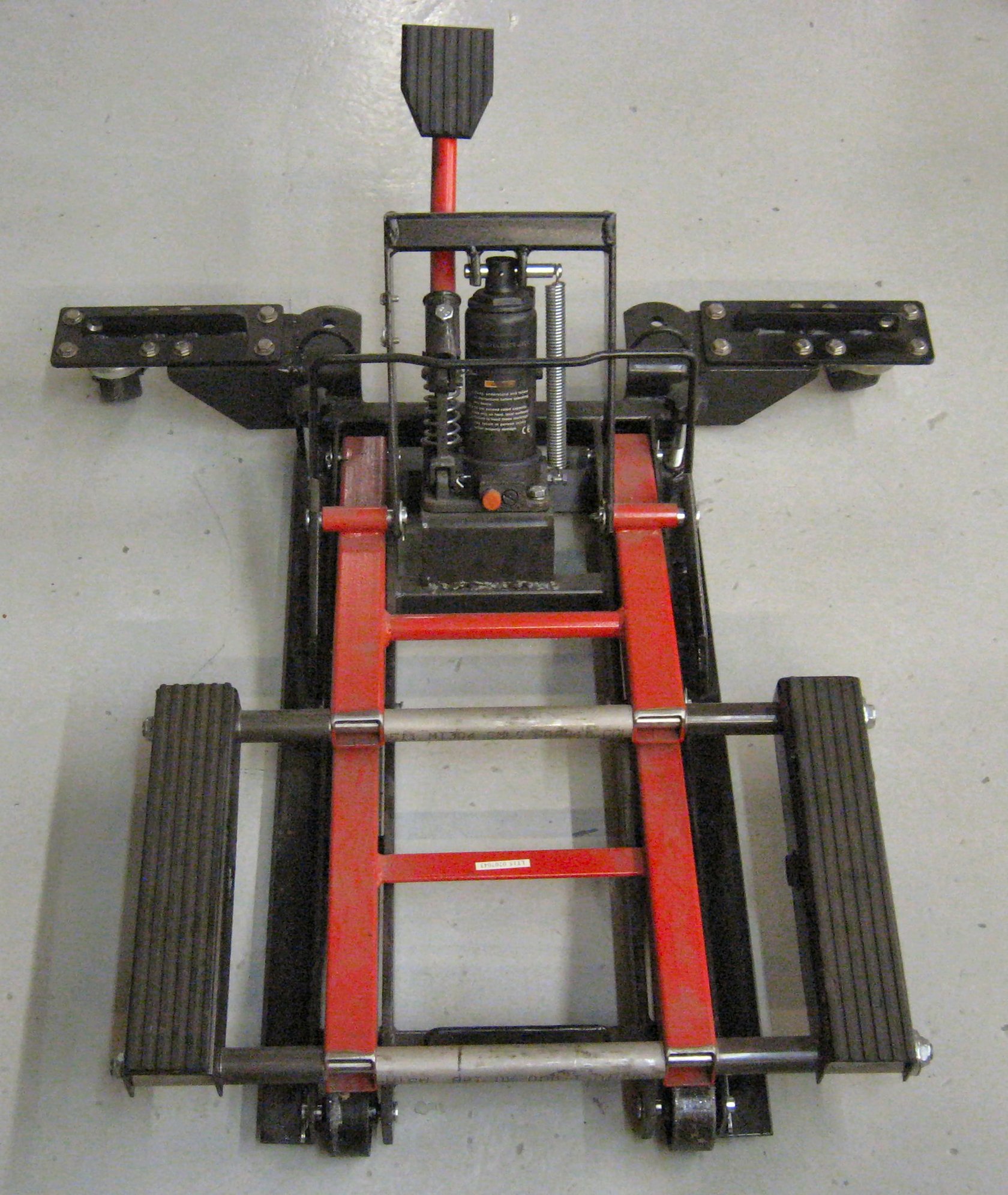

$100.00 Jack....$400.00 in labor

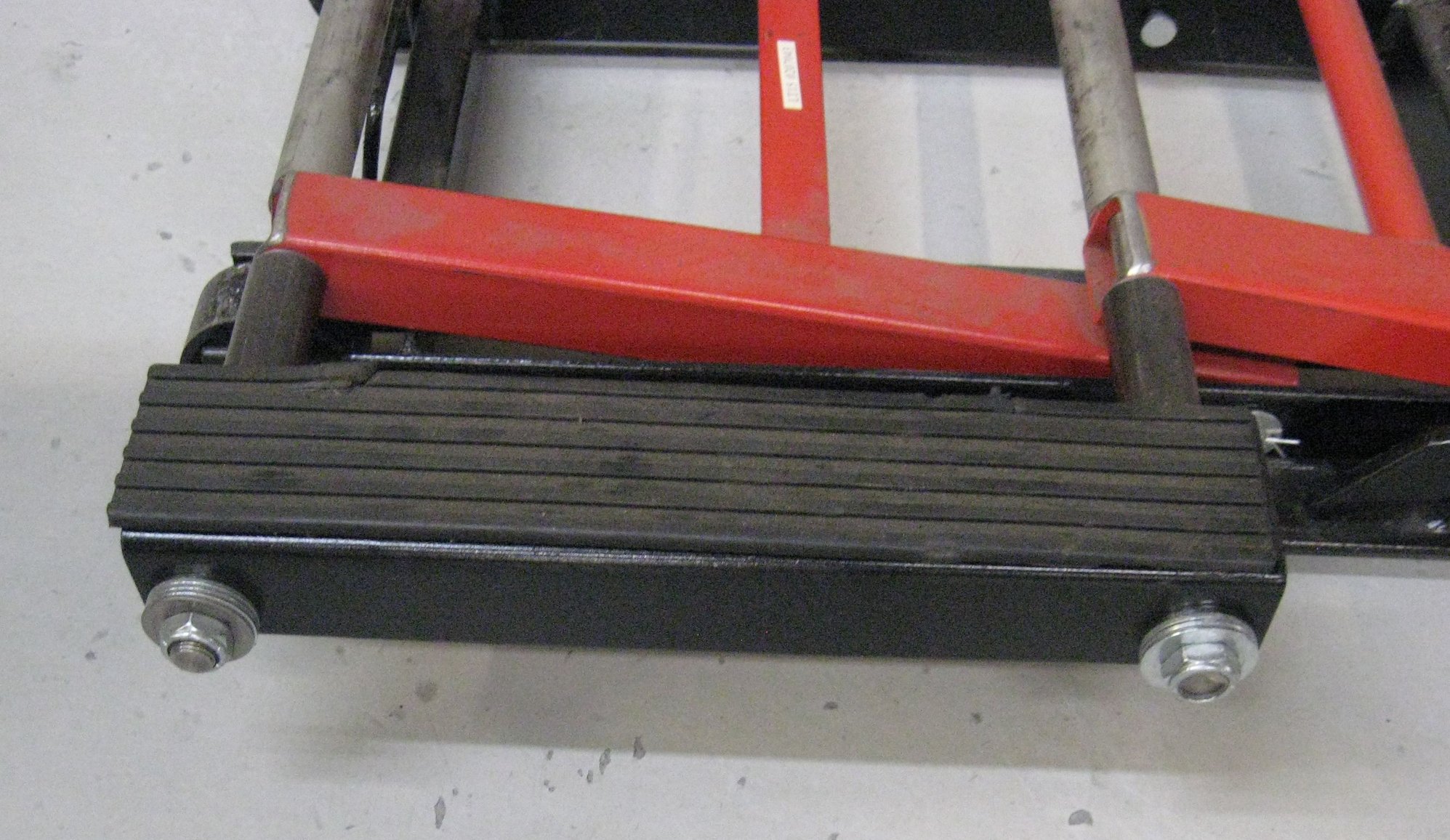

.625" / 5/8" full length rods threaded on each end for pad extensions instead of bolts
Wider rear footprint.
Heavy duty swival casters.
