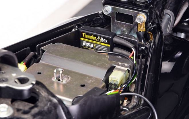

Old Oct 4, 2020 | 10:37 AM
lonbak's Avatar
lonbak
Joined: Sep 2020
Posts: 65
Likes: 69
From: Denmark (Scandinavia, Europe)
This company makes kind of a similar terminal - but surely a lot more advanced than mine.
Its a new 2020 product. I know the company from their gear indicator that i am very pleased with:
https://www.healtech-electronics.com/products/tb/
(my gear indicator: https://www.healtech-electronics.com/products/gipro/gpxt/)

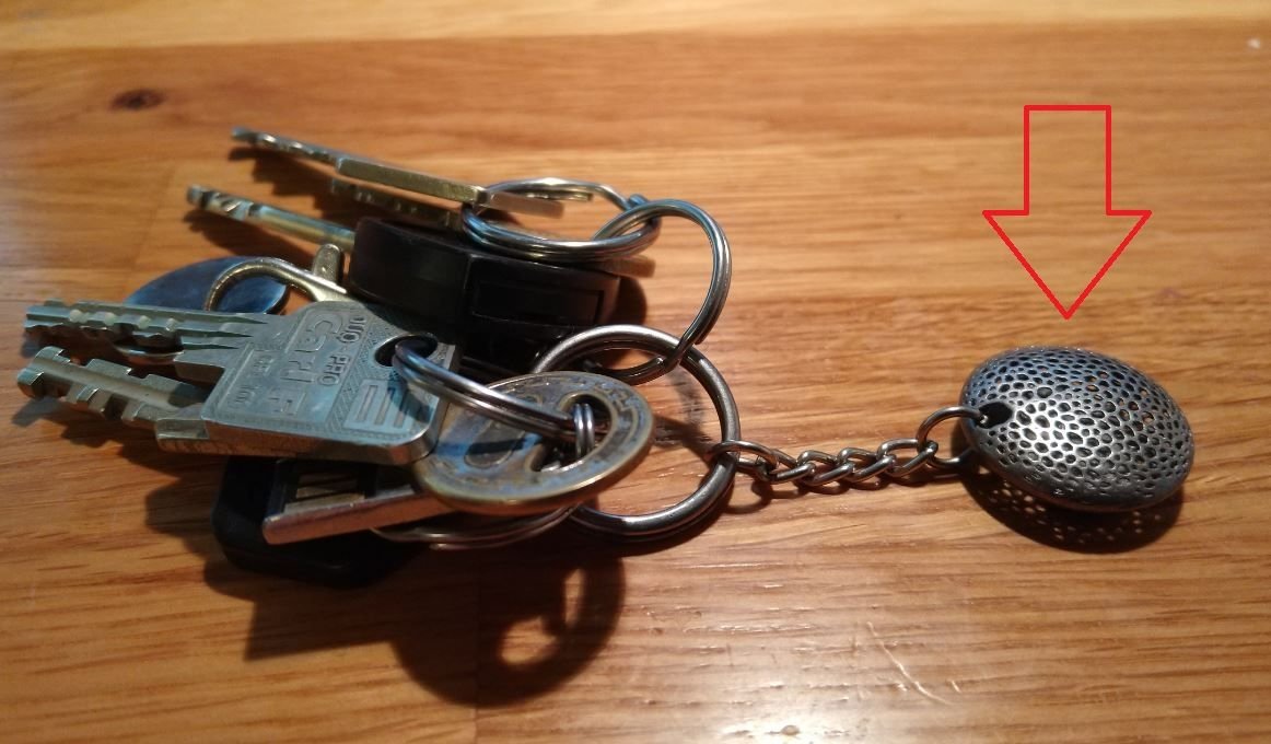

Old Oct 4, 2020 | 01:33 PM
lonbak's Avatar
lonbak
Joined: Sep 2020
Posts: 65
Likes: 69
Originally Posted by cggorman
Thanks. I thought it looked especially nicely printed. Assuming nylon as stated, I'd guess it's SLS (laser sintered). Good stuff.
Sure, you're right, its laser sinteret.
They print parts out of titanium powder also.
Below titanium printed hollow part - quite impressive :-)
