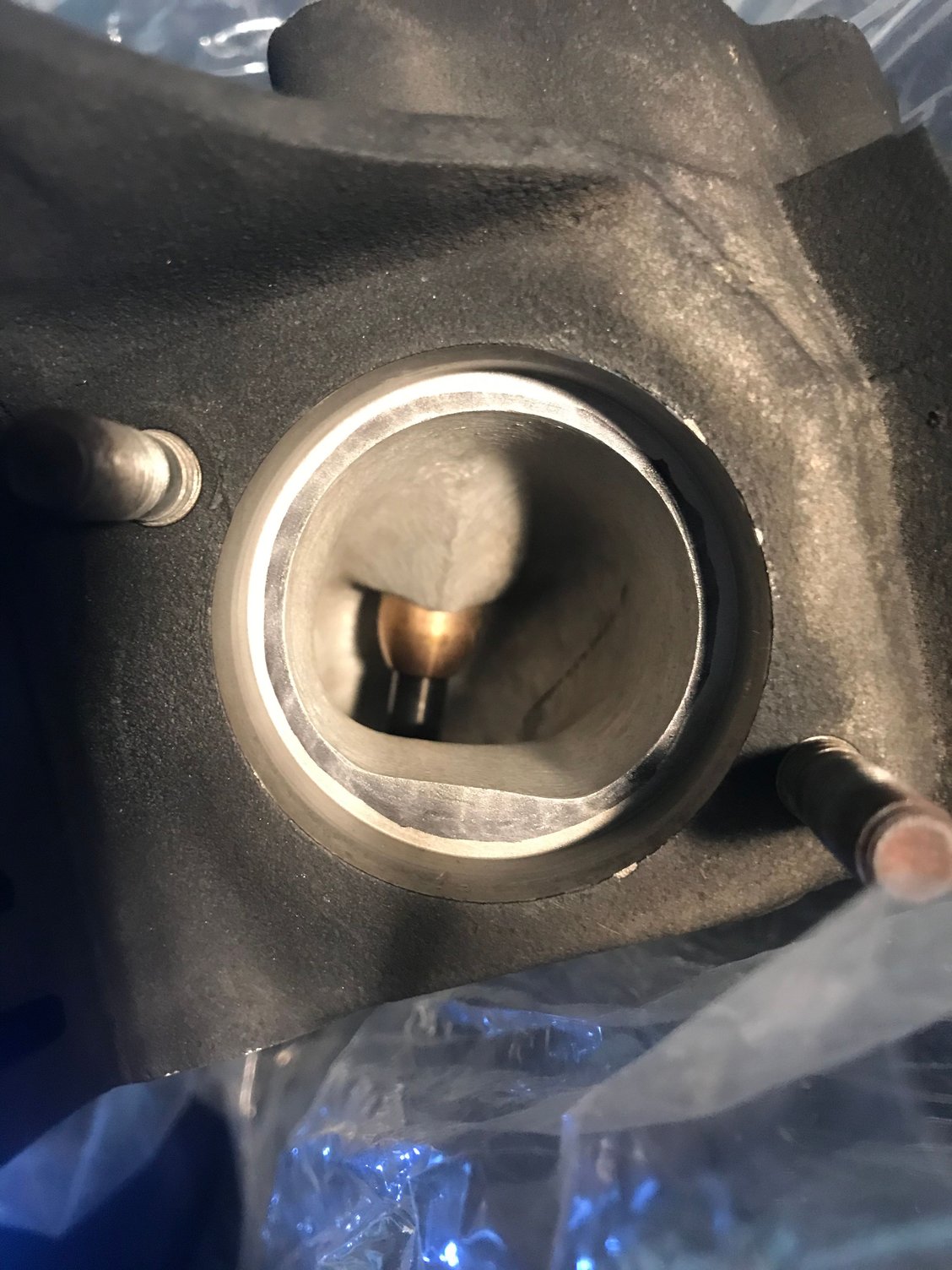

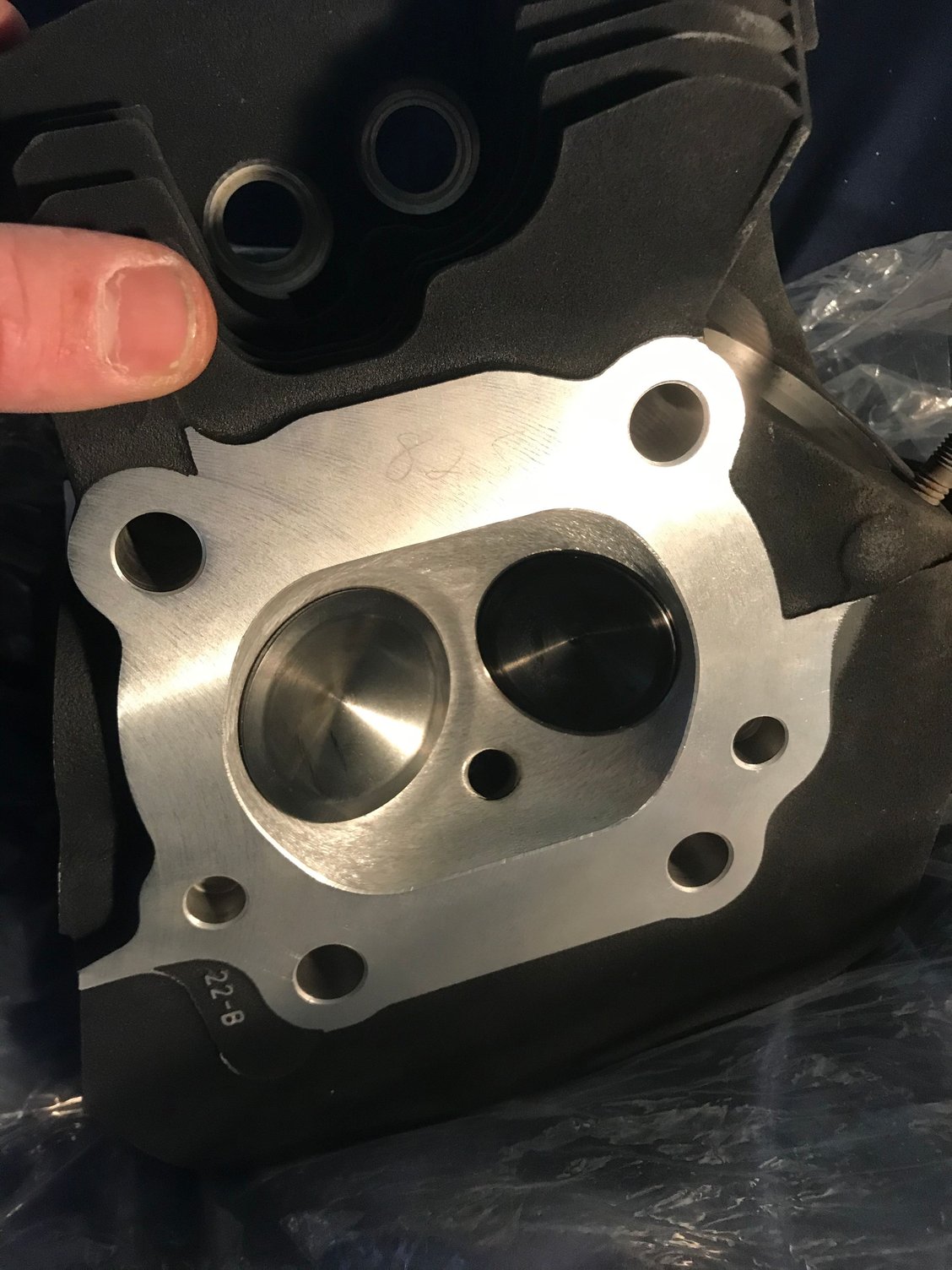

Just had my heads ported and I see some imperfections is that normal?

Looks good to me.

The 82.5 penciled numbers, is my handwriting.
Those heads flowed very well when checked on our Superflow 600.
Scott
Scott
Thought the unshrouding looked familiar..... Still waiting to hear from OP on what looked imperfect.... Older heads without ACR's, surprised no MCR's

My bad guys the heads look great I’ve near had any head work done befor and was curious thanks for all the reply’s I can’t wait to put it together and have it tuned

I think a lot of people mistakenly think ported heads ports and chambers should be polished and shiny, which is not the case. No doubt you'll be happy with the numbers you get with those heads provided they're paired with the correct supporting parts.

82.5 cc is small.. Is that for a 96" and what is your compression goal and the rest of the mods?
98” plus 8.5 cc pistons s&s 570 ez start cams Arlen Ness monster sucker Bassani road rage two mega power exhaust se cam plate kit powerVision tuner stock injectors throttlebody will be upgrading throttlebody soon
