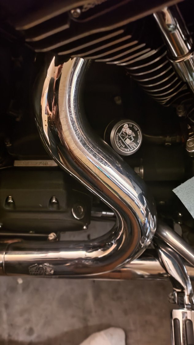

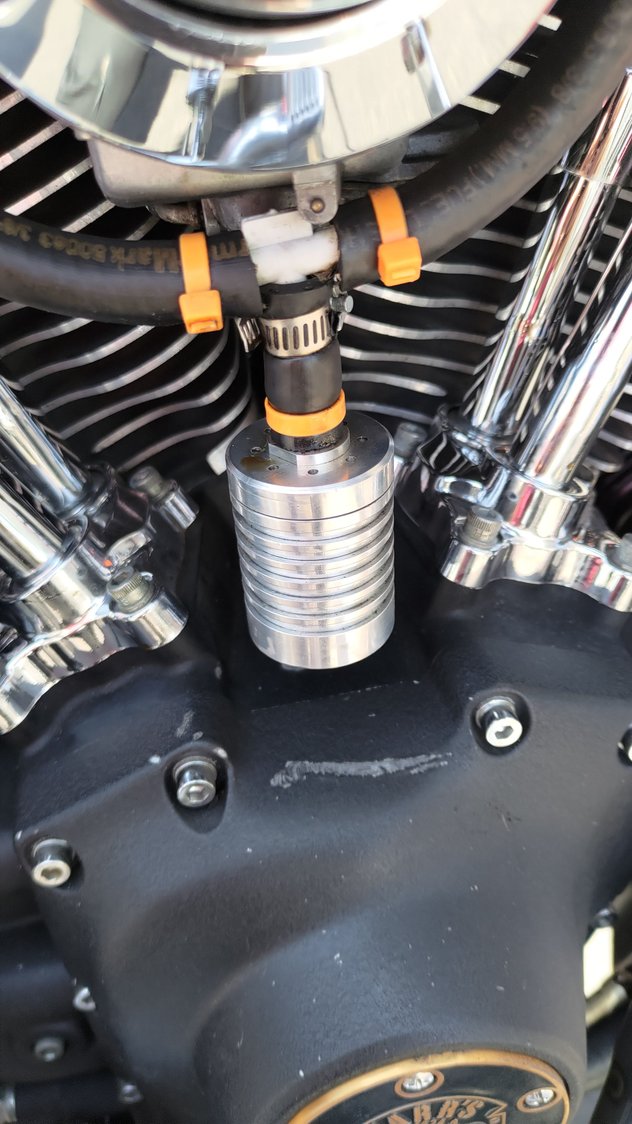

Took a ride down the hill to Riverside today. It was like 103f and that was about 2 hours each way.
Still spitting oil out the top of the catch can. Not nearly as much as before so the 60 weight oil definitely helped. The oil is filled properly and all that.
You can see in the pics the can doesn't have much oil in it and the filters aren't super saturated, not much oil in them at all actually.
You can see the oil mist on the exhaust pipe and the top of the can.
I'm wondering if I were to use a thicker/heavier foam filter inside the breather itself if that would help with stopping the areation of the oil and make it stay more inside the rocker box.
Or if I were to use heavier or more foam inside the catch can if that would help.
You did not picture the following foam and baffles...
If you are using the above foam and baffles and oil is making it all the way thru those and out the top, there is all together too much oil/pressure blowing thru there.
The only other thing that could be a problem is if the oil and pressure are exiting that threaded tube before it gets to the bottom of the catch-can. You can email a photo if you are not sure about it. (a photo of the threaded shaft that the oil travels down, to the bottom of the catch-can)

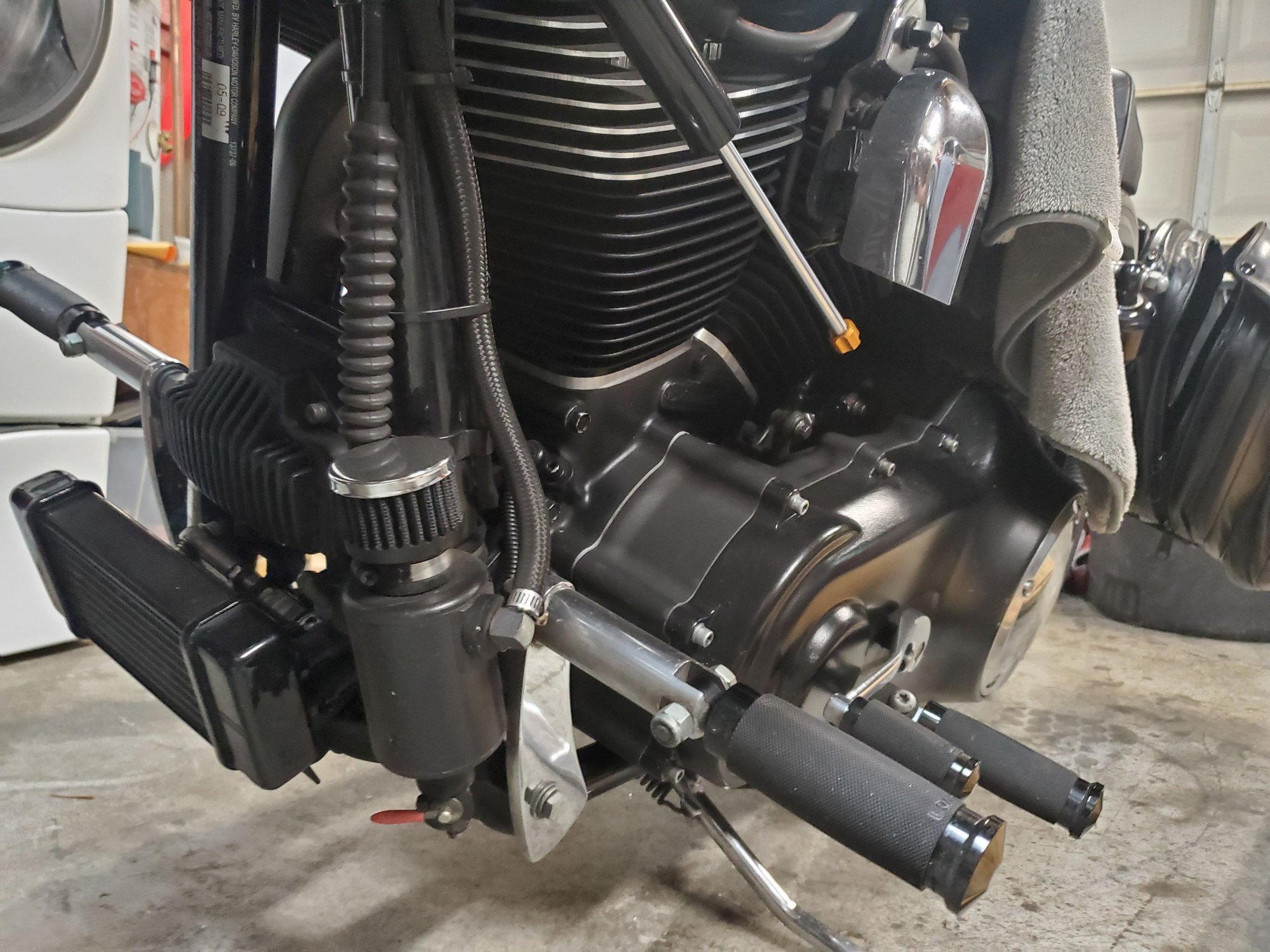

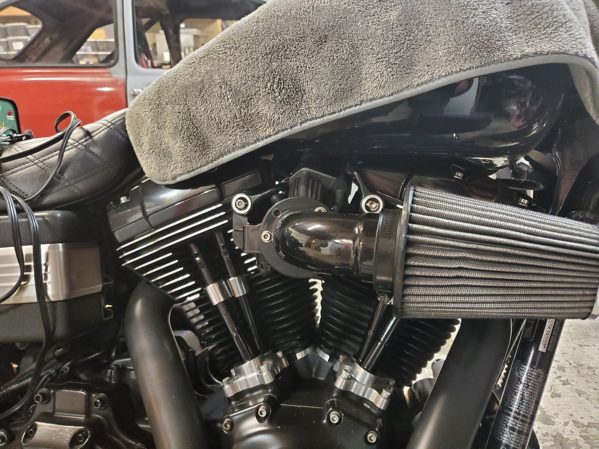

I've always been puzzled on why people run catch cans like this. Looks terrible. When I purchased my bike the dude had one of those filters instead of a can. Blew oil all over the pipe and my leg. Absolutely terrible. Granted yours should contain the oil and not spew all over the pipes. I run my bike hard, 100% of the time. My motor is built (stock bottom) and that dinky little catch can you're using would never work in my setup. Guaranteed i'd have the same issue.
My point being, might not be just the motor causing it (although it's likely it could be. Increase in crank case pressure = increase in blow by. i.e. rings or guides). Might be the way you ride. I did a custom catch can on my bike. Mounted to the frame down low, primary side on the down tube behind the front wheel. Heads connect to a T, then one long hose all the way down. Never leaks, does it jobs, and vents externally.
I like the look of it. however, the zip ties are a temp thing till i get around to making it a little more professional.
How about a pic of your breather setup? because I'm quite curious of your design.
Disregard the cracked/broken intake bracket. Runout by now is at or over .007 (was .0065 last I checked) on a stock bottom. Bike is shaking itself to death. Dogs on 3rd just broke so it's probably time for a full rebuild. 70k hard miles.
